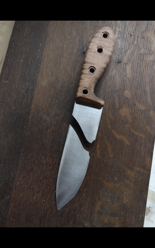

Yes Idaho.I am wondering if there were any coarser scratches left in the blades before they were heat treated? It's easy to miss a deep scratch in the steel if the scratch pattern is all in the same direction! A2 is air hardening steel, so it's not a super shocking quench like it would be in Parks 50 or Brine. Most go to .020" at the edge before HT, but others have gone with thinner bevels. I've had a lot of blades from Bos done over the years with no issues. It is the Bos/Paul Farner in Idaho at Buck Knives, correct? There is another BOS heat treating in Ohio?
Grinding bevels post HT is more to minimize warping and to remove any decarb that may occur. Many find hardened steel grinds more cleanly than softer steel and get better grinds post HT.

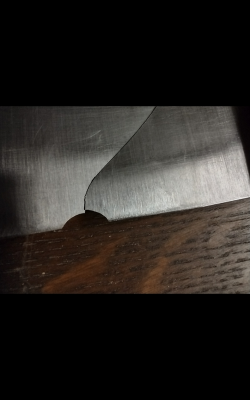

The deep scratch will have a sharper side to it and be more likely to cause a crack versus a dip which is more gradual. I wonder if the steel was overheated at all when cutting/grinding it, which can cause issues?
I use both JT and Bos with no issues with either. Bos was quicker and less expensive and can do longer blades up to 30+ for stainless blades. I started doing my own carbon steel heat treat lately after getting a kiln/PID and quench oil and tanks set up.
I'm confused on what actually happened to the blade? It snapped? What exactly snapped it?Before treatment I didn't concern myself with heat?
However, I free hand grind my blades. I do not wear gloves.
I'm positive I didn't overheat after heat treat...... And if I did, would that Not make them less like glass? Haha.
Pretty much the opposite of what I had.
Thanks for letting me know the depression wasn't likely a stress riser spot
Without going into it again too much......I'm confused on what actually happened to the blade? It snapped? What exactly snapped it?

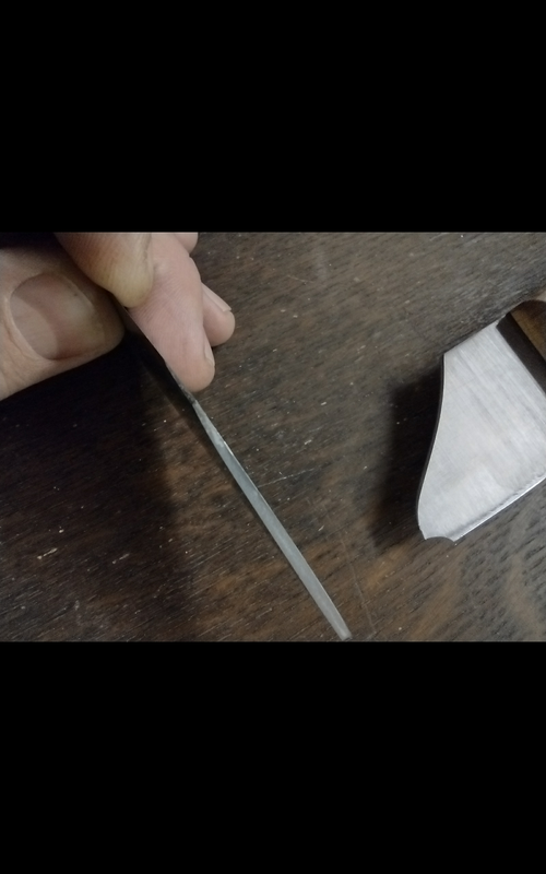

I've never filed a whole knife after heat treating.......but.What files do you recommend he use for cutting the bevels in hardened 1084?
