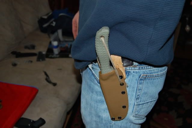

Fun with Kydex and my RC-6 **PIC HEAVY**
Hey guys - thank you all so much for the kind words - I appreciate it!!!
@hoopster - is that loop for IWB or just hanging on the belt?
It's actually called an IWB loop but the way I've been setting them up it's just for hanging OWB.
I'm sure it could be used IWB though.
