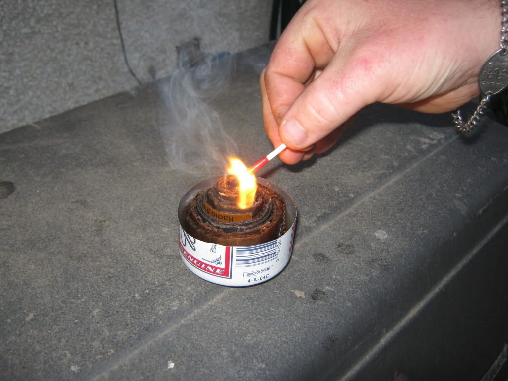

I decided to make some cool firestarters with my HEST tonight.

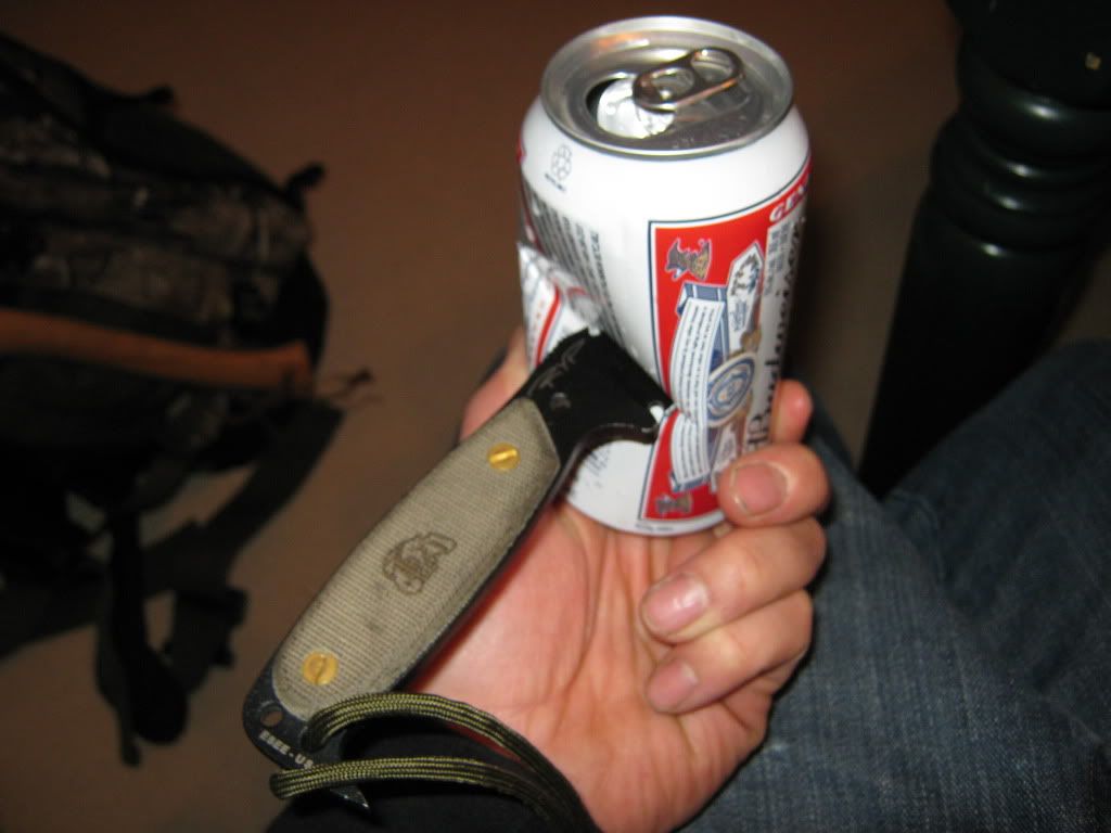

First off you cut a pop can ( in my case a beer can!) so that there is about an inch to and inch and a half of popcan left from the bottom.
The hest makes for a pretty rough cut, so clean it up with some scissors!

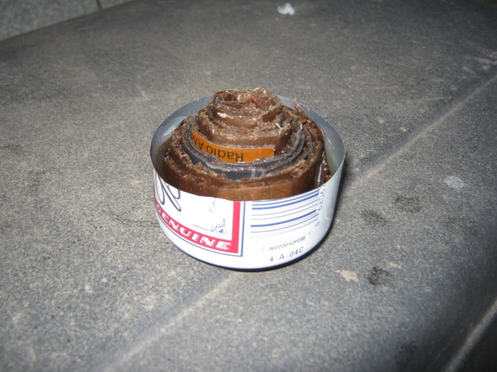

Then you roll up some cardboard, ( cut to fit) and stick it in the pop can....Boil some parafin wax and pour into the popcan/cardboard.

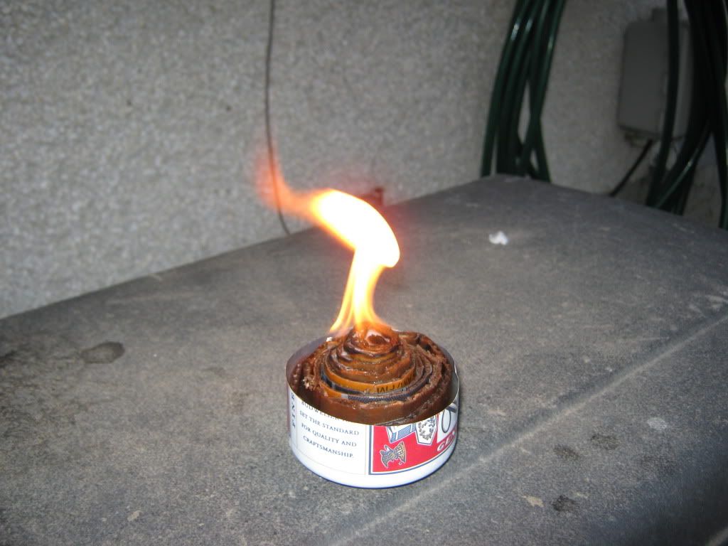

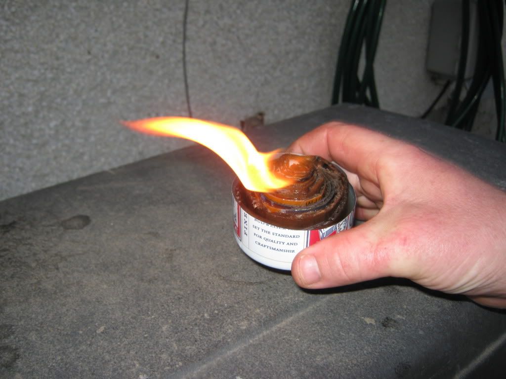

After it cools down, you can go ahead and light it! It burns like a candle!
Now, it burned for a total of exactly 1 hour 53 min...We put it inside of my barbecue and acheived 275 deg F. Impressive for one little firstarter.
Now that doesnt mean that every single firestarter like this anybody makes will burn the same or put out as much heat but it should be damn close...this is a totally effective wet weather firestarter that you can make at home with a few " pop cans"

I just melted the parafin until it was totally clear..soon after that it starts to smoke. Once the parafin has totally melted you are ready to go.
Let me suggest that you don't just boil it. Paraffin has a flash point and can burst into flames.
A quote from http://www.shamrockaffiliations.ws/Paraffin_Wax_Flash_Points.php
"Paraffin waxes ignite at the following temperatures:
•Paraffin wax without additives: 199°C (390°F).
•Paraffin wax with additives: 249°C (480°F)."
Instead, use a double boiler. This can be as simple as a can floating in the water of a larger can.
In other words, partially fill a can with water. Into this water float a smaller can into which you place the wax. Boil the water in the larger can, which in turn will heat the smaller can and melt the paraffin, but not allow it to surpass 212 degrees (boiling point of water).

Looks like the HEST came clean after the cut! My Izula had some battle scars on the coating after i tried a similar can.
There was minor scratching to the blade coating but not much..and thanks for clearing that up for me DOC!! Thats a cool idea about useing a double boiler!

We failed to light them with a firesteel, we used a match. On that note the next ones we make are going to have fatwood shavings sprinkled on top so they can catch a spark instead of direct flame.
The reason I call them firestarters is because they can burn for a very long time, allowing you to ignite damp wood more easily. Or if you are in a snowshelter you could lite 4 or 5 of them and be toasty warm.:D
