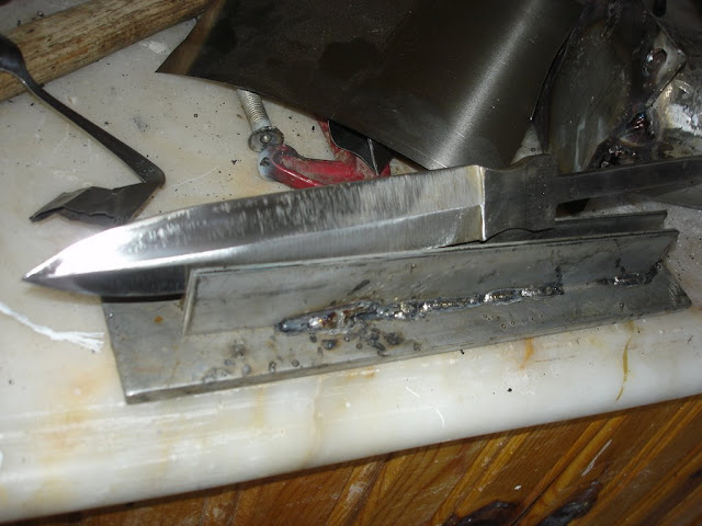

I usually HT one knife at a time, this keeps me from messing things up. For this purpose I welded 2 pieces of 1/8" SS pieces as sides, on top of 1/4" SS bar. It served me well about 20 knives and will serve maybe 200 more... If wanted one can weld as many side bars next to eachother for multiple knife HT's...
Emre
