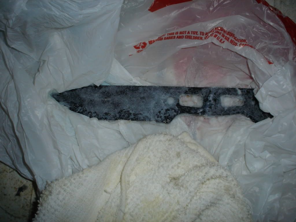

Sprayed it down with some Tal Strip II.
Worked pretty well just that the fumes were noxious I had to work fast at scraping the coating. Got most of it and used 600 grit sandpaper to work off parts I couldn't get to with the scrapper

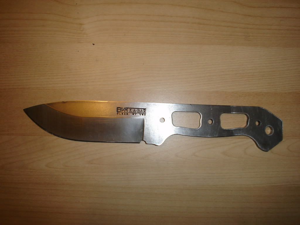

As you can see I still needed to sand it down a bit more near the handle

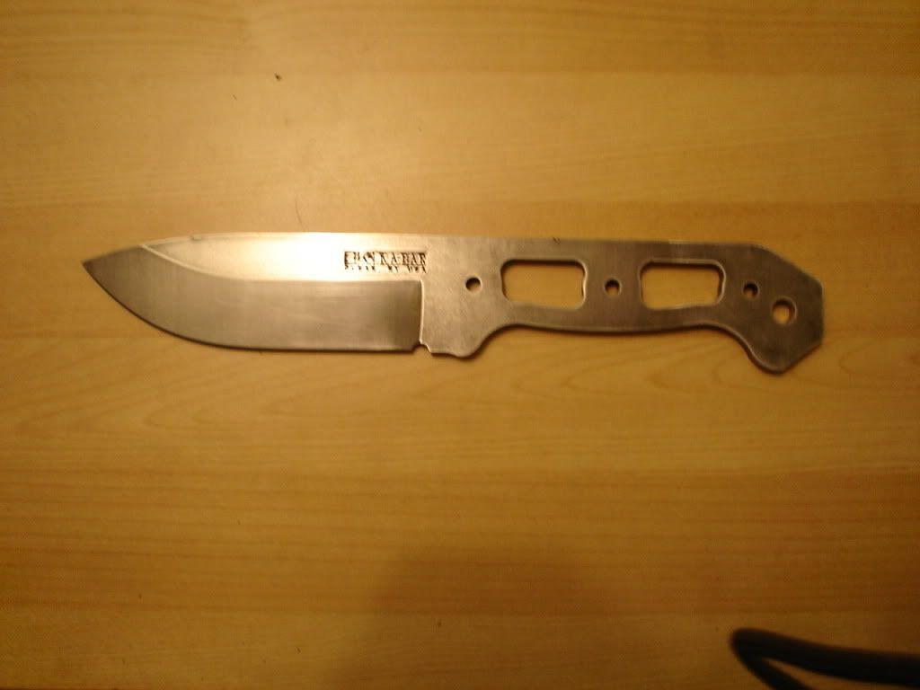

Working with 1500 grit sandpaper to polish it a bit and make it a bit smoother

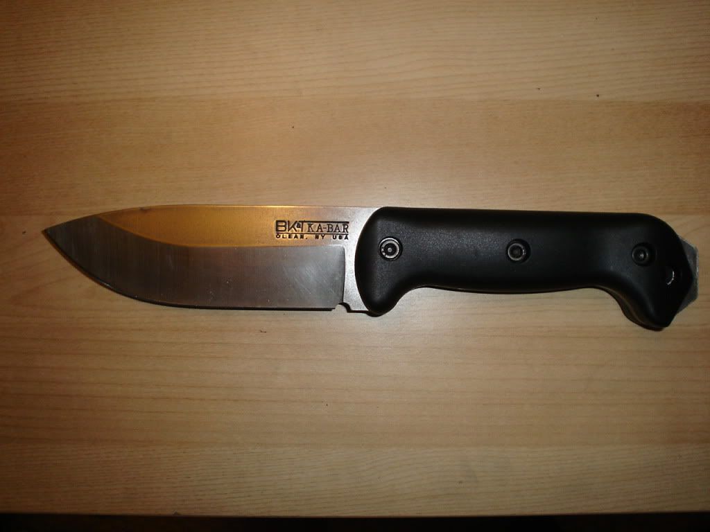

With scales and flash
No flash makes it look a bit nicer
Next I'll be polishing it with some Flitz. Anyone else have any suggestions to make it mirror polished? All hand sanding btw. Had to rest. Getting a little dizzy from all the fumes and sanding. Its a lovely 25 degrees here in VA

It looks nice. How long did you leave the stripper on it before you started scraping?
I leave it on for 15-30 minutes. 15 because I couldn't wait and I felt it was easier to scrape while it was still a little wet. But the fumes were noxious...got pretty dizzy because I was doing it inside ((Stupid)). But it was about 7 degrees out...
Here's an update. After speaking to a number of different people on the forum I decided to work on polishing up my blade a bit more. Thanks to those who contributed. Here are my updated results. :D
I'm going to hit it with some Flitz per edxamador's suggestion once I get it in I'll post another update. Thanks for the suggestions.
