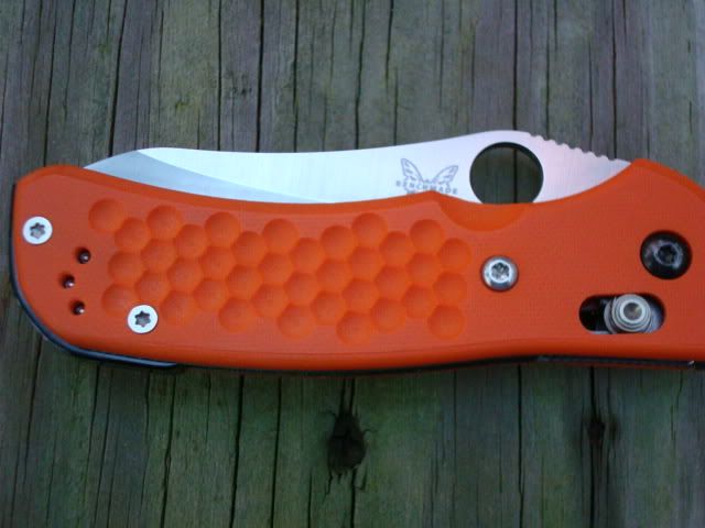

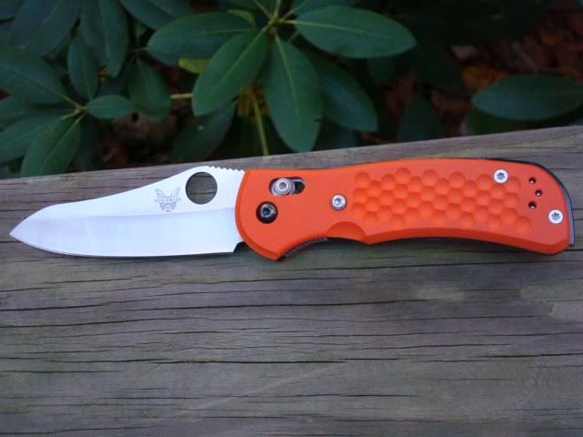

Man I do like the orange handles though!

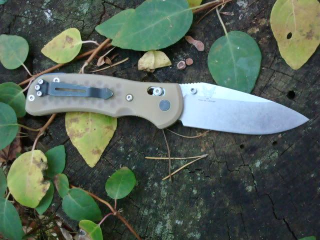

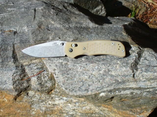

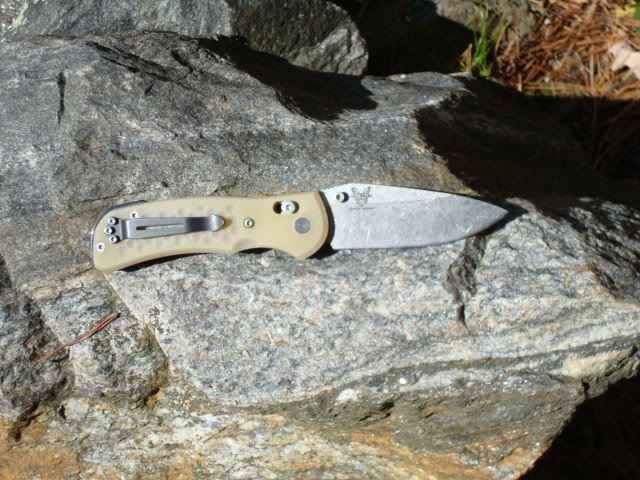

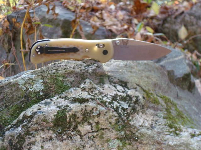

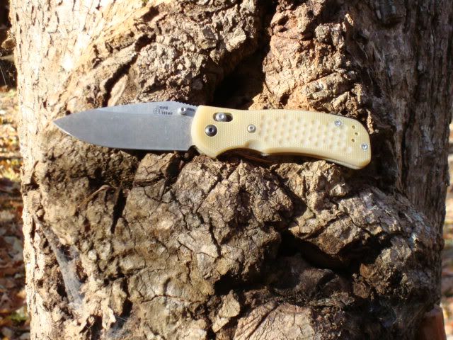

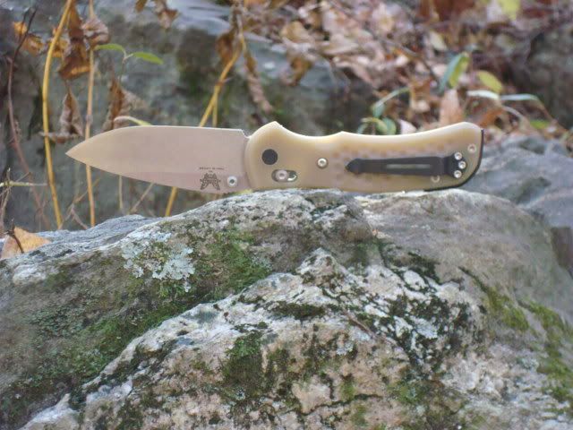

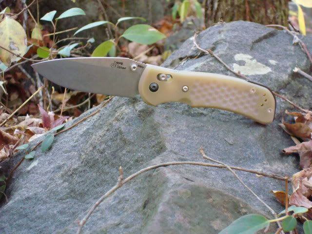

Here's some pics of my Griptilikins from a trip to the North Georgia mountains this weekend.
I personally really don't like the rough diamond knurlings of the Zytel Grip. Those G10's look sweet, 154CM is a premium steel, why not give it premium handles. Obviously most people buy grips for superb steels in a cheaper package, but if you are used to spending $200" on knives ain't nothing wrong with aftermarket G10. (they look THAT good too)
I personally hate Zytel and FRN.. Since getting my first knife with G-10 Ill never buy another non metallic handled knife without it.. If the Grip really is as good as everybody says then maybe its worth it to make it, dare I say "perfect"..
