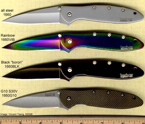

Family of Leeks -
Vintages -
Vincent
http://UnknownVT2006.cjb.net/
http://UnknownVT2005.cjb.net/
http://UnknownVT.cjb.net/
http://UnknownVincent.cjb.net/

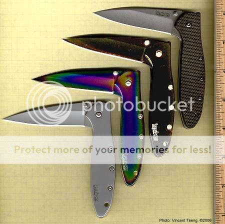

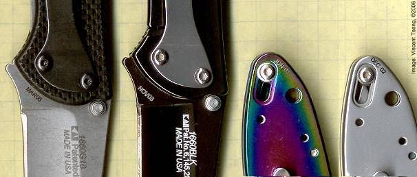

More differences and possibly why the later Leeks seem faster/stronger in their Speed-Safe assisted opening -
Position at limit of spring tension -
I got these positions by closing from fully open and felt for the point of just the start of spring resistance.....
The oldest 1660 all steel Leek - spring limit is with the blade at a shade less than 90deg.
The later black "boron" and G-10 Leeks have the spring limit with the blades at noticably more than 90deg.
However my "fastest" is the Rainbow Leek where the limit is only just past 90deg - so the speed here may have more to do with the lower frictional nature of the Ti-oxide rainbow coating?
Vincent

Thanks for the input G2 -
yes, I was kind of surprised at the more obtuse edge on the textured G10 S30V Leek - it was noticably less acute than the older 440A Leeks, enough that I commented on it and ad-hoc casual cardboard cutting showed it definitely did not cut as well as the 440A Leeks.
One would have thought that with a more premium steel like S30V with its reputed better edge holding - Kershaw would have put a more acute edge on the blade - and now almost 2 years on.
The limited run polished G10 S30V Leek had a more typical Kershaw acute edge.
