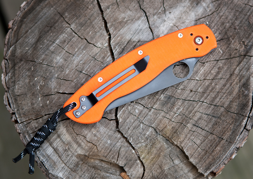

so I finally found time to make new G-10 scales for ti-Mili ,
it really made knife lighter
what you think ?
Me personally, I think you're wicked! Wicked, wicked, wicked good at making a beautiful mod to the Millie! Your work is outstanding! :thumbup:

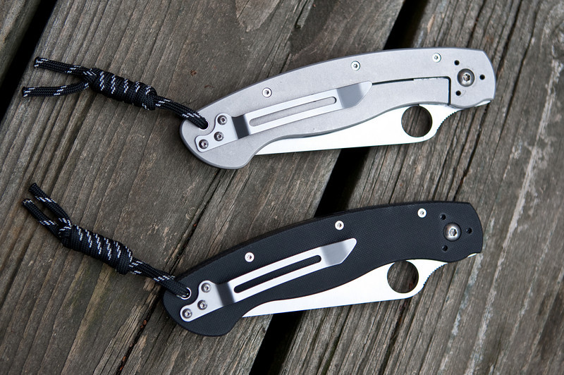

ok , here is two with clip reversed, finally lanyard has a reason to be on Mili.
Wow. Very, very nice. I'd even buy a Ti Mili if I could get one with a G-10 scale and a clip like that. Very professional looking work there. Well done.
-Tye
AWESOME CLIP!!!!! Spyderco needs to seek you council. If only iot were a low riding clip!
Great job my friend.

I just got my knife back from trix2004, and wow! I like the G10 scale on it now a lot more than the Ti scale. Plus, it is finally converted to tip up! :D
If you are on the fence about having trix do a conversion for you, don't be! Go for it.
I'll be sending you my G10/Ti CPM M4 Military to swap to tip up and possible, another colorful scale.
