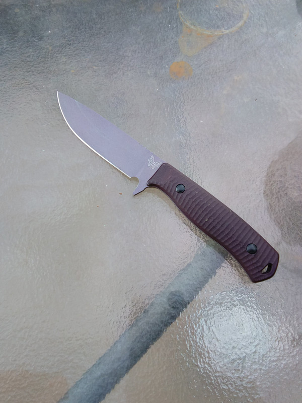

Meh. If you believe the interwebs, the Earth is flat and Neil Armstrong landed in Burbank. Rit Dye More works nicely on G10. I've done a few knives using the color "Racing Red." One of my FRN's came out a little darker than your Matriarch. An FRCP came out a little lighter. That one has a LOT of miles on it, and the color has faded in the high-wear points. It makes it look faded and cool. I have a Manix 2 XL with Jade G10 scales. It came out looking VERY Burgundy. Or maybe a little more like Cabernet Franc. Regardless, it's a dark red wine, and it looks great. I can't upload pics here, so you'll have to take my word for it.
All dyed micarta…
