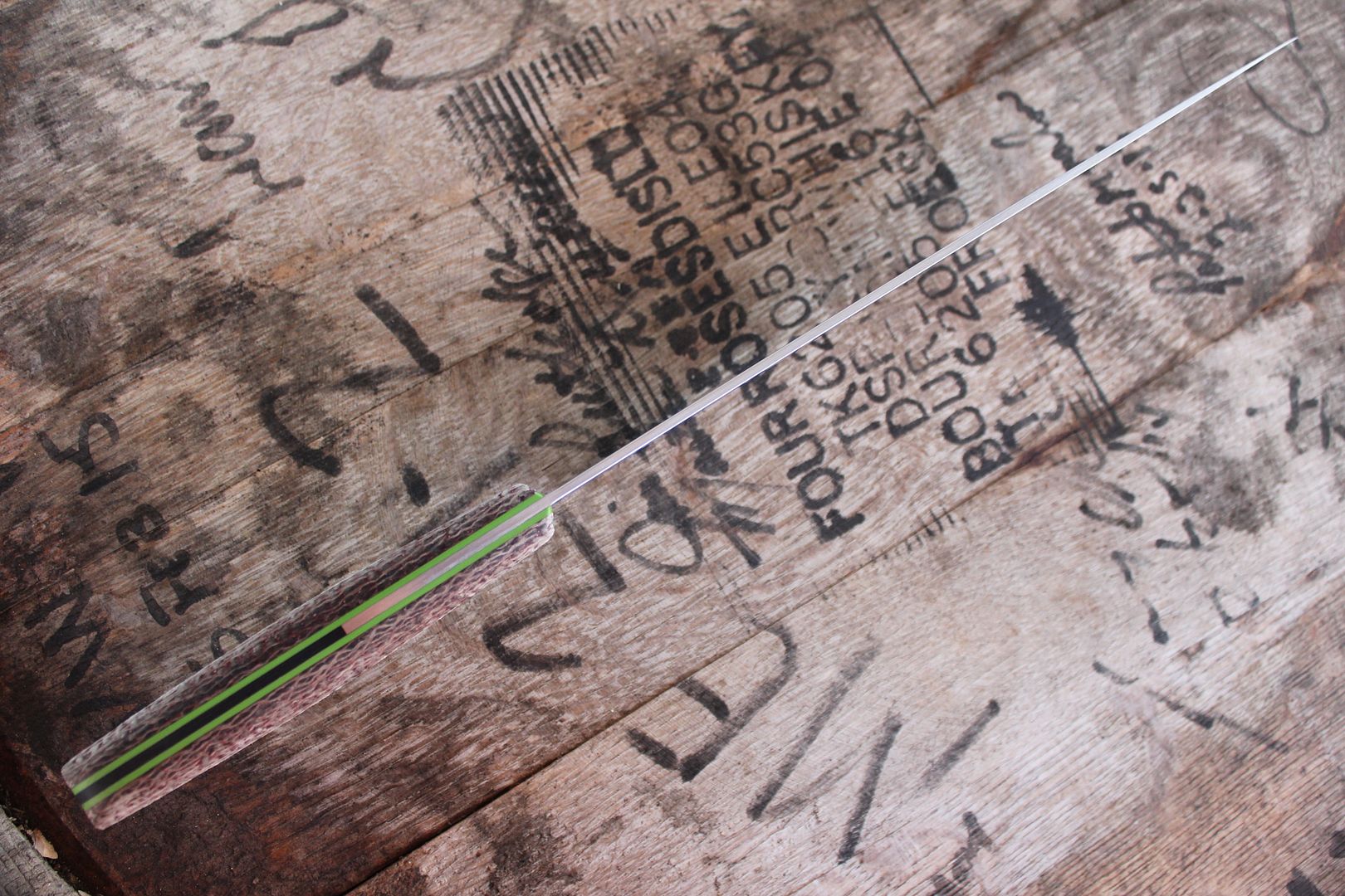

That is 1/16" Toxic liners under Drunken Coffee Bag with a 3/32" Black spacer finishing off the tang.
