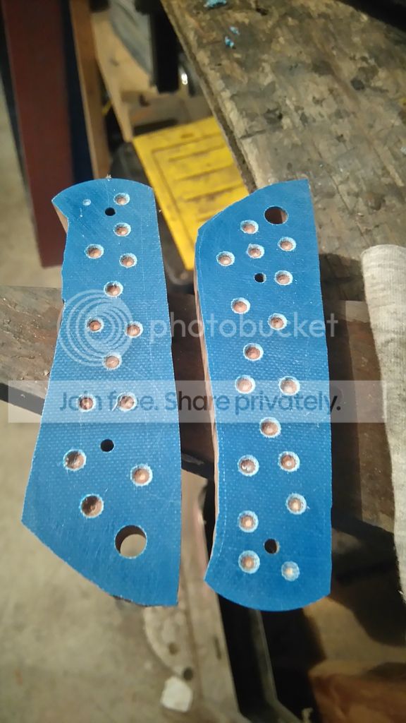

I do the same as Frank with the CA glue. I then use epoxy to secure the scale to the knife. I make a bunch of divots in the g10 that go through to the wood. This gives the epoxy more to grab onto.
Thanks Shane - I like the way that is done. I'll start using that technique for liners. It will make liner 'n scales just like scale only... I LIKE IT!! :):thumbup:
Ken H>
Thanks, Shane. Those holes are sure to give a good bond for both scale to knife and liner to scale. Thanks to all for your help.
