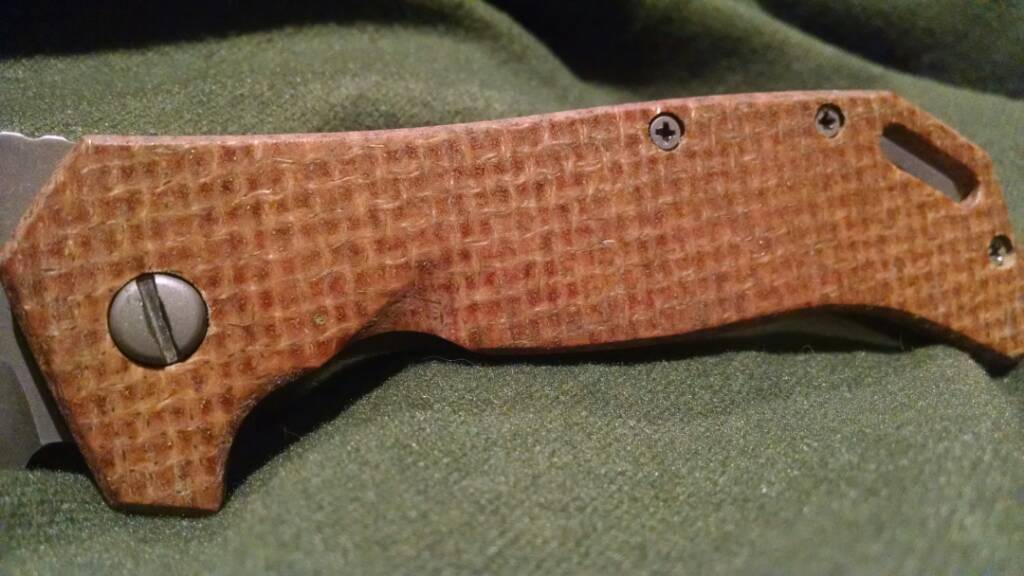

Burlap Micarta LS (a little lightening strike mixed in).
A W.I.P. that I am struggling with finishing. Just not very motivated with this project any more :-(
