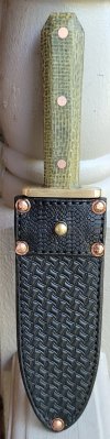

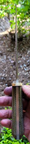

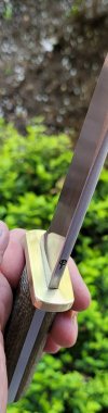

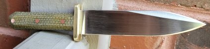

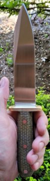

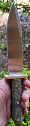

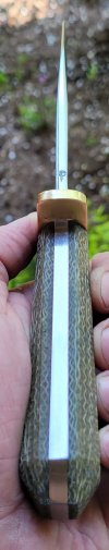

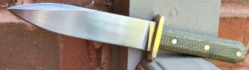

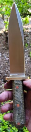

Good Afternoon,
This is a new one I have been working on in between orders. It is inspired by the Michael Price knives from the 1850s. The first 1 5/8" of the 3 1/2" clip is sharpened and the handle is full tang construction with a soldered guard.
This blade is made from 0.211" Magnacut hand sanded to 400 grit for a satin finish.
The handle is fibermascus copper and brass and is ground in a coffin style.
The weight is 6 ounces and the balance point is right at the guard.
The sheath is made from 7-8 ounce leather and is ambidextrous. I tried something new this time and made the bottom portion of the belt loop frog out of kydex. I was able to get it shaped so that the stud on the front of the sheath snaps in very securely but can still be removed.
Price SOLD, shipping is included to continental United States via USPS.
Blade Steel: 0.211" Magnacut
Grind: Full Flat
Blade: 5 15/16" Tip to the front of the guard
Handle Material: Fibermascus copper and brass
Overall Length: 10 1/4"
Sheath: 7-8 ounce leather
If you would like additional pictures or have questions please contact me at cpeknives@gmail.com
Comments are welcome thank you for looking,
Paul
