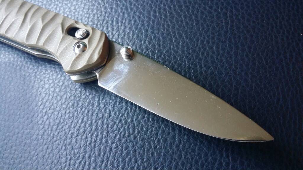

It all depends on the grind.
I quite like the Ganzo construction but I can't stand their grinds.
But if you give it a regrind to thin it behind the edge sharpening becomes a breeze.
I have that very same model, but in orange (mine is V2, with solid steel pins). That's a great regrind! Looks like a laser now. I am not that talented so I will leave my Ganzo blade as is.
However I am not shy with power tools... and another thing I will do to that very same knife is to remove as much metal as possible from the solid liners. I am planning to drill a few holes to get me started and then use a die grinder with a carbide bit to hog out most of the metal. Finishing with some files and sandpaper. The knife has a great size (not too big) but it is quite heavy. Also much heavier than my Spyderco Military, which has a much bigger blade!
Yeah, making the thick liners lose some weight is somewhere on the schedule for me too.
And yes, it'll cut like a demon now.
I think at some point I might try my hand at making new scales too. But for now this'll do.
