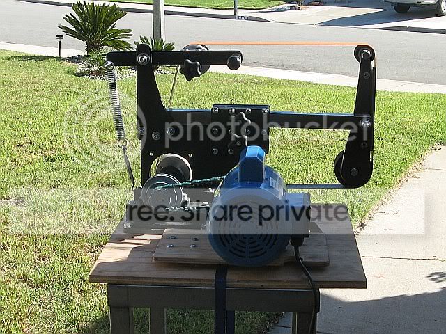

I open the garage door and wheel out my grinder. I grind under the garage door and have plenty of ventilation. Just put a matt and bucket under the grinder to catch all the dust :)
