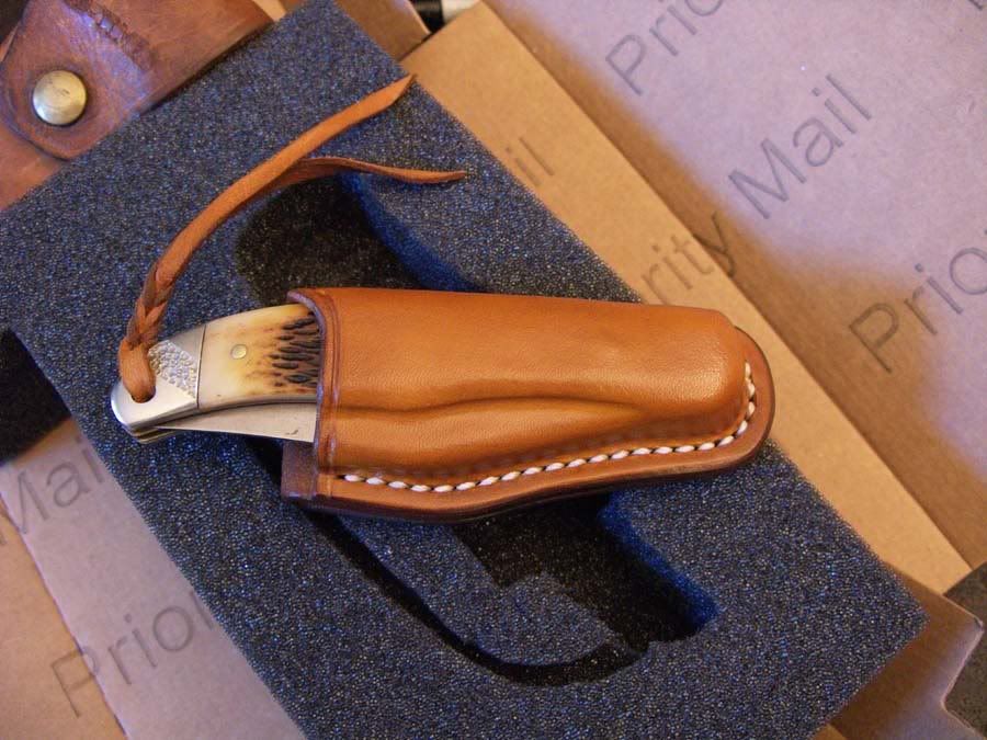

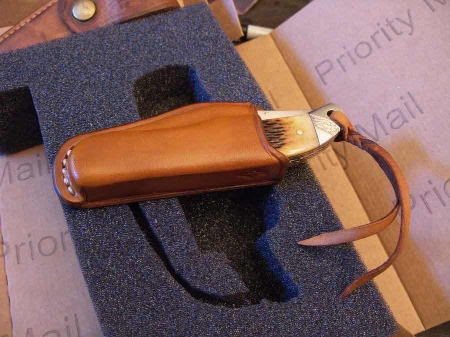

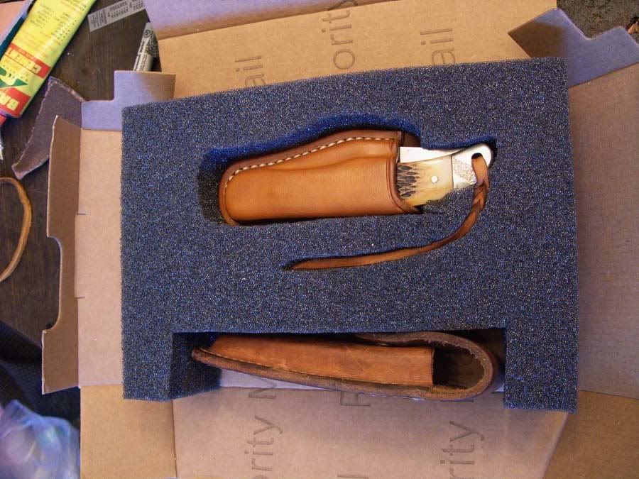

Hi all,
I wanted to share my new sheath for my old Pickled Schrade hunter.
I hope you like!
Gary is a standup guy and I couldn't be happier!!
Thanks Gary,
Brett

Thanks nikoknife48, the leather doesn't want to go that way, so you
have to keep forcing it to take on that shape, over a period of several
hours while it's drying, about every half hour I'll put the knife back under
the leather and shape it again, pressing very HARD to stretch the leather
into that shape, ending up with a formed sheath that will help to retain
the knife for a long time. Then I dye the sheath, emboss if needed and
glue it down to the back side and hand stitch her up.
