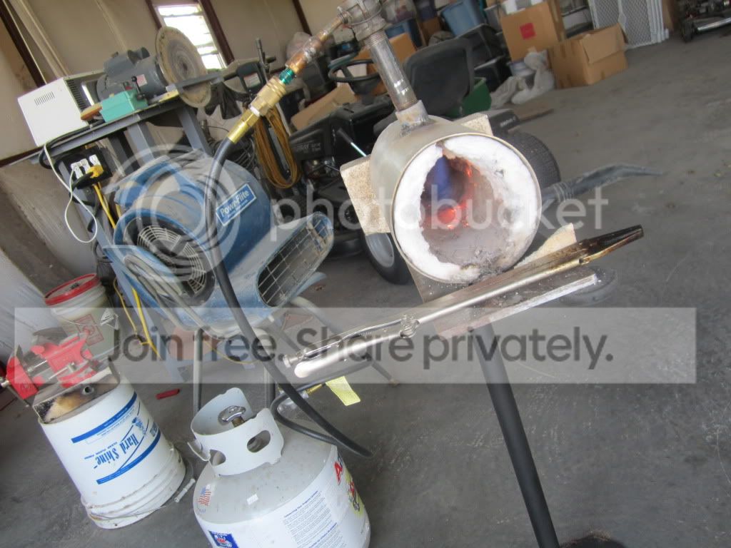

My friend built this forge for me.I was a little afraid of the fire/gas stuff also,but its actually quite simple and safe.The body on mine is stainless pipe he picked up at work as salvage.The secret to this thing is the adjustable regulator.It sounds like a jet engine and gets a 3/16" thick 8" blade orange red in a couple of minutes.I usually pick it up(the blade) and move it around under the hot blow to get it evenly colored and hot near the end.Sometimes i lay that firebrick chip inside just to make it easy to pick up.It adjusts in height and has space front and back for firebricks.I love this thing.Other than the s.s. cylinder all the parts were from Lowes and the reg. from tractor supply.I traded for it,but he said he'd build one for $300. like mine or similar.

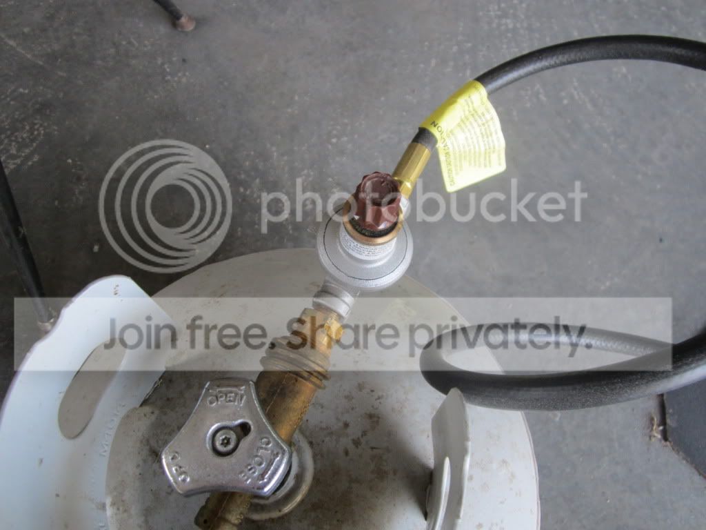

Coat that thing! All of the interior and the exposed edges. The forge will work more efficiently be tougher and last longer...your lungs/health have already been mentioned. The additional coating of ITC100 or similar (on top of the satanite) will usually also improve forge efficiency, however the large size of your opening may negate that benefit. Also install a quick cut-off valve 1/4 turn ball valve rated for gas between your regulator and the Lp tank. You do not want to be fiddling around with a multiturn valve if something goes wrong! Also, you will get much more control if you add a needle valve after the regulator. Yes, they are two different things and it does make a difference.

In the Photo I see the propane bottle sitting next to the forge. I strongly advise against this practice, almost cost me my shop and maybe my life.
The bottle goes outside, lines to the forge should be as far from anything hot as you can keep them.
