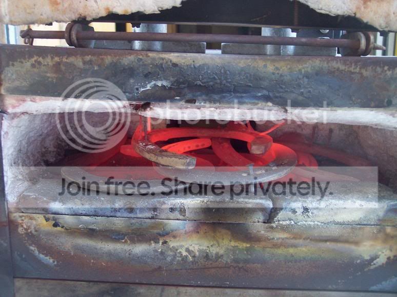

Here is a pic of just horseshoes inside an NC Whisper-Momma , back-door forge.
Just a note, the left (as your looking at it) burner is jetted smaller, to be hotter at altitude, the right is hotter as shown at 5280' .
The pic is not that good, but shows the color of the shoes under the burners.
Just included this as I think it helps me understand my own forge and gives me more options banging blades.
