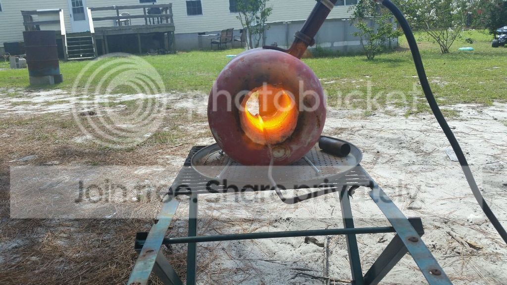

I made mine, still really a work in progress. Cost me about $60, the helium tank was left over from my daughter's birthday party, the refractory is cheap kitty litter ($4), diatemecous earth and perlite, which I already had for pool filters and gardening and such. The burner is a frosty style tee burner. Local hardware had those pieces parts.
I don't have a good pics of the burner bit diagrams for frosty burner are all over

That's a sweet little forge your building and at a good price. What's it's inside dimensions?

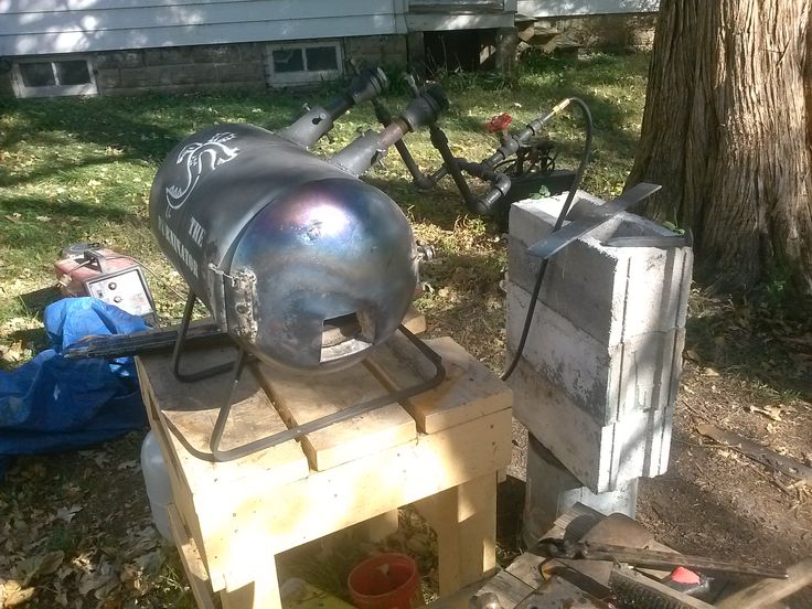

Im by no means an expert on forges but by building mu own i learned quite a bit. I used a 30# propane tank as the body, cut a hole as the main working port, cut 2 holes for burners. I can't remember the specifics on how i made the burners but it wasn't terribly complicated. Lots of online material explaining exactly how to do it. The valves and connecting pipes were pretty easy to assemble. I cut and welded 2 angled pieces with 4 set screws each so I could remove the burners if I need to. They were angled so the gasses would circulate within the forge. I attached a valve to each burner so i can turn them on/off individually. Then cut a piece of inswool i can roll up and shove in the back to reduce internal volume. I used 2 inch inswool and a satanite coating with a fire brick floor. Whole thing ran about 300 bucks and was pretty fun to make.
The bottom of another propane tank with a working port cut, lined with inswool, and attached with a modified hinge and it had a door.
