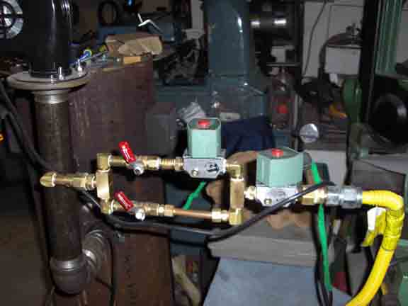

Your top post is exactly what I am using on my forge that you used during your visit to my shop. Here's a pic of the solenoids -->
I paid $35 for two of them. Currently in West Plains, MO. on business travel but will get you info regarding where I purchased them from when back at home this weekend.

Eric,
I like the primary line solenoid in your setup.:thumbup: It allows the gas supply to be turned on and off with a switch instead of a manual valve. Also, you have a very clean and neat setup for the by-pass line. The only thing I would suggest is replacing the ball valves with needle valves, since they will make adjusting the burner a little easier.

Hello Stacy,
My original setup had needle valves. I had to replace them with ball valves when I switched from propane to residential pressure natural gas. The needle valves were just too restrictive for pressure under 1 PSI and would not work at all. BTW... I am really happy with this setup. It's really nice to never worry about filling tanks or having one run out in the middle of a project. :D

I thought you had the schematic for my controller? A brief overview and explanation is:
The plans/schematic for the burner control system I designed is called a two-stage burner, because the burner cycles from high flame to low flame, and never goes out.
If you look at Eric's photo, you see the parallel paths the gas can take. After the gas goes through the first gas solenoid with the main supply attached ( you don't need this) the gas can go through a direct path with only a needle valve (he used ball valves) to control the flow. This is the LOW stage. It sets the lower limit of the forge, usually about 100F below the desired temp.
The other path (upper in his photo) has a gas solenoid that is actuated by the PID. It turns the gas on when more heat is needed. It has a needle valve to set a high limit. By using controls on the blower, the flame can be controlled to a perfect atmosphere all the time. Temperature control can be +/- 1-2 degrees if desired.
Hello Stacy, You are absolutely correct in your statement above that you do not need the first solenoid in my pictured setup above to have the forge work and be controlled properly. My first setup only had one solenoid. I had an event happen that scared the shit out of me and made me add the second solenoid on the incoming gas feed. While using my forge, I had the power go out. :eek::eek::eek: In a split second there were flames coming out of my blower... Since the power failed, the lower stage of my contol unit kept feeding gas, the blower stopped so the gas took the path of least resistance, UP. A quick twist of the lower stage valve shut off the flames and that was that. I was right next to it when it happened so all was taken care of very quickly. Had I been across the shop it might have been a different story. Now with a solenoid placed right where the gas comes in, should the power fail, ALL gas is shut off. Having that solenoid on the front end of my gas supply gives me peace of mind and helps keep my shorts clean. :cool:
