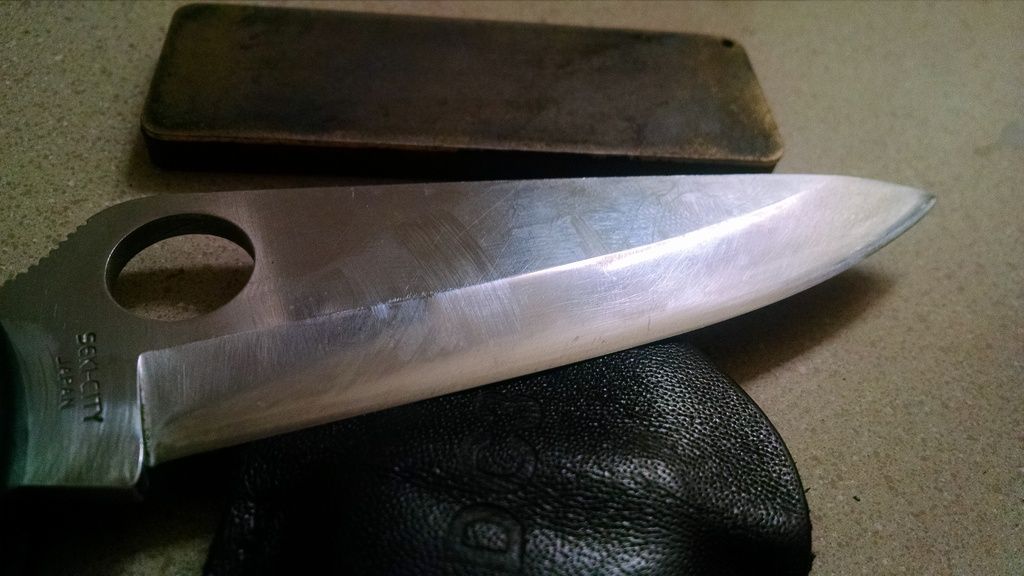

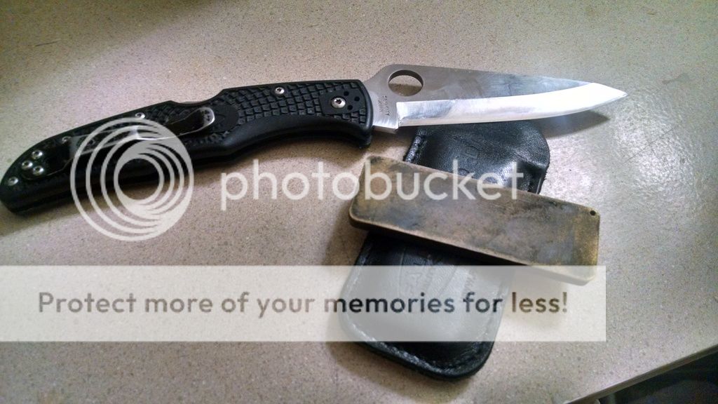

I inadvertantly started a ruckus here the other day by saying i was happy with the quick and dirty sharpening job a Meyerco pull through sharpener does on my old, beat up Endura 4 work knife.
You would have thought i was committing a crime by using a pull through. I put up pictures but i can't find them for some reason. Did a blade lover sabotage me? I'm only half kidding.
Anyway, i broke out the Gatco kit today and spent a little more than 8 minutes (i know this is no tlme at all to some of you to sharpen a blade) sharpening the Endura using two stones. That's 16 times more time than a quickie sharpening takes with the Meyerco.
The Gatco job LOOKS a hell of a lot better but i swear it doesn't seem to cut better. Remember, this is a working knife and i don't separate molecules into their smaller components at work.
[/IMG]
[/IMG]

Medium and fine Gatco hones dressed w/ a very slight amout of honing oil.
No burrs formed this time. I did it fast, real fast. And yes, there is reflection so no true apex, not as sharp as it could be. But sharp enough for what i need.
Quick cardboard strop.
30 deg.
the knife is used to cut cardboard, cement bags, rope, heavy fence cover sheeting and boxes that are enclosed by thick plastic straps which have four thin metal wires imbedded inside the straps. We used to joke about getting some jaws of life for the straps.

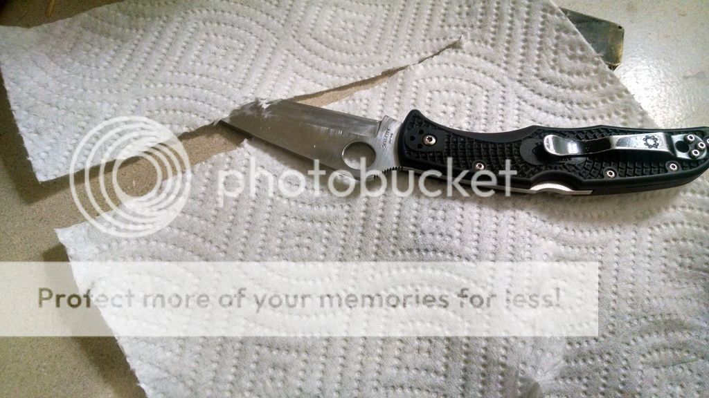

After "stropping" the blade on my jeans (really cleaning, not stropping : ) ), i cut sandwiches and slice cantaloupes, apples oranges etc. at lunch and on breaks.
With no burr formed, the knife wasn't truly sharp. Instead of returning to the pull-through, I would suggest this: Sharpen it to a burr and finish sharpening. Also, make a note of the angle and where it was placed in the clamp. You can return to this setting or, for quick touch-ups, go to the next higher setting on the GATCO. I believe you'll get better results that will make the initial sharpening time worthwhile.
Medium and fine hones
No burrs with it this time. And yes, there is reflection so no true apex, i guess.
25 deg.
the knife is used to cut cardboard, cement bags, rope and a lot of boxes that are enclosed by thick plastic straps which have thin metal wire imbedded in the straps.
update: 30 deg.
Is that 30 degree setting on the gatco? As in 30 degrees per side?
:) Well there's your problem :D
If you haven't apexed in 8 minutes,
using gatco medium or 220-grit (many peoples coarse)
after some 480 strokes (assuming a slow rate of 1 per second *60seconds*8min),
with a really obtuse angle of 2530 degrees per side (5060 degrees inclusive),
you need a much coarser stone
and need to use more force, like 2-3lb for starters (not advisable for diamonds and other fragile stones)
The blade looks really thick in the picture, and at 2530 degrees per side, that is really thick, its time for a regrind/reprofile,
you should take your coarsest stone,
and maybe an hour,
and get that down to 10-15 degrees per side,
you know, make it a knife again :)
see optimum knife edge angles and what they should be able to do/slice/chop
Only the regrind is slow, after that, regular full sharpening is 10 minutes tops (2 min if everything clicks),
but you can always do high angle/microbevel/ten second touch ups on the stone or with the meyerco in between

The thing is sometimes, depending on what's happening at work, the blade gets dull and when i start to have get too strong with the blade i know it's bad for the blade to say nothing of potentially dangerous.
I have neither the time nor the inclination to use the gatco kit on the job. A few light strokes on the mayerco pull through and i"m back in business.
I can just see me using the gatco kit at work and a general contractor asking a foreman, "what the hell is that guy doing?"
The meyerco fits in my pocket and takes about 30 seconds, maybe less, to give me a working edge.
I mean i know the gatco, with proper time and effort is far and away the better sharpener, no question about it. But sometimes it's use just isn't feasible timewise.
