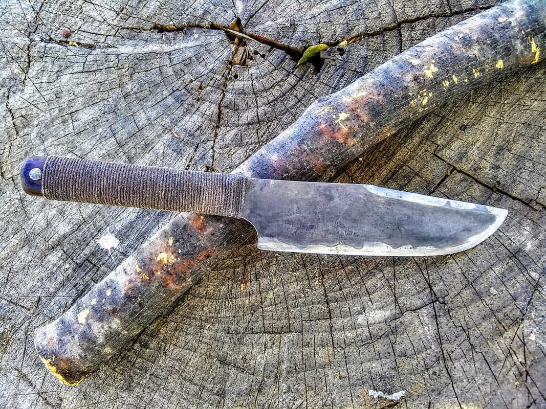

I never intended it this way, but I think this might actually fit the bill of a gaucho knife and it was actually made from an old chef's knife of sorts ( GI cooks knife )
I have somewhere in storage an old Sabatier. Your knife gives me ideas. I would like to try a cord wrap made of two different color cords spun around each other.

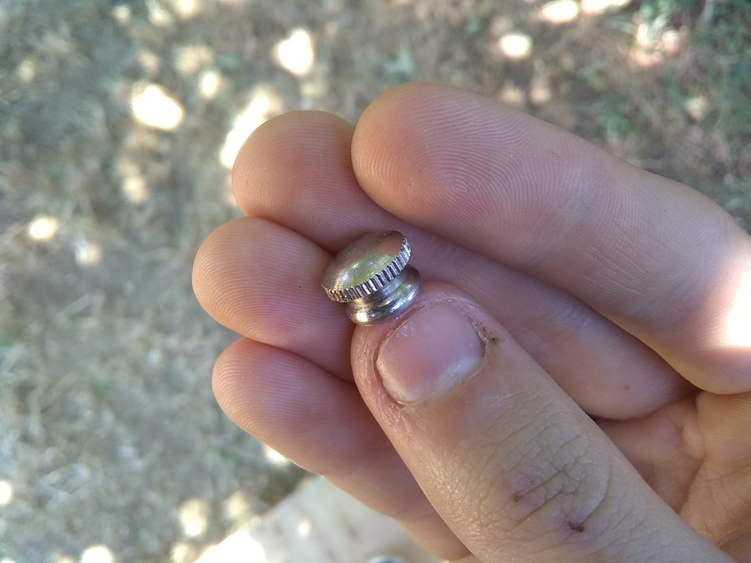

Here's the little threaded knob I used for the stud on it's sheath.
No clue where you'd get one though as I found it in my bucket-o-stuff, but if I had one I'd imagine a hardware store might have something.
There are all kinds of small knobs in hardware store and more available in webshops. I had in mind a brass or steel cabinet knob, patinated to dark antique finish.
