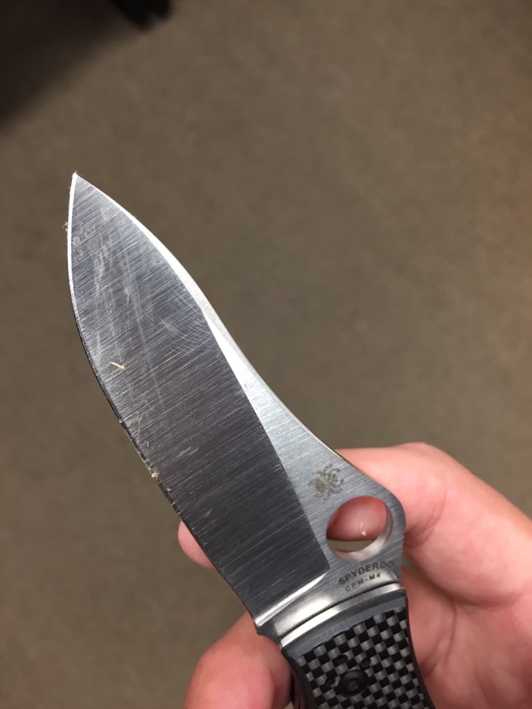

Chris "Anagarika";16327475 said:Thanks.
Luong thinned it down by grinding flat, and then sharpened at a bit higher angle. He graciously let me have it, and I added microbevel (not so micro anymore) that is set following my user hand free edge bevel angle (25-30 inclusive). So now it's sort of thinned convex (free hand wobble convex).
I need patina to reduce pitting by my sweat (bad bad sweat chemistry).
Member Marthinus tried the same flat thinning down and experience chipping (it's on previous page of this thread, IIRC).

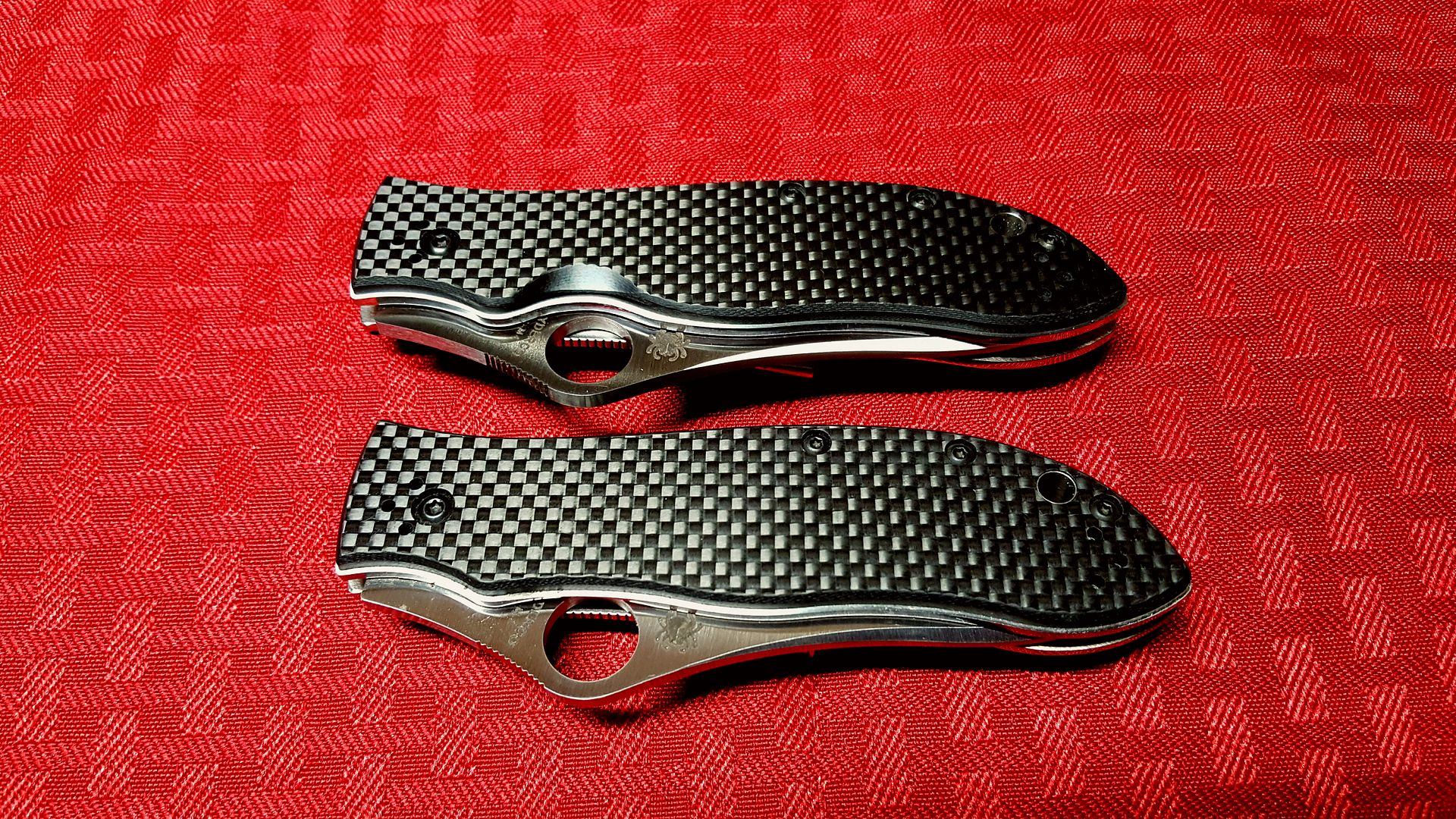

3) liner lock is kinda difficult to disengage. My thumb is tore up from opening and closing it about 25 times.
However, after playing with my unmodified GB (and abusing my thumb) I finally realized that I was trying push the lock over by jamming the side of my thumb in that small space. I started putting the center of my thumb pad on the lock bar and using slight downward pressure while moving the lock bar to the side. I find that works much better and no longer have any issues unlocking the knife.
Haha I've been there. I have one that a previous owner had modified to have better access to the lock and Spydie hole. It's way easier to disengage the lock. However, after playing with my unmodified GB (and abusing my thumb) I finally realized that I was trying push the lock over by jamming the side of my thumb in that small space. I started putting the center of my thumb pad on the lock bar and using slight downward pressure while moving the lock bar to the side. I find that works much better and no longer have any issues unlocking the knife. The modified knife is still more user friendly but I no longer find it as attractive as I did originally.
