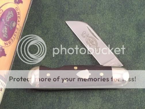

Thanks for all the input. KnifeSwapper that picture I posted is from your site where I will be buying the knife and I apologize if I shouldn't have posted it without asking. I wasn't aware you are a member here.

Ok so here is the one I just pulled the trigger on.
Photo courtesy of KnifeSwapper's site where I ordered it.
440c blade and dark zebra wood. I'll let you guys know when I get it.
Thanks again everyone.
