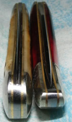

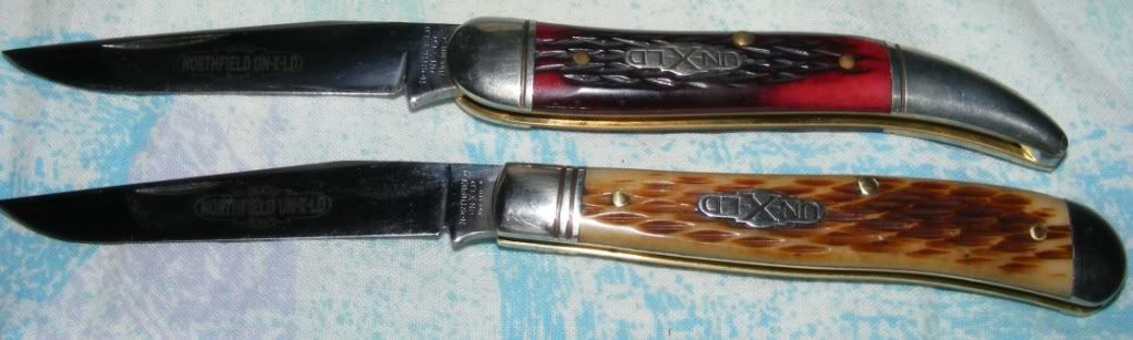

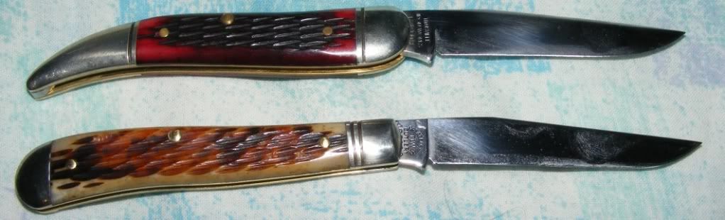

Toothpick feels way beefier. I never realized how much thicker saberground toothpicks blade was till I compeared it to #48 flatground. Difference is huge. Also, my new #48 is mean slicer.
Shape is good and dang its light. I can barely feel it on my hand when using, but not in pocket. the slimness makes knife disapear even its considerably longer than Case swayback jack, GEC # 61 congress or GEC #25 jack knife I've been carried.
I sharpened my toothpick (took me about 15 mins to get it enough sharp for my like) and it slices paper and everything really nice and cuts hair off your arm but #48, I simply few times used fine ceramic rods and 30 seconds and #48 pops thair off my back without effort. Blade geometry saber vs. fullflat prooves that flat ground makes better slicer but most of us already knew that.

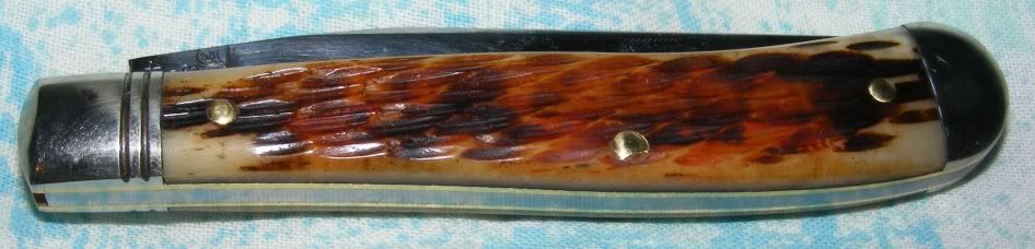

Why this knife was EDC was due mismatching panels, which I think just gives a nice character, at least in my humble opinion:
Thanks for sharing your thoughts Jani. I especially appreciate the side-by-side pictures as I have been considering these same two models.

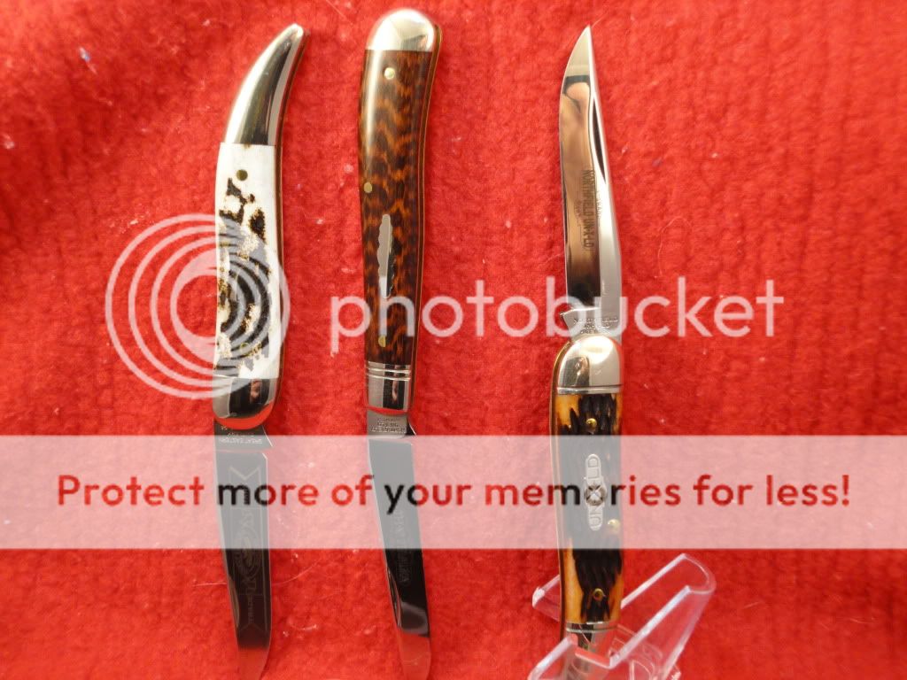

i have several of both patterns [may post pics later] the tooth is slightly heavier construction & would do tuffer work. the slim trapper is a petite beauty that begs to be in your pocket. although the trap is a demon slicer it requires a little discretion in usage. i would'nt use on anything larger than trout & squirrels in the boonies. [rabbits also] but on cardboard & ENVELOPES THE TRAP HAS NO PEER.

Excellent comparison picture of the two blade grinds. It's a more significant difference than I would have thought. The walnut looks good and for the EDC designation their lack of matching is certainly not a problem. Nice to hear that yours came pretty sharp and didn't need much edge work. That model is a real pleasure to carry and use. Take it from me, I'm a doctor. Or something like that. ;)

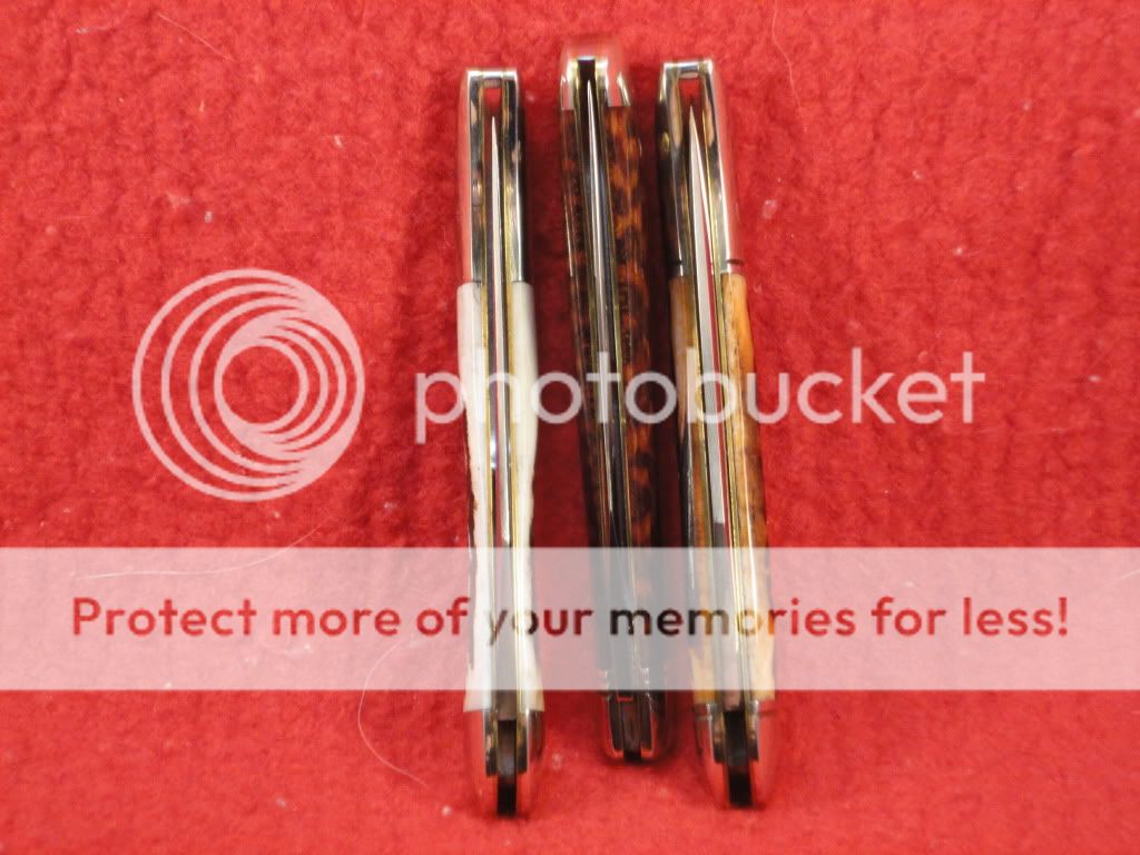

elk tooth---snake trap---& antique orange saber tooth
the elk is 440c, here are some semi-accurate numbers.about 1/3 in. from handle the thickness was:elk,88/1000--snake'80/1000-- & antique orange ,108/1000. the lenghts on tooth blade ,2 & 15/16. trap was 3 & 1/16. these are shaky old hand measurements but give menbers some dimension differences.

as an aside may i mention that the tooth saber grind is a much stouter blade than the flat grind tooth .however the flat grind will out slice the saber grind any day. i bought the saber grind to look at since it's so striking.
dennis
It's odd that they would make the saber ground blade of thicker stock -- a saber ground blade is a meatier blade than a full flat ground blade anyway, no need to add to it.
