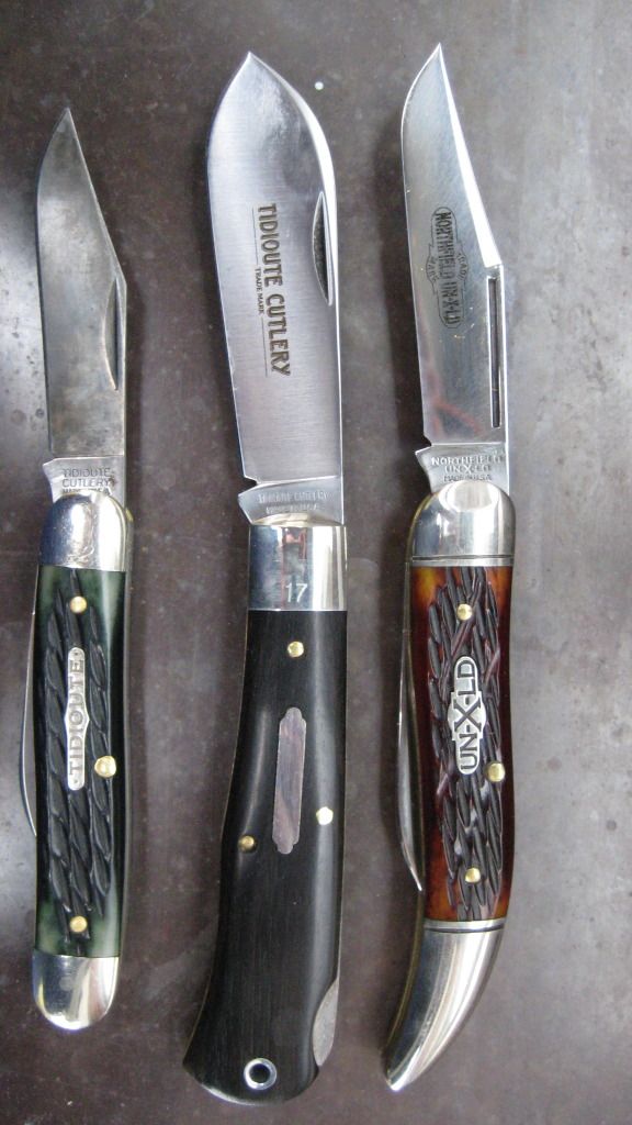

Today I got two great knives from GEC. Not the ForumKnife but a #72 Lockback and a #12 Powderhorn Jack.
As you can see, the #72 is made of Ebony wood and the #12 is made of Copperhead Jigged Bone. I wanted a Copperhead Jigged Bone the first I saw it here :) And I don´t have a GEC in Ebony, so I thought why not?

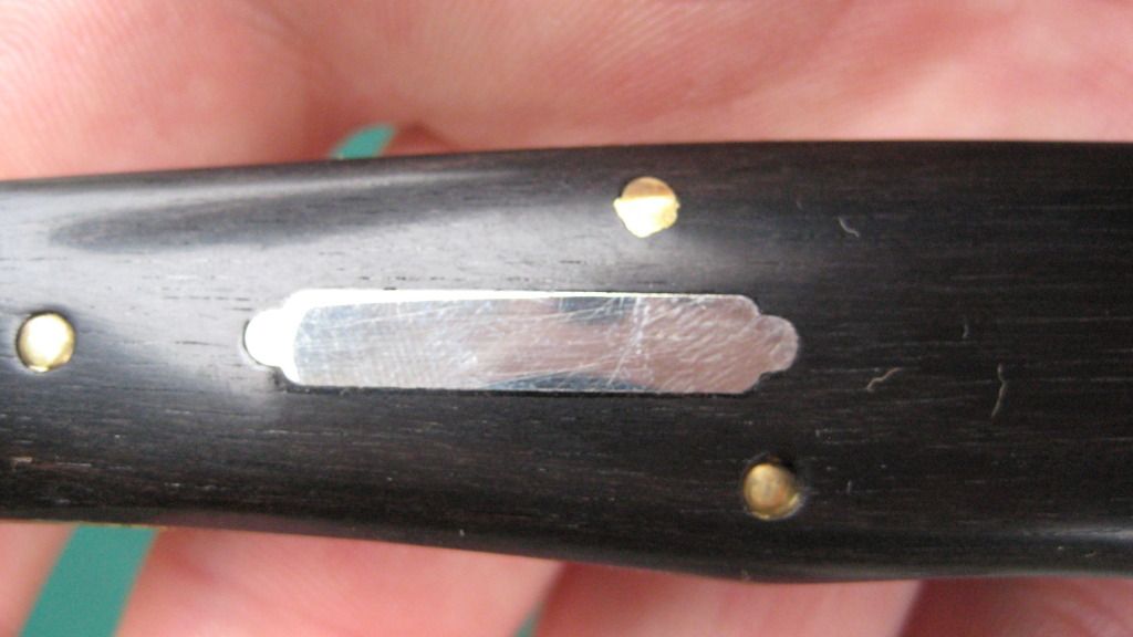

A qickshot of the the ebony wood - the grain is not good to see, but the wood is great looking!

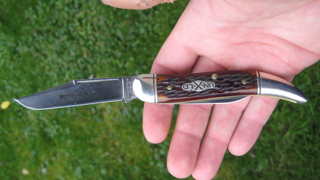

The Copperhead Jigged Bone is as nice as I imagined. I really love it!
The F&F on both knives is great. Especially the #12 is made near to perfect. No blade play, no gaps or whatever. Centered blades and everything is fitted well together.

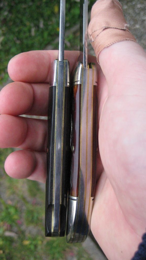

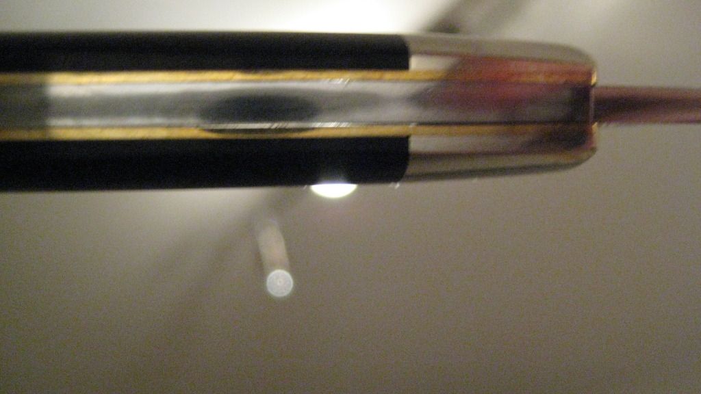

The #72 has a little flaw... there´s a gap between the liner and the backspring/lock. When moving the tip of the blade, there´s minor blade play. It´s not as bad as on my #73, but it´s still there. It seems, I have no luck with singleblades GECs. :(
Til now it doesn´t bother me that much, but it´s not really ok.

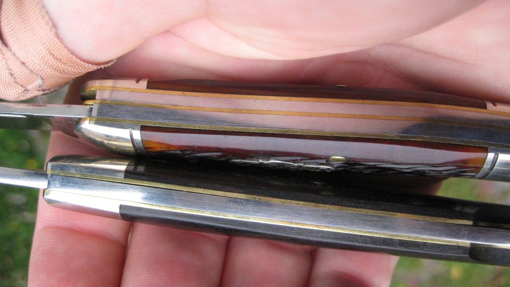

Maybe it´s visible on the following two pics

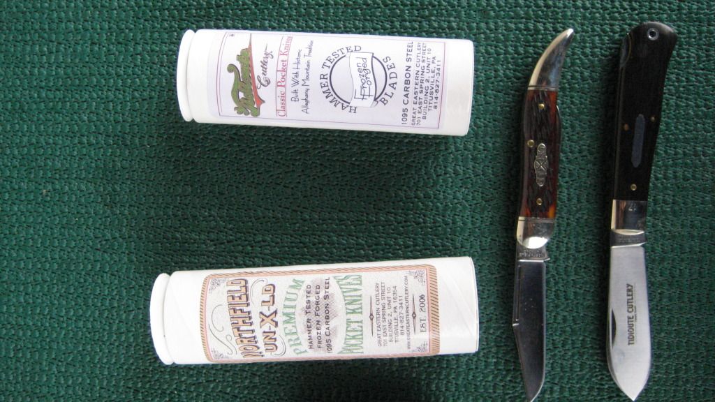

Size comparison to today´s fellow ;)

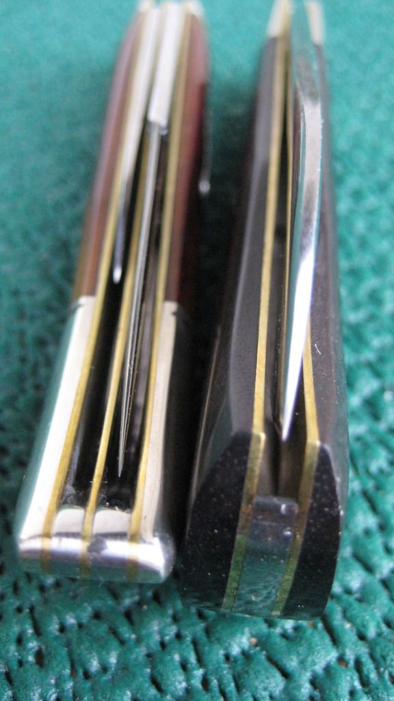

The centered blades on both knives - the bladeplay on the #72 is not bad, but it might become a problem in the future

Great looking knives Andi!! I like the #12 Jack, I need to get one one of these days. I'm sorry to hear about the #72 though. It does seem to be a common problem with that model. Is the blade play side to side or up and down? Or both? I've heard and have all of these on the #72 and can't recommend them to someone who wants a tight knife unless GEC changes thins in the future like it looks like they did with the #65 lockback. Can't comment on the #42 as I don't have one.

@ Trand & Gevonovich: The blade play is from side to side and it might be cause because of the gap at the liner. About an up and down play - I haven´t realized it, yet. I thought, a spearblade lockback would be nice addition to my rotation. The gap is a little big, but the play is reall minor and hardly to realize. I bought it from a retailer that ships to Europe, not directly from GEC. Though the shipping wasn´t that much, but the wait is the worst, everytime. ;)
I´ve read about that pattern, that there might be some problems with blade play, but just after ordering it :( I would have made another decision. If it gets worse, I could have done a quick fix by my own, as well as I have done it with my #73.

I´ve just tested the #72 ... now I´m not amused at all... :mad:
I cut some bread and a sausage for dinner. Then I looked at the gap between the liner and the backspring on both sides - this is result: The light is good visible through the gap and blade play is getting worse.
I did definitelly do no prying work or whatever to the blade.

Andi, be careful if you try tightening up that knife. Compared to regular slippies, lockback springs are substantially weaker. This is done so you can actually depress the lockbar without using a vice grip and two hands. Because of this the tightness of the liners against the lockbar and blade is very critical. If you were to make it as snug as a slipjoint, you'd render the knife useless since the bar and or blade would be too bound up to move smoothly with the pressure that the spring produces. It's common for many makers to purposely leave a slight gap for just this reason, especially on a large knife with a long lockbar. The greater distance between the center pin and the blade pin leaves a lot of room for a slight bend or twist in the bar to wreak havoc on an overly tight knife. The blade wobble is another story, just to be on the safe side if you can slide an .005 or so shim between the liner and the blade tang/lockbar before you tighten it, you'll avoid making it too tight.
