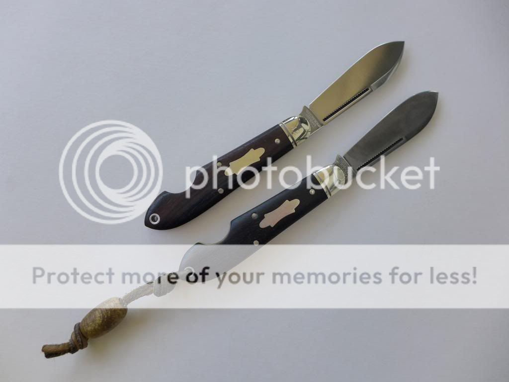

Take a look at this pic I took for you. Its lousy in quality but it shows quite a bit.
Look at how much fuller the blade is on the factory fresh 85. This is the knife I learned to peen pins on. You can see how I had to sand off some depth of the serial number to clean up my learning work. The satin finish is not showing through the patina that took a long while to form through use and carry. I worked over the entire knife, but I NEVER stained or did anything to darken the wood, but it darkened from hand oils, grease, grime, dirt and sweat. I sharpen ONLY with a translucent Arkansas stone and finishing strops. I never over sharpened, I have practice with that and I don't just sit there honing away wondering why its not sharp yet. The knife has been through a lot, dropped in water, dropped on concrete multiple times. Talk about not letting a blade snap shut, give me a break. I use this knife and I don't care to have to use two hands to close it. Grab it, open, cut, snap closed on my jeans...

Kevin,
Thanks for the pic - that helps. You user is gaining a lot of good character!
May I ask why you did the work on the knife yourself instead of sending it back to GEC? Did you want the experience of doing it yourself, or were you concerned that GEC would not address the issues to your satisfaction?
Also, could you give me an idea where on the blade the infamous ding actually occurs?
Blaine,
I have done a lot of work with knives over the years but I mainly keep it to myself. Doing the work myself I actually enjoy and I can contour and finish the materials exactly how I want. I have sent back knives to GEC and I trust them, they are masters of this trade IMHO. I just sent back a Scagel for a cover pin to be tightened, I just don't trust myself with that. I have lots of blade grinding experience, handle making, now peening of bolster pins, but thin stag and a cover pin I just didn't want to learn on that knife.
The infamous ding shows up directly above the mainspring pin (in the bladewell at the hump).

One thing that I've learned here about the blade edge hitting the spring (besides not letting it snap shut which I love doing with all my knives) is that you can put something like a match stick on the spring's hump inside the handle. The blade edge would now hit something soft which won't damage the edge.
