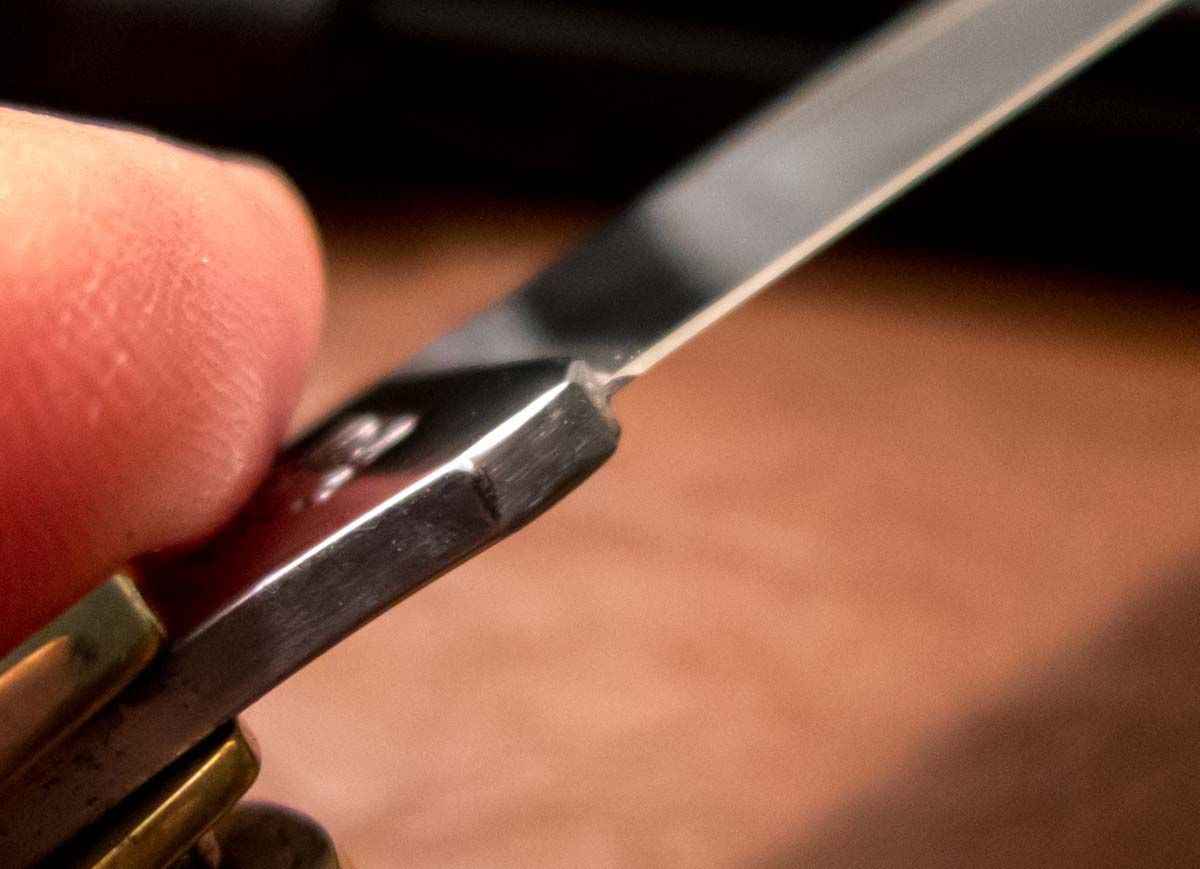

For the life of me, I couldn't keep the edge on it. I'm a beginner free-hand sharpener, and I'd get it hair shaving toward the tip and rear, but the middle seemed dull and the edge in general would dull rather quickly. The mark side's edge was uniform with a consistent height. The pile side "wavered" if that makes sense. The 1/3 closest to the tip and the 1/3 closest to the tang were uniform while the middle faded to nothing. I was sharpening on a stone that can accommodate the entire blade, so I sense the profile is off or the blade thickness changes. And after a good stropping, upon closing and opening, a glint of light reflecting from the edge showed that it hits the backspring......ever so slightly. Anyhow, I have a fellow BF friend that can really sharpen a knife, and he graciously took this in to see what is the problem and what can be done. Pictures to follow when the #89 gets back.

Finally, Gary used an old trick to prevent the blade from slapping the backspring. A little cork laid in perfectly.

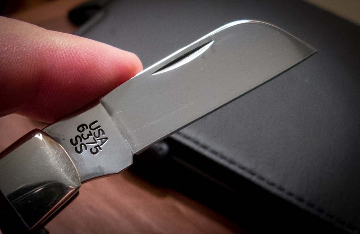

After Gary graciously ensured this #89 had an extremely keen edge, it went back into the pocket. I wanted to post this updated pic. I believe you'll agree that it has reached maturation in the patina department.
Some other thoughts, I can guarantee you that its edge is extremely sharp, alas it is not a good slicer. Why? It is sleek, it is slender, it has a "Gary" edge. It cuts apples, but not like lightening, and not like my TK Cuban. Why?
I have a theory. The blade height (from edge to back) is very short. Hey this is a slender/sleek pattern. Being short in distance from edge to back, the blade's actual profile is wedge shaped to a point that it cannot be "thin behind the edge". That is what I'm thinking anyhow. It certainly can handle the task, but just does not excel. What it excels at is general EDC. All around great knife, that disappears in the pocket.

Regarding the not slicing with great ease despite being shaving sharp, your thought that the wedge shape is wider due to the short edge to spine distance, depends on thickness of stock for wide a "V" or wedge it makes. Across the spine, at the tang is it 1/8" or 1/16" ?
There is also 'drag', a deep blade like in a Toenail pattern has a more narrow "V" but the large blade surface is in contact with the object being sliced so there is more friction, "drag", which means more pressure needed to slice.
So, thickness of the wedge or "V", vs. depth of blade creating drag, which is more important for ease of slicing ?
I'm thinking GG might know the answer which is why i'm asking it here.
kj
kj in my opinion the tonail patterned knife being thinner at the edge bevel shoulders and gradually thickening out to the spine would slice easier as the material will be able to separate better as it slices, where the shorter wedge of the narrower blade has a fight right at the start, just an abrupt jump in thickness hurts things like slicing through thicker material. Through clothing or material that isn't thick, probably a toss up, the 89 did get quite sharp and will cut...especially yourself if you're not careful ;) but for most things we come up against, a thinner blade would be handier.

Thanks KJ and Gary. The 89's main blade stock is 1/8", but it is offset ground, so the blade stock is 3/32" tang forward. The blade height (at the mid point-laying flat on ruler-hypotenuse) is 7/16". If we compare the ratio between 1/2*blade thickness stock, to the blade height (not measuring along the grind-not the hypotenuse) we should come up with a ratio. We could compare this GEC's ratio to the same ratio of a blade that we know is a good slicer and see if a pattern develops. Anyone remember trigonometry?
