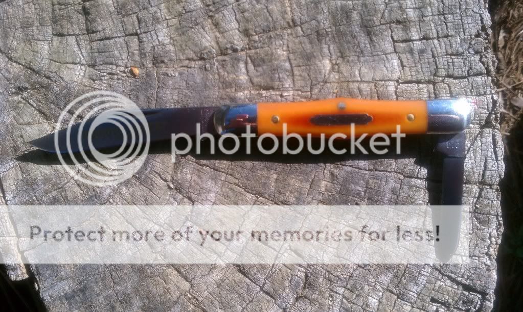

Overall I like it ... but ... have a couple criticisms that prevent me from wanting to buy another. On the one I own the blades show evidence of rub in two places. :( In my experiance, that's common on production slipjoints with blades on opposite ends. Maybe someone with more experiance can clue me in if this is normal or not, but the only production slipjoints I have owned with blades on opposite ends that don't rub are the Case / Bose collaborations. Even if I ignore the blade rub, the pen blade on mine is significantly more difficult to open than the clip. I rate the clip pull a 4 on the 10 scale, exactly what I prefer, and the pen a 7-8. Not only is the pull strength higher on the pen blade than my preference, the good looking center swell is in the way of the nail nick on the pen blade. IMO this is a design flaw, pic illustrates my point. Those issues have resulted in me breaking my thumbnail trying to open the pen blade :mad: and render the pen blade worthless to me. Unless I can inspect them in person, I'm done with production slipjoints with blades on opposite ends, I can only use one blade at a time anyway.

Chief, sorry to hear about your problems with the #33. I just recently purchased my first Conductor and it doesn't have any blade rub or the stiff pen blade. Now my pen blade is a little harder to open than the main blade but no where near the level you are describing on yours. I would say the main blade is about a 4 just like yours but I would only say the pen on mine is a 5. Also my pen blade doesn't sit that far down in the frame, mine is a little easier to get to than yours. I'm not sure what to tell you to do about those problems, you may want to give GEC a call or email to check and see if there is even anything that can be done.

I'm very keen indeed on the Conductor (GEC in general) but I don't want to fall into the Fanboi trap however who will hear no criticisms. Your picture clearly shows the defect, but I wouldn't regard it as an innate design fault . My Conductor has the nail nick well above the hump so no problem. Yours should be the same and it renders yours very tricky to open. It's odd too that the blades suffer from such different pull, them being on the same spring, but it may explain the rub? somebody may explain the mechanics of it, and it shouldn't rub. The only single spring I have that rubs is a CASE Pen in cv, the Trusharp doesn't nor do 3 other GECs couple of Queens, S&M, RR or an old Höffritz and an aged Remmington Pen (well worn and still smooth).

Yes, it's ivory. To call it an innate design flaw is incorrect since yours doesn't sit as low, would you please post a pic? Because the pen sits low, it probably exacerbates my perception of the pull, but it resulted in a splintered thumbnail none the less. Considered sending it in, but didn't know if I was being unreasonable in my expectations. Thanks for your input.
Chief, no camera and no picture skills I'm afraid.
Been looking at dealer shots of these knives, they DO vary.Some are like mine,well above the hump, others too low. Yours is an expensive version and really should not be in that state I feel.
