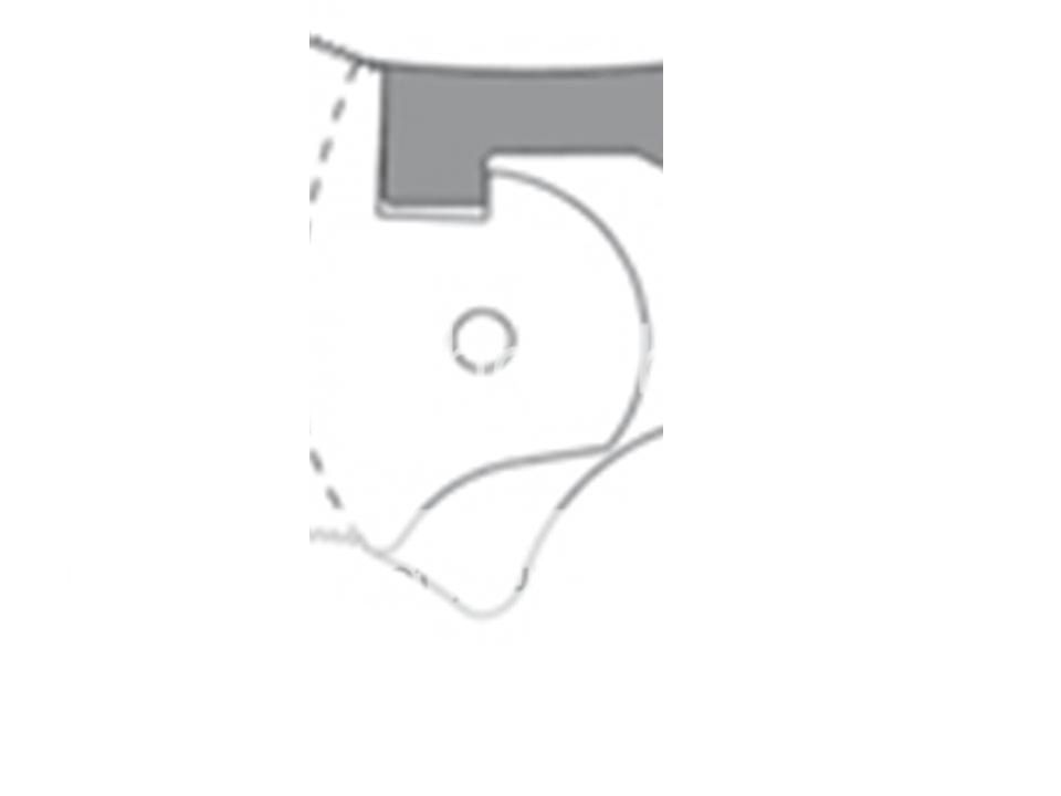

You aren't understanding the situation. It isn't a matter of "Quality". It is not a matter of "imperfection". To be truthful, getting a classic lockback with zero play is a matter of luck.
It comes down to machining tolerances. A classic lockback mechanism is not self correcting for fit like a modern liner lock is. In order for there to be no movement, it has to fit dead nuts. Dead nuts to the extent that the fit has to be tighter than that provided by the standard machining techniques of a production knife factory.
Here is a picture of a lockback lock that I swiped off a web site:
Notice that the fit has to be exact, else there is going to be movement. The bar has to be exactly the same size as the notch in the blade. The tolerance for a high precision milling machine on a 1/4" notch is about ± one mil (0.001 inch). Notice I said "high precision". "Standard precision" milling would be ±0.010. The tolerance on on milling the bar that has to fit inside is the same. That means that for the combination, the tolerance is ±0.002". Since you can't have a bar that just does not fit in at all, you have to size the notch a couple of thou oversize to allow for when the the bar tolerance is + and the notch tolerance -. If you followed me, you can see that it becomes quite possible to hold the tightest manufacturing tolerances possible, and still have some movement in the finished lock.
It is possible to hold tighter tolerances if you hand lap every lock piece. It is also possible to get nano precision mills which will mill at much tighter tolerances. Neither one is going to happen in a production shop. Both options would drive the cost of a production knife into the stratosphere. (Nano mills take frickin forever to machine anything. They also have stratospheric prices.)
Now you can pull a cheatsie and angle the sides of the notch. The the bar slides down until it can't go any further in. But, if you do, you will not have a classic lockback lock. You also won't have as secure a lock as a lock with straight sides and a bit of movement in it.
According to Spyderco's Sal Glessar, you can also make other changes to the lock shape. I further understand that Spyderco has done this and has all but eliminated movement in their lock backs. But it is no longer the classic lockback that your grandfather would have carried.
