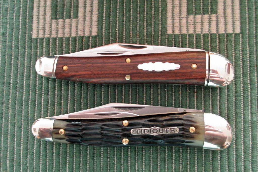

I can't help with your question about acrylics but you're right about the size difference between the 14 and 54. I don't have an in hand pic of either pattern but below is an in hand pic of a 53 which is the same size as the 54. Pretty big knife but it does have an excellent feel when using it. Plenty of handle to grab onto. It's the weight and bulk in the pocket that might push the limits for some folks.
The 14's are great knives too and I've never found mine to be too small. The blade is well sized for a knife that's barely over 3 inches closed.

With my medium stockman I've always paired it with another larger knife, but I was hoping I could find a traditional that would fulfill both worlds. As for the GEC 66 I looked at it, and it looks very nice I've just found that I tend to not use the spey blade on it, so I decided I'd try and find a two bladed jack of some sort. This might seem like a slightly silly question but is the blade on the 14 large enough that you could spread peanut butter or the like with it? Just a small thing that bothered me about the clip point on the buck stockman, the blade didn't have enough width to comfortable to something like that. Thanks for the reply guys. And thanks for the pictures railsplitter, those 14s look amazing, and wow if the 54 is similar in size to the 53 its a hair larger than i thought. Truth be told I'm really looking forward to the new GEC 35 Churchhill. That seems about perfect. Anyone know when they're suppose to start production?
You're welcome. I don't think the blade on the 14's is big enough to spread peanut butter but if you like the 35 Churchill frame, maybe you would like the 2016 Bladeforum knife. Built on the 35 frame with a fat Spear blade perfect for spreading peanut butter and great for cutting chores as well. It even comes with a really sharp punch.
