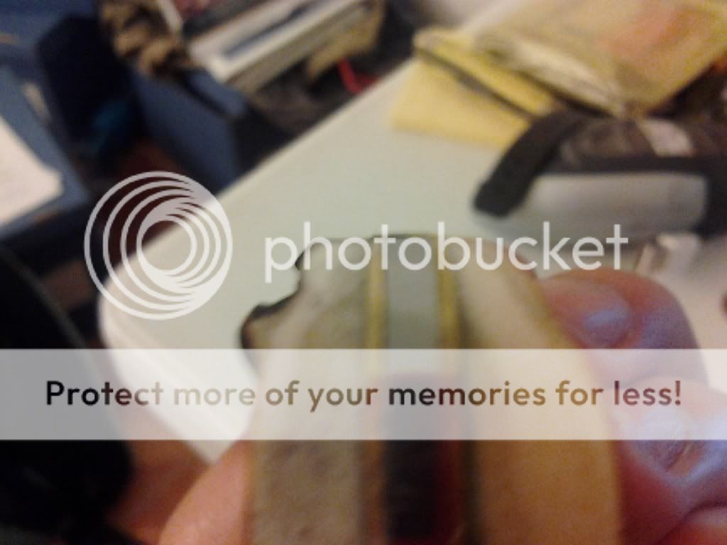

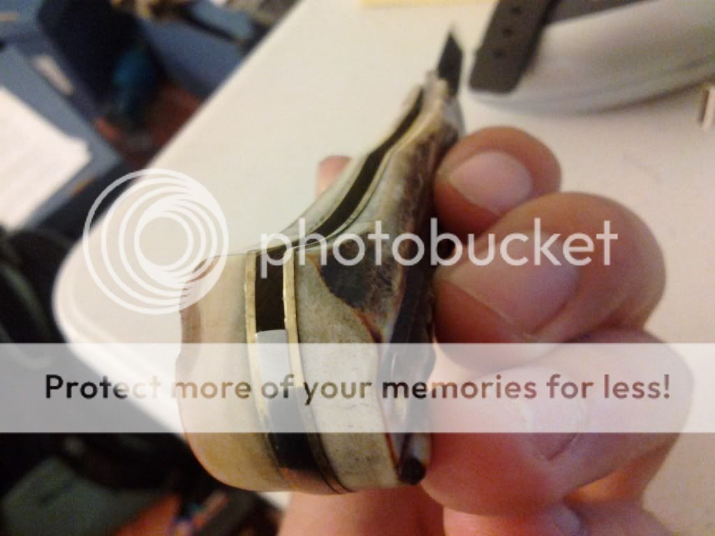

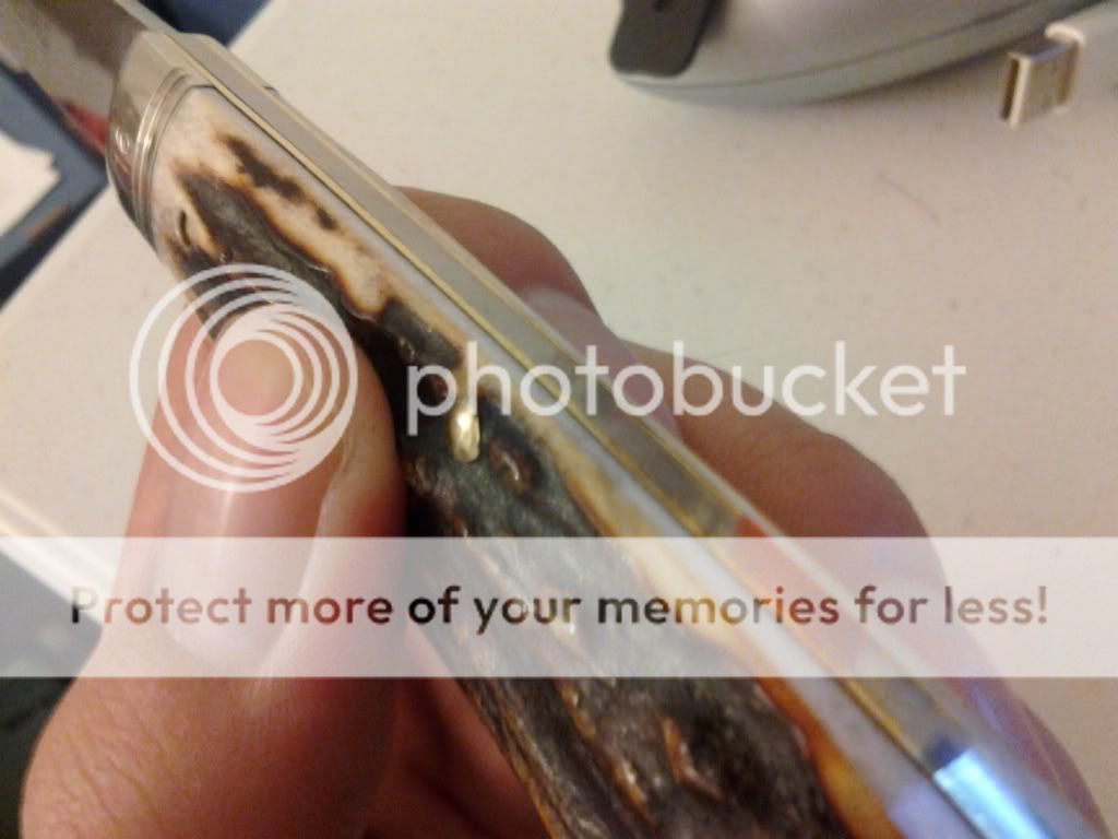

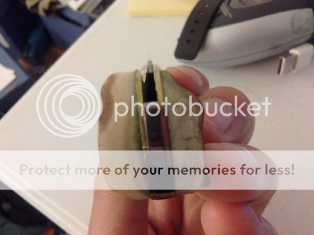

Just got my first stag , a GEC single blade trapper produced in 2011.The problem is that the liners are slightly bigger than the stag so I can feel the sharp edge of liner very very obviously thus make the knife uncomfortable to play or use .
Is this really a problem ( So I wanna return it) or something normal with all your stag handles ?
it cannot be shown in obviously as it is so slight , though the edge of liners is really sharp .

Guys,12 hrs in baby oil and no difference in scale size.
What should I do now ? Return it to the dealer (but will they accept it ?) or just wait ?
