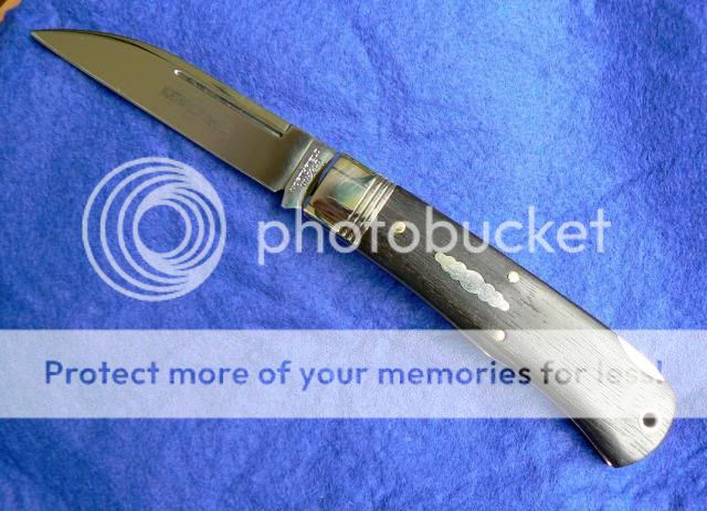

Fit and finish on the knife is first class – wood to metal fit is great, grind lines are symmetrical, the shield is nicely inlet and the ebony looks really good. The blade has quite a dramatic swedge that runs full length. I am ambivalent about the swedge – it looks racy but I am not sure that it adds anything functional and is a bit uncomfortable when you choke up on the blade and press down for any fine cutting.
Here is the knife when I first received it - all shiny and new

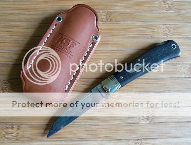

The knife is light and fairly thin. It carries well in the pocket but I have been keeping it in a KSF pocket sheath at work. All quite unobtrusive and it protects the knife well – as long as you don’t have a thing about quick deployment it is a good carry method.

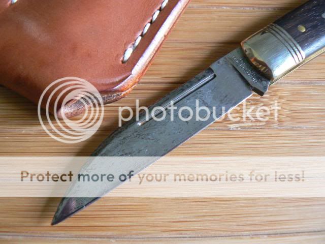

The blade comes delivered with a nice polish but don’t expect this to last with 1095 if you use it. The blade stains quickly and there is no point in resisting it – just keep it clean and don’t let it get to the stage of rust or pitting.
Here is the knife after a month or so of daily use

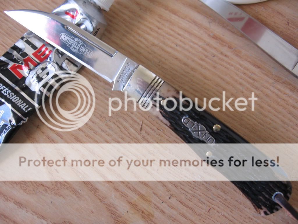

I've had to file the kick on every GEC Wharncliffe user I've purchased so far. At this point (ho), I'd say that slightly exposed points -- or at least those that are flush with the liner edge, which is still close enough to nick you -- on GEC Wharncliffes are, often as not, a rule of thumb.
FWIW, I've noticed that different GEC patterns react differently to having their kicks filed. The #26 and #62 backsprings remained flush with the liners after some serious kick adjustments, while the #72 lockback's spring went slightly shy after a very judicious kick filing.
The good news is that GEC listens. We complained about the dull edges and they started doing something about the problem as of late '10. They still need a touch-up to get 'em the way most knife knuts like 'em, but the new GECs in my experience have been sharp enough that many users will be content to put them to work fresh from the tube.

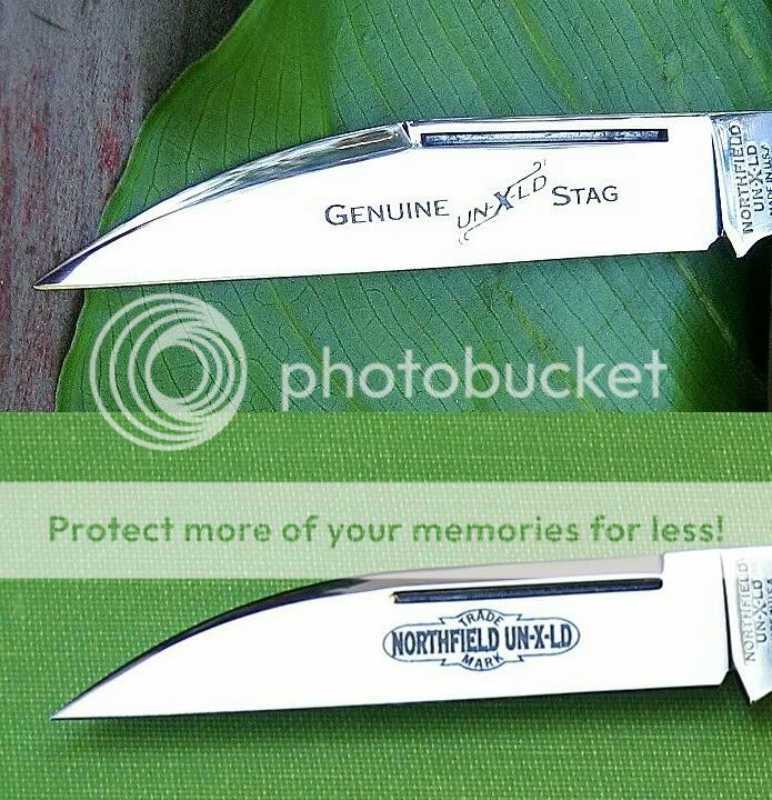

I'm very pleased with my ebony lockback, but I too think the arrangement of the swedge and pull could have been better. The #62 layout (top) is more user-friendly with its swedge cut further out toward the point and higher pull. IMO, it looks nicer that way, too.
Rick - nice clear pics. I also prefer the swedge arrangement on the 62 - I guess these types of things are more about personal taste than whether they got it right or wrong.
