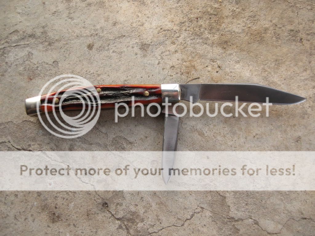

Here is my queen serpentine jack when i bought it. You can see the edge bevel is very narrow, and is above 40 degrees.

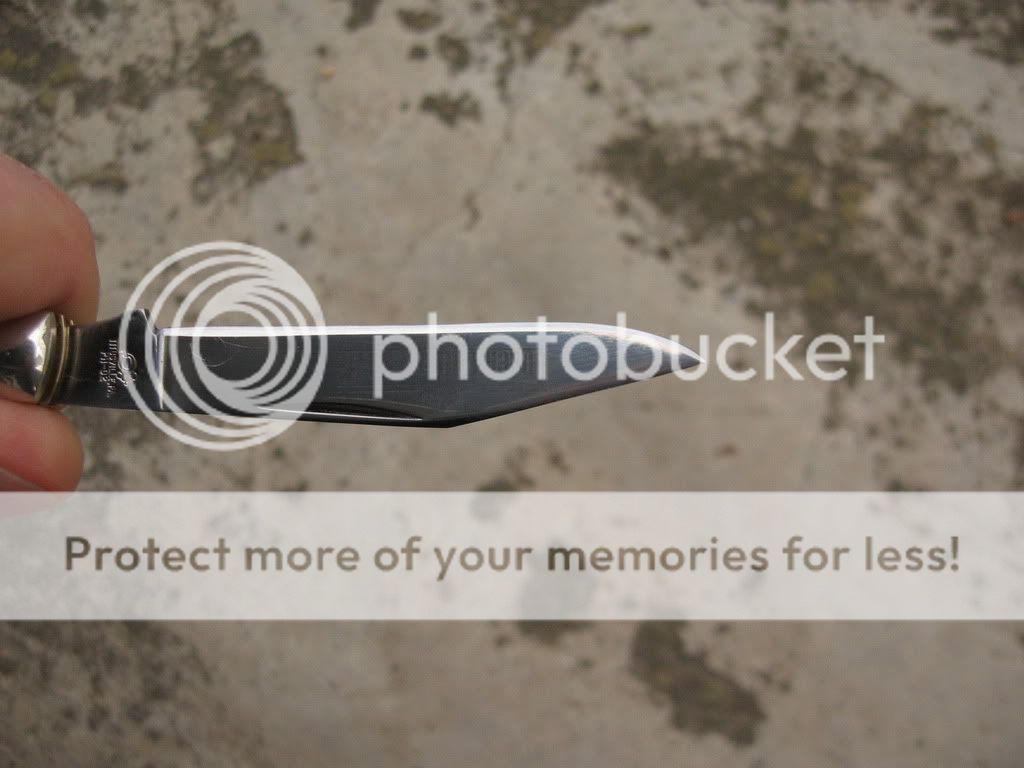

Here it is after i worked a lot on the 30 degree setting, both sharpmaker and free hand. Notice how the edge bevel became wider.
In the above pics, with some passes on the 40 degree setting, thus creating a microbevel, the knife was cutting well through paper and was shaving hair off my arms.

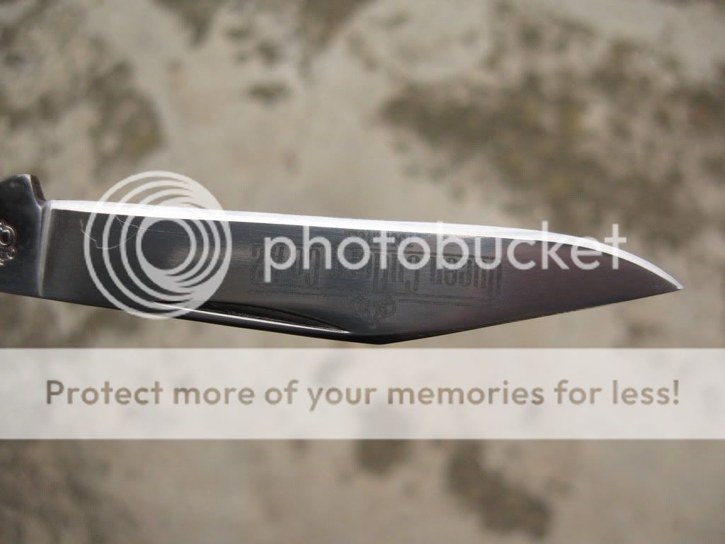

But i wanted even a thinner blade/edge, so in the next picture, both blades had been reprofiled. Notice how now the edge bevel is narrow again, be it 40 or 30, but that is because it was reprofiled to a zero edge, just a bit convex right on the edge.
After this, it became a true slicing pleasure, push cutting through any paper, and if dulled, back to hair whittling sharp from just a few passes on the sharpmaker rods.
