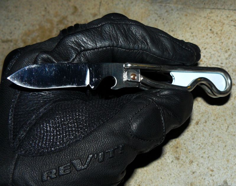

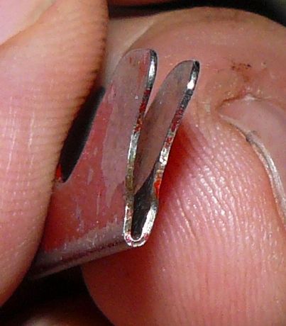

A few photos of the guard removed, easily popped out with a small screw driver since it was held in place by compression fit and the insert is flexible, from a pat. '42 Geo Schrade scout Wire Jack for your amusement:

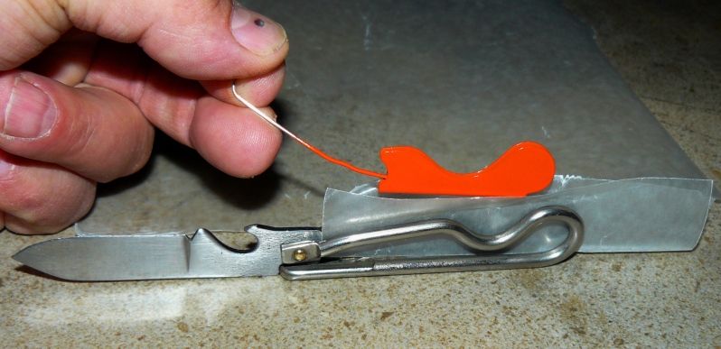

Guard is now primed and awaiting "rescue me" orange top coat of enamel paint.
After removing the remnants of the original red paint and polishing the surface of the guard I put a paperclip into the fold and suspended the guard from a strong magnet in order to spray paint it on all sides.
The orange enamel paint is curing now.
When the paint has hardened I will slip it into place, in the handle, using a small envelope of wax paper to pave the way. Maybe I can find a volunteer to hold a flat-bladed screw driver inside the handle to spread it a bit. When the guard is in place I will remove the wax paper sleeve. Hopefully the waxed paper will protect the paint while the guard is compressed into the handle. I'll see how this technique works.

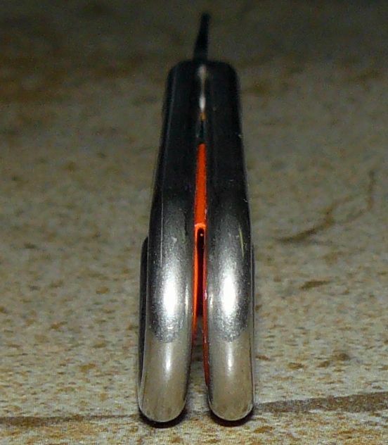

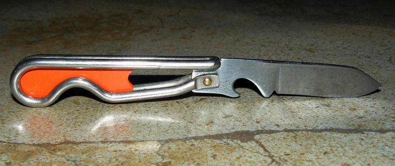

The orange guard, using the wax paper, went back into position in the handle without issue.
