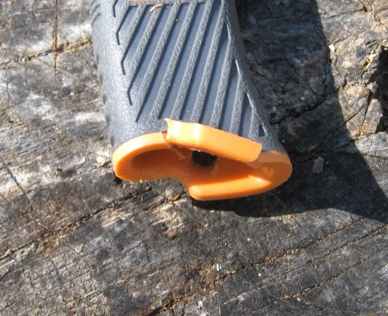

I tend to be a little less cynical than that, but I find it hard to believe that the pommel stayed on when Bear batoned with the knife, and we know he does that a lot. He probably never thought about that and just assumed it was fine since he has used other Gerbers without such pommels and the blades held up. I don't think he ever put the final production model though a real Bear Grylls test or he would have discovered what I did. You know darned well he won't like these knives breaking all over the world with his name on them.
The pommel actually broke off while you were striking the blade?
Yes. Whether or not I had weakened the pommel by smashing a little acorn earler, I can't say. I have yet to find the pommel as it sailed off into heavy undergrowth.
Ah, but I'm sure it was worth every penny of the $50 he spent on it just for the photo of Bear looking all manly and all (right before he went back to his hotel room for Dunkin' Donuts, that is).
It appears that all that was holding the pommel on was two little hollow pins under the rubber cover of the plastic handle.
Wow, if it broke that easy the plastic is definitely more brittle than the little pumpkins eh?

Hahaha. As you can see, the handle is unscathed. Beating on the blade must have been just too much shock for the handle. Or maybe I should never have hit that acorn with the pommel. I thought that was what it was for, like on the Air Force bolt knife. We will never know for sure. Yeah, I think those plastic trick or treat pumpkins are tougher. :eek:
