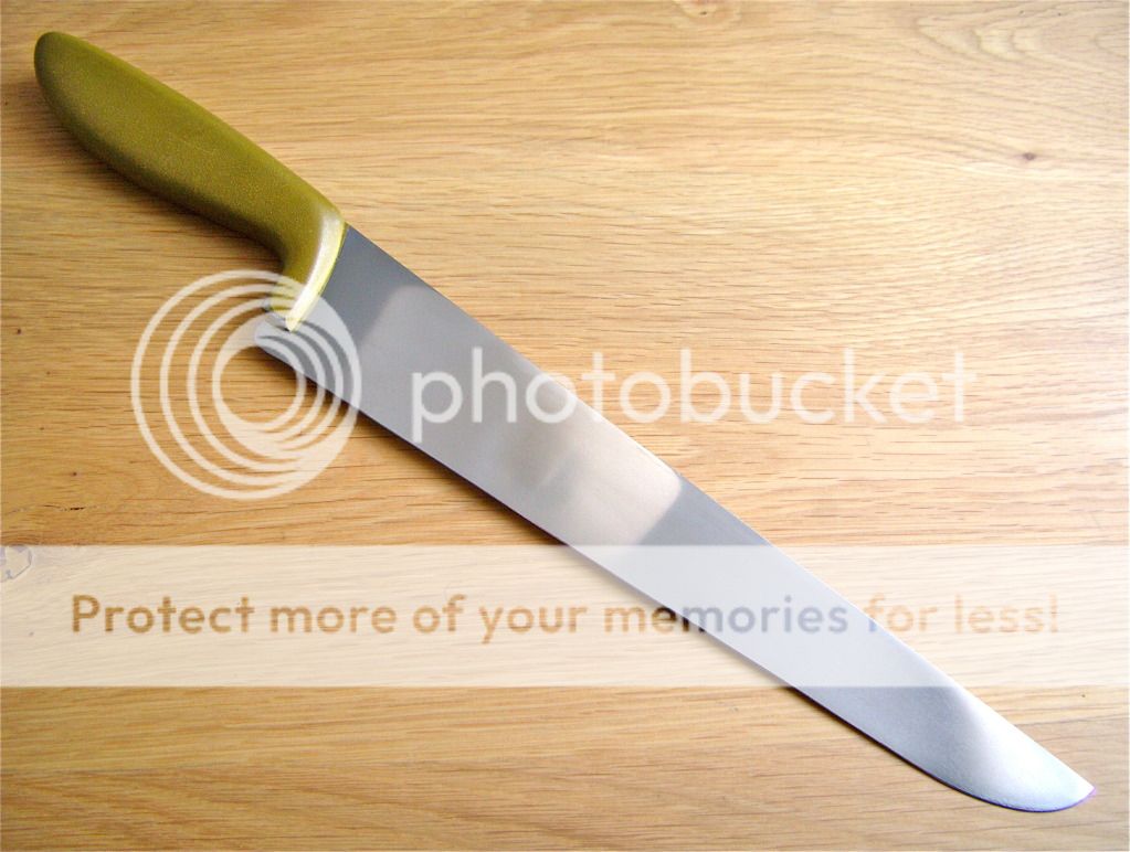

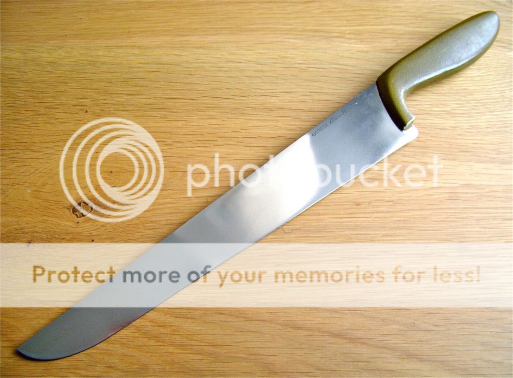

These days they are almost forgotten, but a few decades back Gerber produced a few series of high quality kitchen knives.
This model Flamborge Chef knife possibly dating back to the sixties or seventies has the same construction as their hunting blades from the same period: a blade made from hard chromed M2 high speed steel and a cast-on aluminum handle with a grippy Armorhide coating.
Now you could dislike the overall design of the blade or the strange greenish color of the handle, but the build quality as well as it's usefulness is actually very good.

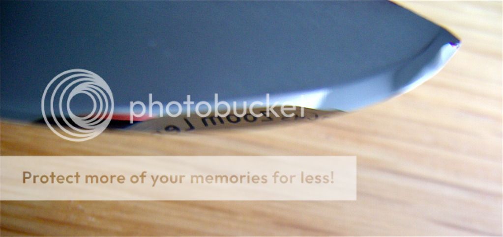

These pictures show the knife before sharpening:
The edge of the knife is originally almost completely straight, except for the curve towards the point, and the thin blade itself measures 0.32 mm just behind the edge.
This Flamborge is badly in need of a good sharpening because the edge is not only very blunt, it also doesn't touch the cutting board anymore over the complete length of it's edge (it's a bit hollowed out)
In the years that these knives were sold on the American market many users experienced difficulties in sharpening them because of the hard steel.
Diamond stones were not readily available to anyone yet and most people relied on natural Arkansas stones anyway.
Steve Bottorf, the author of the book "Sharpening made easy" was one of them:
"The most difficult knives I ever tried to sharpen was an old set of Gerber kitchen knives.
They were so hard that natural stones hardly touched them.
Diamonds would grind them, but I don't have a diamond stone fine enough for a shaving edge.
Paper wheels is the only system that has ever brought these knives to a razor edge."
Specs:
Overall length: 15.2 inch (38,7 cm)
Blade length: 10.1 inch (25,6 cm)
Maximum blade thickness: 2,24 mm
Thickness behind the edge: 0,32 mm
Steel: Hard chromed M2 High Speed Steel
Handle material: Cast-on aluminum with green Armorhide coating

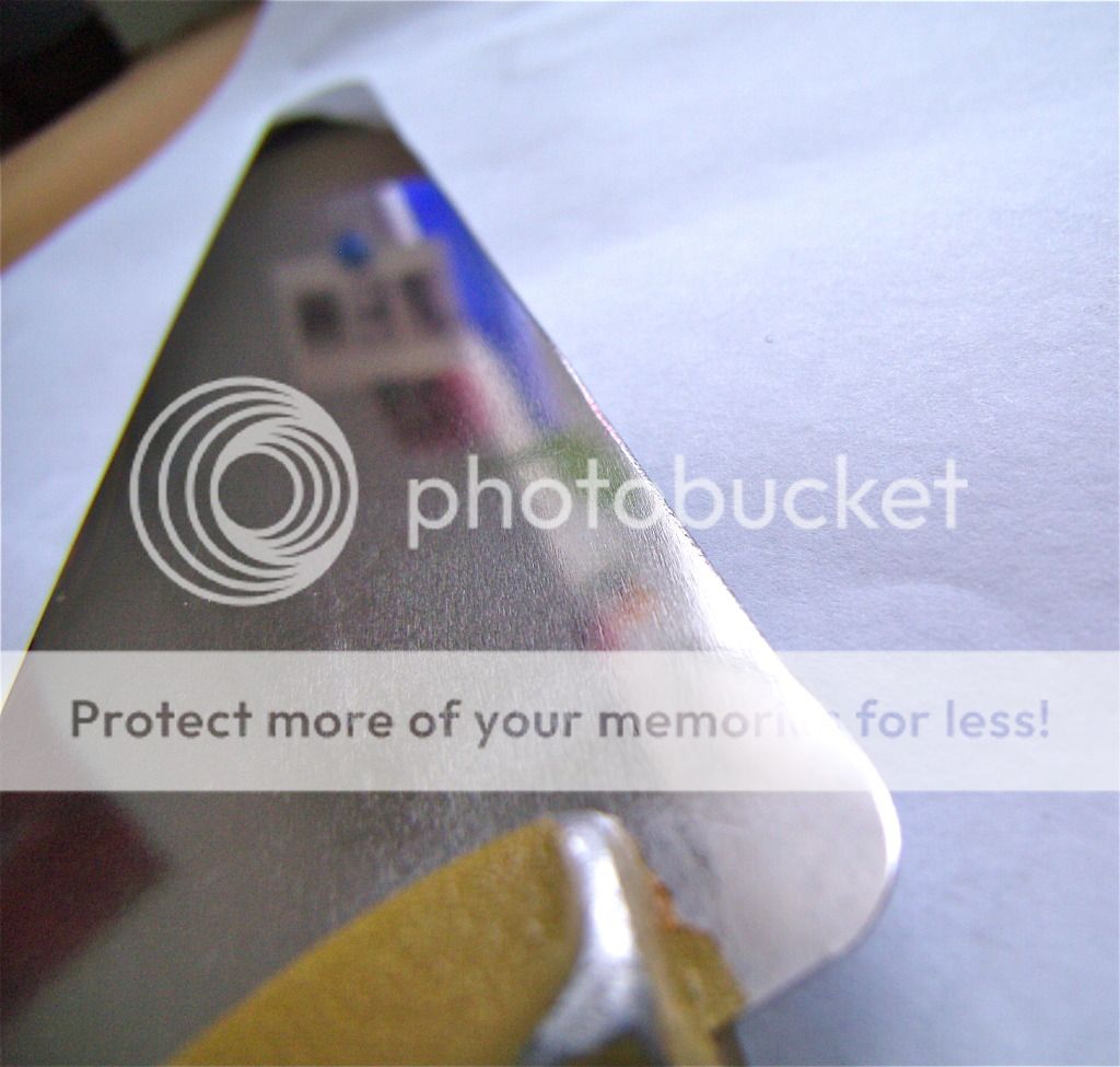

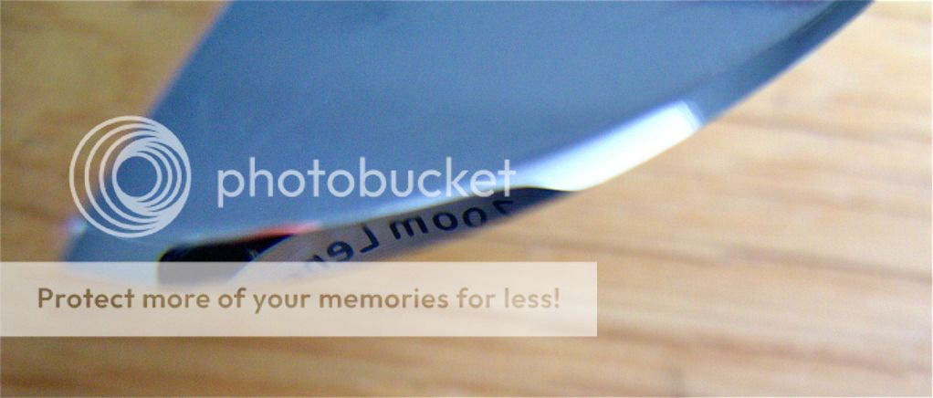

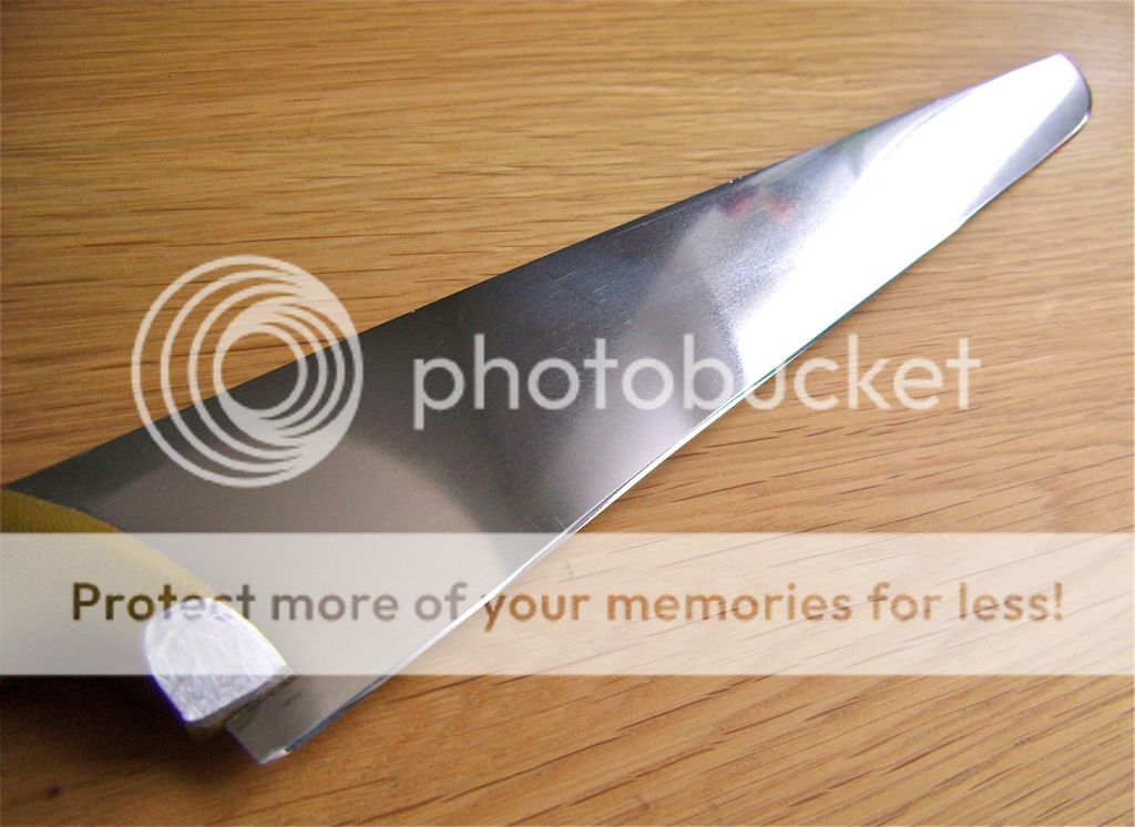

This is the knife after sharpening.

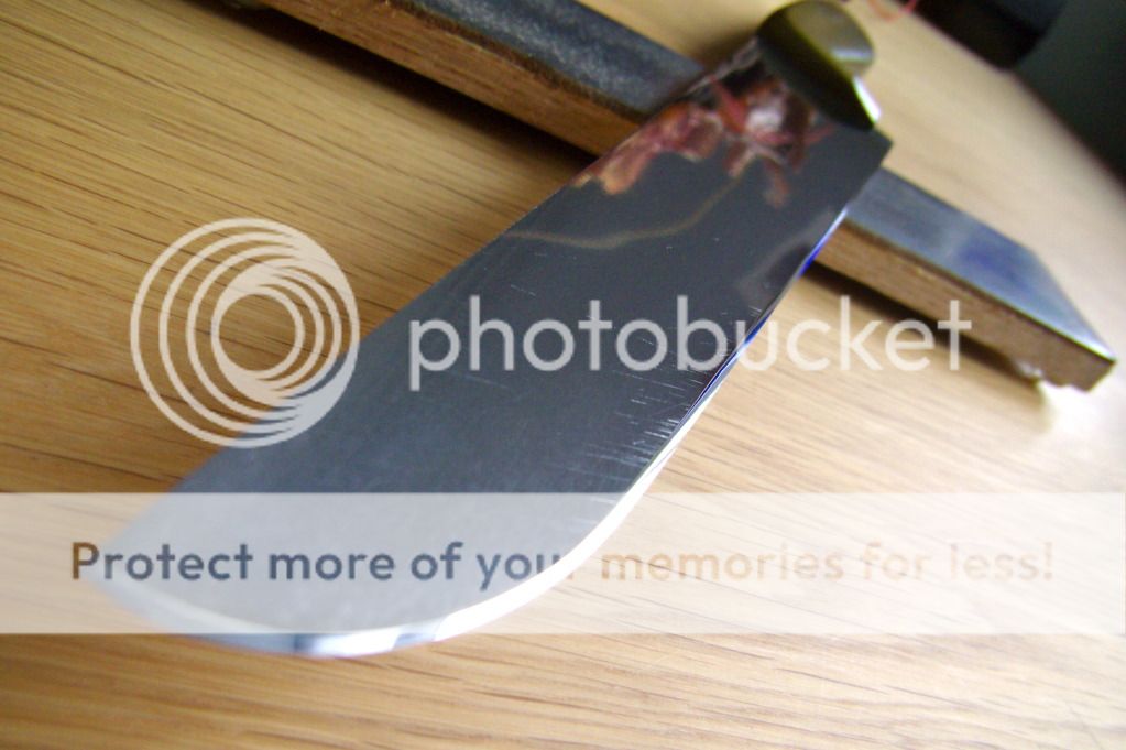

Straightening the edge and reprofiling was done freehand on my Tormek T7 wetgrinder (the blade literally screamed), while refining and polishing with 6 micron diamond compound was done freehand on my Paper Wheels.
Because of the amount of metal that had to be removed the thickness behind the edge increased to 0.48-0.50 mm.
Although the edge looks to be mirror finished to the eye, a jewellers loupe reveals the fine and very even scratchpattern that i think gives harder chef knives (between 60-65 HRC) a good combination of sharpness & bite.

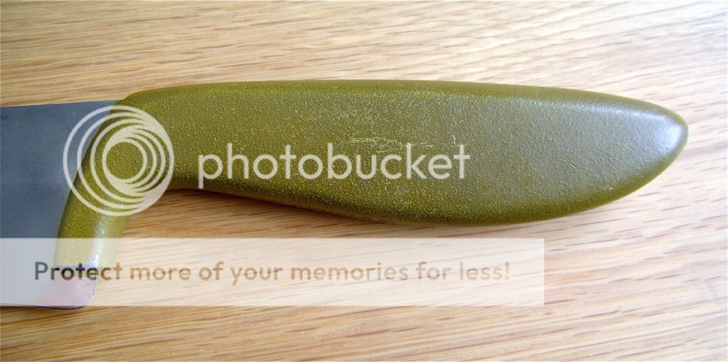

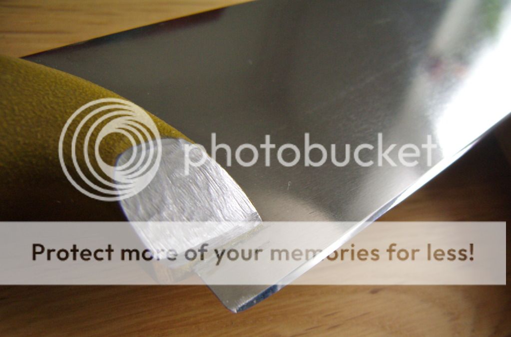

As you can see in the pics i had to remove a portion of the aluminum handle on both sides to be able to sharpen the edge all the way up to the heel.
(still have to sand those parts a bit more)
The new edge angle on the straight part of the blade measures 25 degrees inclusive while the curved portion measures 30 degrees inclusive.
(measured with my Tormek Angle Guide)

Personally I wouldn't have removed material from the handle, but instead would have ground down or cut out the section of edge that runs into the handle, as it's useless there anyway.
I thought about that too, but that portion of edge is there for a reason: support.
Removing that piece of edge would lead to the point of the knife coming off the board when for instance chopping herbs or garlic.

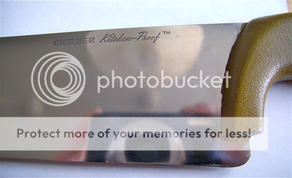

That Gerber 'Kitchen Proof' knife is quite different in blade profile to the normal Gerber Legendary Knives 'Flamborge' french chefs pattern.
Any comments from the informed?
Seems there are 2 blade profiles for the whole range of Flamborge, French, and Curtana, kitchen knives.
This 'Flamborge' pattern is similar to yours but in std chromed aluminum handle with Gerber sword stamp.

@Blades-N-Glory: the handle on the Flamborge knife is coated with Armorhide, not Cat's Tongue.
Cat's Tongue was originally called "Steel Grip", and consisted of sprayed stainless steel droplets that solidified on the aluminium handle, forming a tough and wear resistant surface providing lots of grip.
Armorhide is sprayed Teflon, and although it offers some extra traction compared to bright chrome, it's not very wear resistant.
