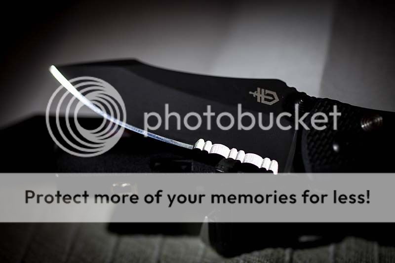

Here's just a quick shot of mine, the black coating has some rub marks along the grind lines which adds character I think, kind of a two tone look,
While it doesn't remove all the knives from my EDC rotation, it has earned a place in the line up for work for sure, ** Edited to update status, ended up not keeping the knife after all, blade didn't seem to keep it's edge as well as I liked, that plus the thickness of the blade at the bevel shoulders are too thick, I had high hopes for this one **
