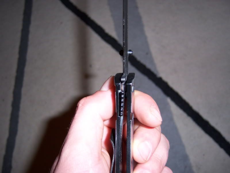

When I rubbed my fingers over the flat of the blade my fingertips were covered with a black powder. The grind lines were off on the edge of the knife. With one side it shaved easily and the other took a little more effort. It did not slice newsprint out of the box and cut standard notebook paper with some effort. The knife did lock up solidly with no blade play vertically or horizontally. The liner lock did protrude from the scales (there is no cutout in the handle to access the lock) about 2 mm. I would worry that in white knuckle grips this might cause the lock to disengage, especially when there is blade play or wear from use.

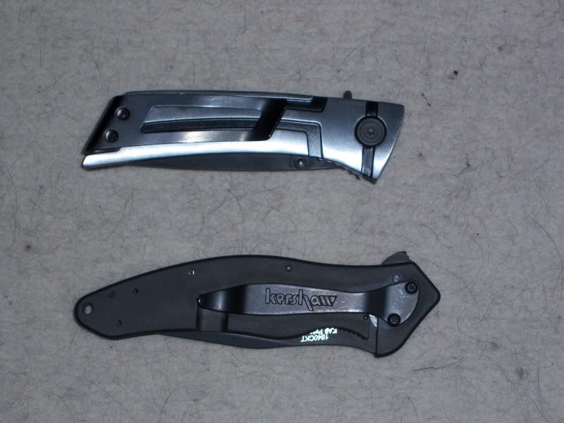

Closed, clip side, with a Kershaw Shallot for scale:

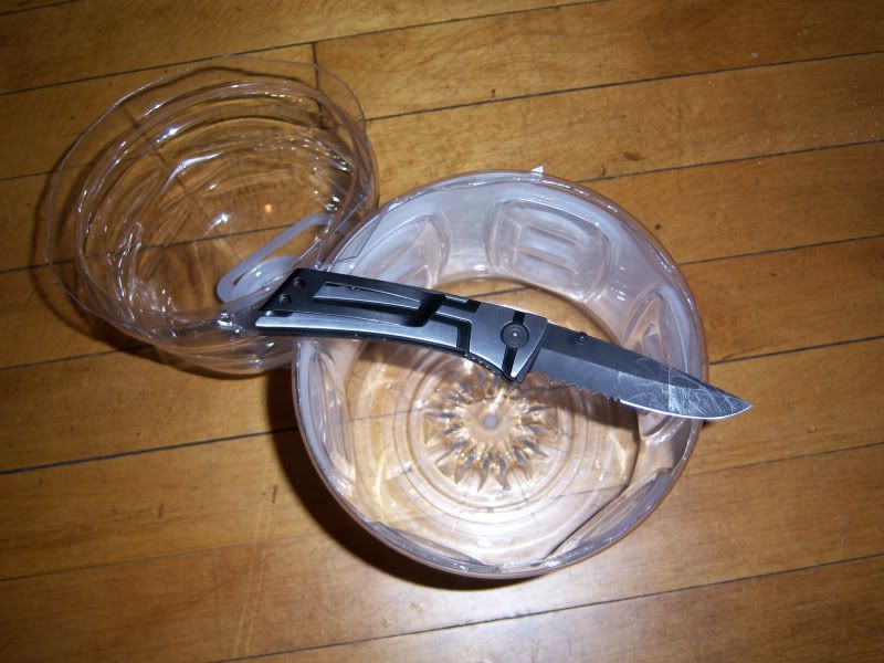

I moved onto a water bottle. This was one of the “green” environmentally sound thin water bottles. The knife cut through it easily and cut it into a plastic slinkie. I did not use the serrations again, only the plain portion of the blade. I had no trouble cutting the water bottle up. From time to time we cut up empty plastic water and spray bottles to use as containers or drip pans for fuel or oil or to put odds and ends in.

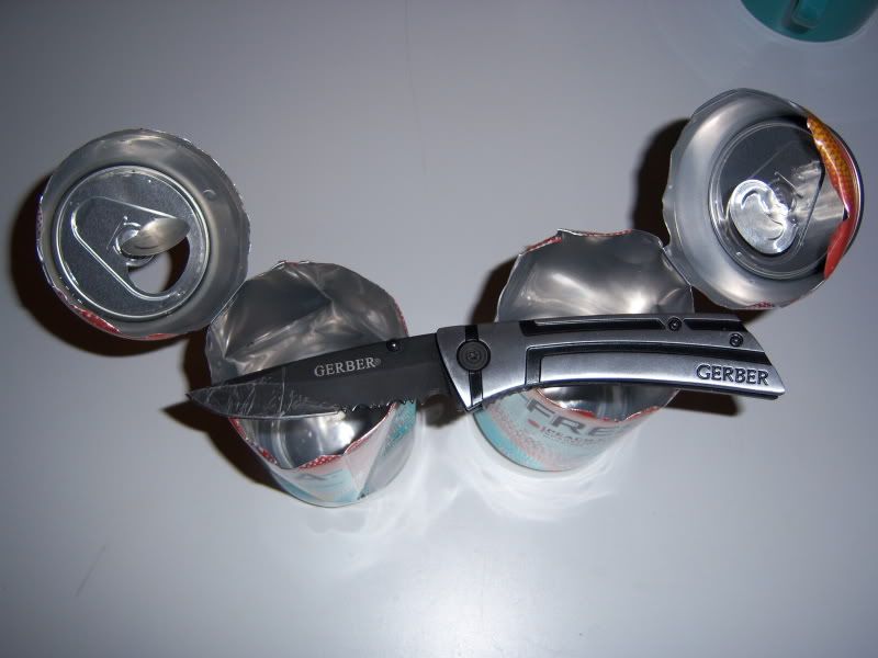

Sometimes we use soda cans (if we have them laying around). The knife had no problem piercing the can (no tip damage) or push cutting through the aluminum. The can did scratch the blade coating up somewhat. I was able to rub my finger over the coating and black film was left on my finger tip. The scratches are still visible on the blade.
I cut up a large, much thicker bottle using the serrations. They cut more like a saw than a knife through the plastic. The plain edge portion did not have any problem pushing through the heavy plastic but the serrations needed a back and forth sawing action to cut.

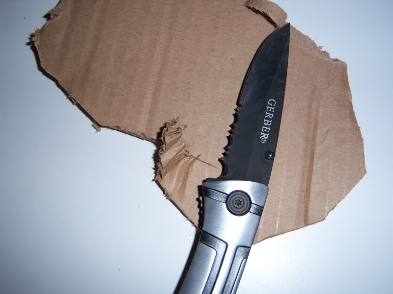

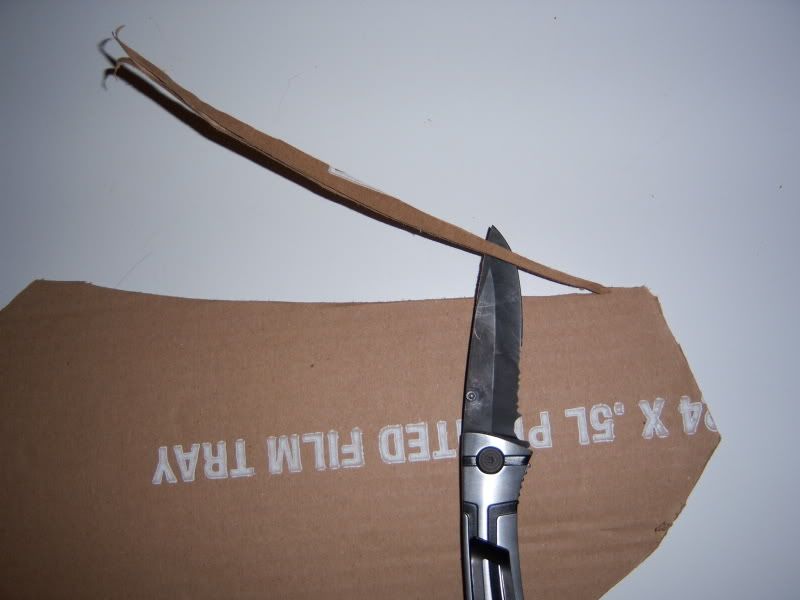

I cut up a cardboard box from a case of bottled water. The plain edge portion was able to shave thin slices of cardboard off without hanging up.The serrated portion ripped and curled the cardboard before binding. These serrations are not optimal for ease of cutting. I may grind them flatter with a diamond stone. I don’t have any rope to try cutting on so will have to wait until I get back on the tug to see how they cut fibrous material.
