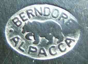

It is also known by the name 'alpaca'
"Alpacca" to be exact
