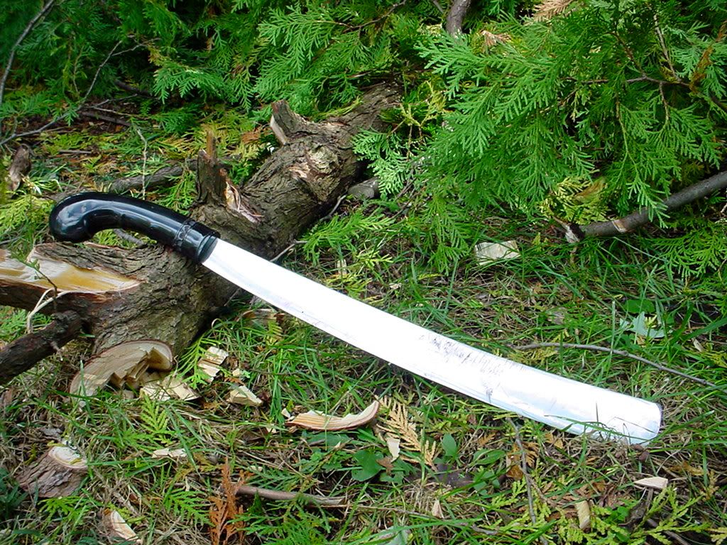

I have one of the Valiant Large Goloks. It came sharp and retained its edge after using it to hack down an arbor vitae in my yard.
Unfortunately, the horn handle has developed a crack, so I need to repair it before using it again.
I have been looking at a potong for quite some time but the cracking issue concerns me. How long did you have it, use it before them cracking developed. Do you think it would have cracked under the same circumstances if it would have had a one of there redwood handles? I ask because there is also another model I like too with redwood handles the jagal.
