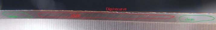

The pictures are going from the heel towards the tip, with the last picture giving an overall view where I marked the problematic area.
Well, I am at a loss. Am I somehow overworking the blade? I am using really light pressure and taking my time. The stone is not as rough as it was when it was new, so it definitely takes a while. I have a new coarse crystolon stone coming this weekend, so that will give me something new to try. Is the angle too acute for this sharpening process? Unless we can come up with a different possibility, I think my next test will be to up the angle a bit and try again.

The thing that continues to bug me, in looking at the pics (most apparent in the first two pics), is what still appears to be a hair-thin reflection of light along the edge, suggesting a long burr/wire edge or rolled edge. Not just where the deepest 'dents' are, but continuous. I'm using my browser to zoom in on the pics, and that little continuous glint of light steadily remains, through the length of the damaged-looking section. With chipping, I'd more expect to see sections of the edge crisply-apexed and sharp (looking more like the belly area of your edge, which looks good and crisp), intermittently interrupted by the gaps creating by steel chipping out.
Can you feel any steel folded to one side or the other, with your fingernail/thumbnail? Or does any of this steel come off, if lightly drawing the edge across the edge of your thumbnail? I'm trying to get some sense of how fragile these broken remnants are, which is why I ask. In the past, on some very softish blades (inexpensive kitchen stainless), I've created some large and very thin burrs that tended to break away in large pieces like you describe, even leaving little bits of it on my fingertips when feeling the edge.

Oh my blurry eyes ... look like you need to take away some more metal before the edge is free from factory over-grinded edge (or you dug one earlier).
Try again but first grind the apex away - with blade almost vertical (edge to spine) - until dip/recurve gone. And make sure the hole gone when re-establish the bevel, i.e. same scratch pattern/depth heel to tip on both side.

I am wondering if what you are seeing is me trying to get the light to reflect in such a way that I can get the camera to focus. Here are a couple of full size pictures where I angled the blade so that the light was shining down on top of the broken edge. I'll see if I can get some better ones once my camera battery recharges.

The edge of the knife looked great up until I went to remove the burr. The burr was maybe the thickness of a hair, just enough to catch the light or to easily feel when sliding my finger across it. The burr was also pretty consistent across the entire blade. When I started to do light spine-first strokes to remove the burr, I could see large pieces breaking off. At that point I did brush my thumb across the edge of the blade (not along it) and more pieces came off. That is when I moved to the fine stone to confirm my fears of what I was seeing. The burr came off normally, leaving a nice sharp edge everywhere except in that 1" section where larger pieces of the blade flaked off. So strange.

Looking at the knife from the side, there is definitely a slight dip in this section of the blade. Do I want to focus more on removing the excess blade at the back end of the blade (by the handle), or do I grind evenly on both sides of the dip until the area is flat? Maybe there is no real difference, I am just hoping to avoid doing any more unnecessary damage to this poor blade, and don't want to end up making an oddly shaped blade. I am still having a hard time fully understanding the affects a recurve has on sharpening on a flat stone (as well as how to remove an unintended one), so if anyone has any words of wisdom or links to tutorials, that would be greatly appreciated!
What is it about this dip that is causing this issue? The AUS-8 knife (SOG Twitch II) that I just had success sharpening does have a slight recurve in that same area, but that one sharpened nicely (though the recurve is still present). Thanks for the input, this definitely seems to be a factor here.

put the apex flat on stone surface (hence high points heel + otherside of dip), grind until no more light gap shown through. Ignore the hole on the bevel, that area edge bevel will be smaller/short/(sort-of micro) but will even out after a few sharpening.

If the recurve wasn't there to begin with, it means the handle is being dropped slightly as this region is being worked, and making contact with the rough edge of the stone - the opposite movement of raising the handle to hit the belly, but much more subtle. This is what I was getting at earlier.
If it came with a recurve it means the blade made poor contact or was stalled on a powered surface (grit wheel from a paper wheel set-up or a hard platen backed belt sander) and might have effected the HT right there. Having the recurve will also prevent the edge from making good contact with a nice flat stone like your India when being resharpened and will cause issues with putting on a nice edge.

My guess right now is that there is some issue with this coarse stone (or stone/steel combo). I ground the heel down using near perpendicular passes until I had removed the recurve, then decided to give it another try. After a good 2 hours, I still had not yet brought back a sharp edge to the heel section and was starting to get small chipping along the belly. My guess is that given the time I have to spend on this stone, the thin sections of the blade are somehow getting overworked and end up getting brittle. The blade gets a surprisingly shiny finish while on this coarse stone and then just does not seem to cut. When I thought the blade was close enough, I switched to the fine India stone, lightly removed the chipped section on the belly, then continued with the entire blade. At some point I decided to see how it would be going back to the coarse stone. I ran the blade across it 5 or 6 times and took a look, and could not see any new coarse marks on it. That tells me that there is something up with the coarse stone.
At this point I think I will wait until the Crystolon stone arrives and then start fresh with this knife. If I could set a nice even coarse scratch pattern in a reasonable time and move on to the next stone, I think it would be fine.
