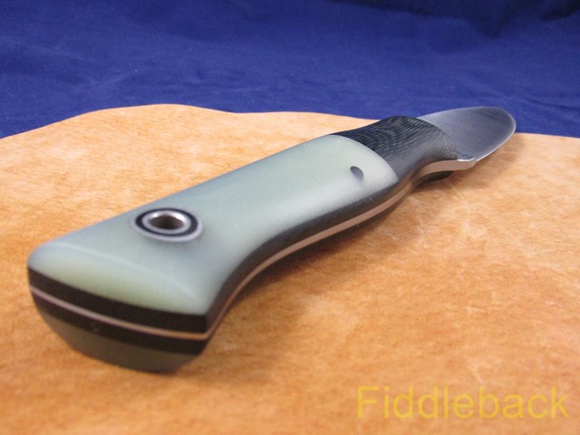

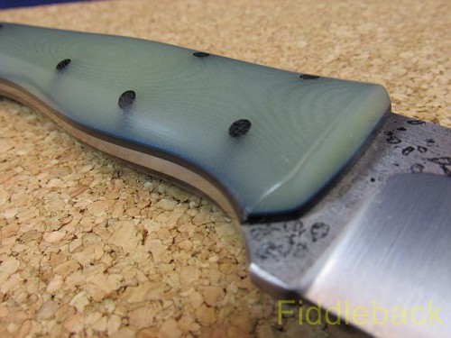

I like using liners to change the tone of the translucent jade.
Jade on white (I call this Doublemint):
Jade on orange (Orangeburst):
Jade on blue (Blueberry):
Jade on green (Margarita):
(Tease the names if you want to, naming everything you do is a secret to selling knives I learned from watching Jerry Busse.)
That is pretty slick, how thick are the jade scales to get that effect with the liners? Hard to tell the size but going to guess close to 1/8 at spots? I love the Orange Burst and Margarita. Fiddle do you mind if I borrow that Margarita color?
Whats neato is that all of the above jade was cut off of the same sheet. The differences are 100% liner (I call the middle liner there a pinstripe). I use 1/4" scale material over a colored liner that varies in size. Meaning that the jade was from a 1/4" thick sheet.
