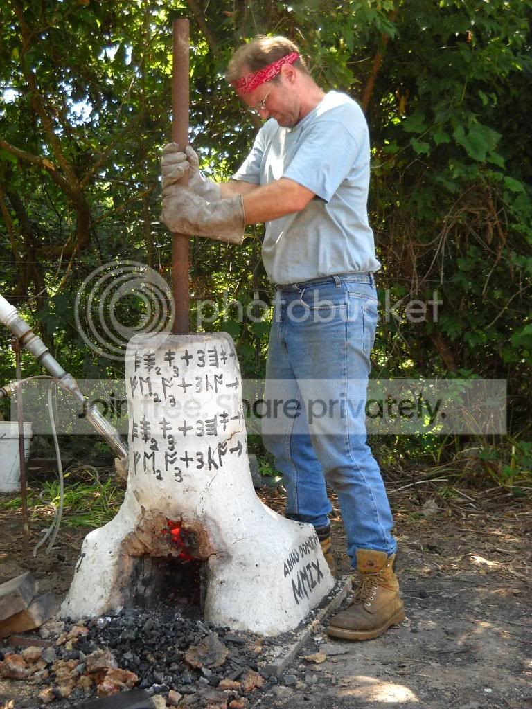

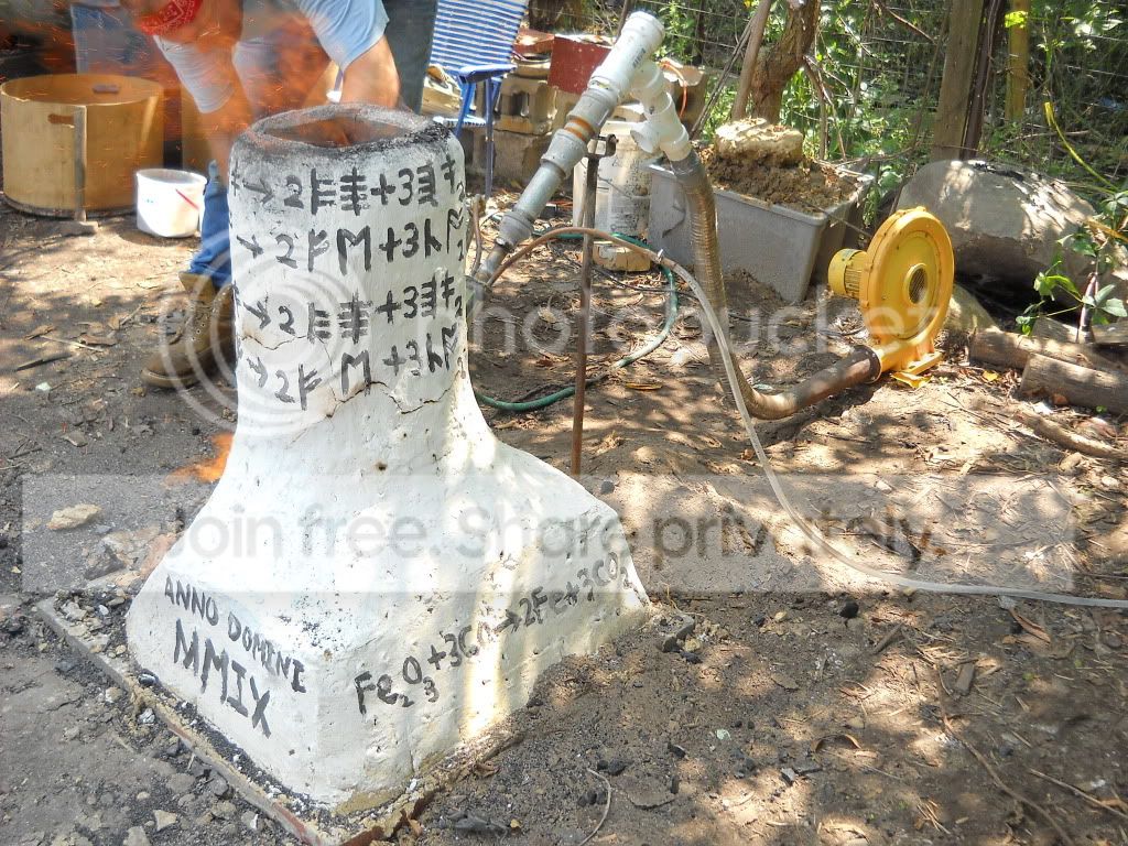

The Ferrite Phantom:
A backyard scale smelter
Notice the blower has a observation port and a water cooled tip

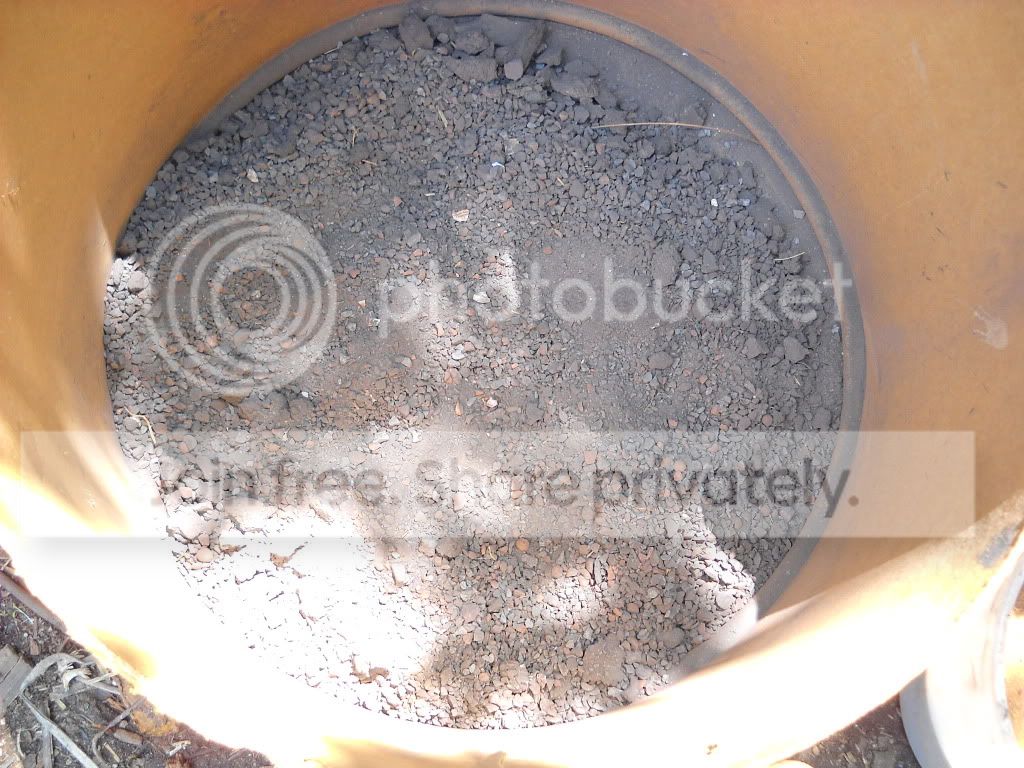

The magic dirt

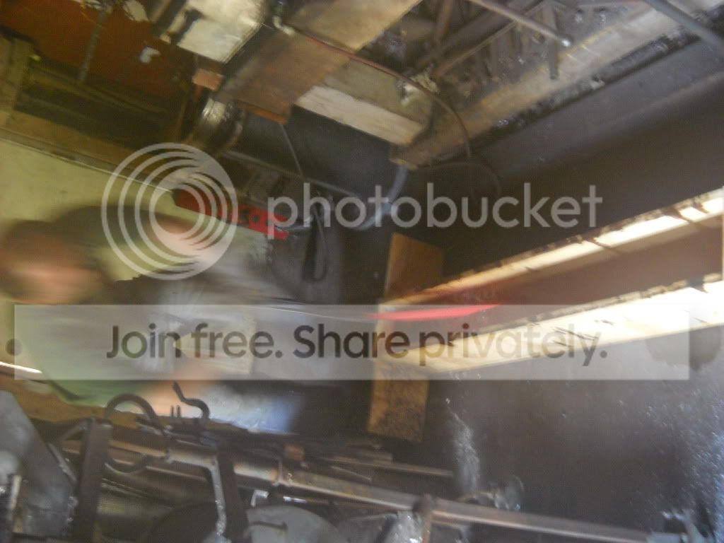

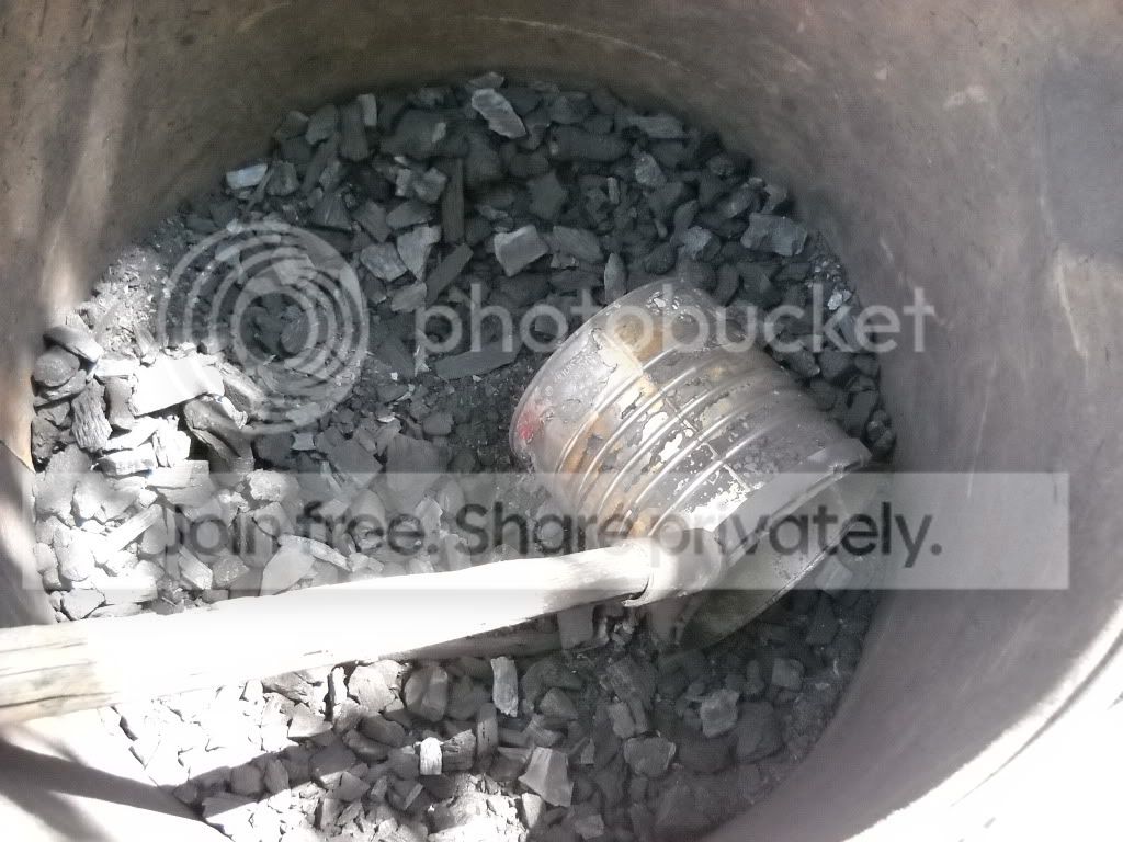

Charcoal, the fuel and carbon source
A look down the peephole mounted on the blower inlet

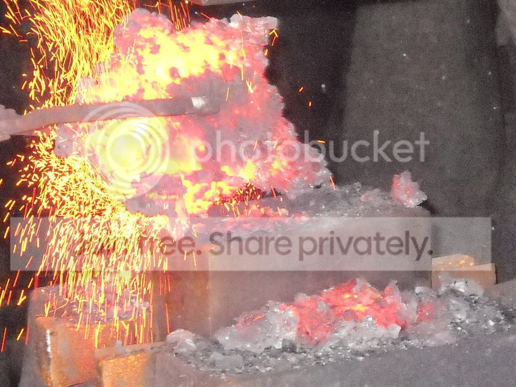

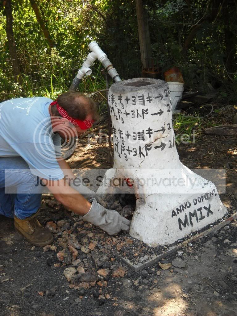

Kevin pounding the the steel "bloom" to the bottom of the smelter

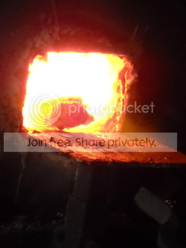

Here he is removing the steel from the bottom of the smelter

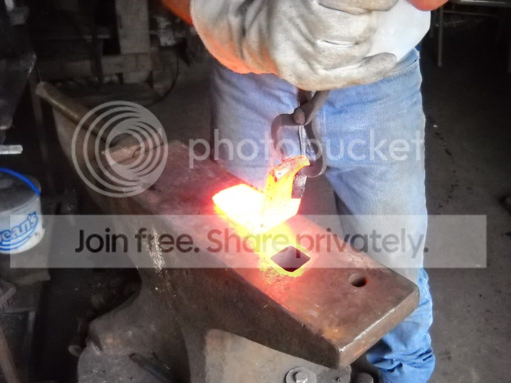

The fresh, hot bloom getting its first whacks in the power hammer
Reheat in the forge
Consolidating and folding to make it consistent throughout

How about adding a few words of description so us unfortunates will have a better understanding of what is being done? I don't think we have any dirt like that around here.
Done.
It took perhaps six hours of adding the iron rich "dirt" and charcoal to the top of the chimney They began another "run" to make sure there was enough to make a sword. Note the smelter survived and was immediately put back into service.
The main thing I took away from this was that making steel is very approachable goal for the properly motivated.
I hope to see more attempts at this happen. It was labor intensive, but not too bad for the well prepared. Of course, Keven ran amok like the proverbial madman with a plan.

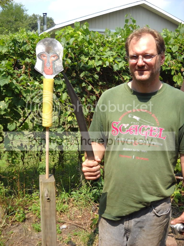

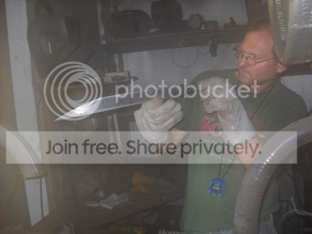

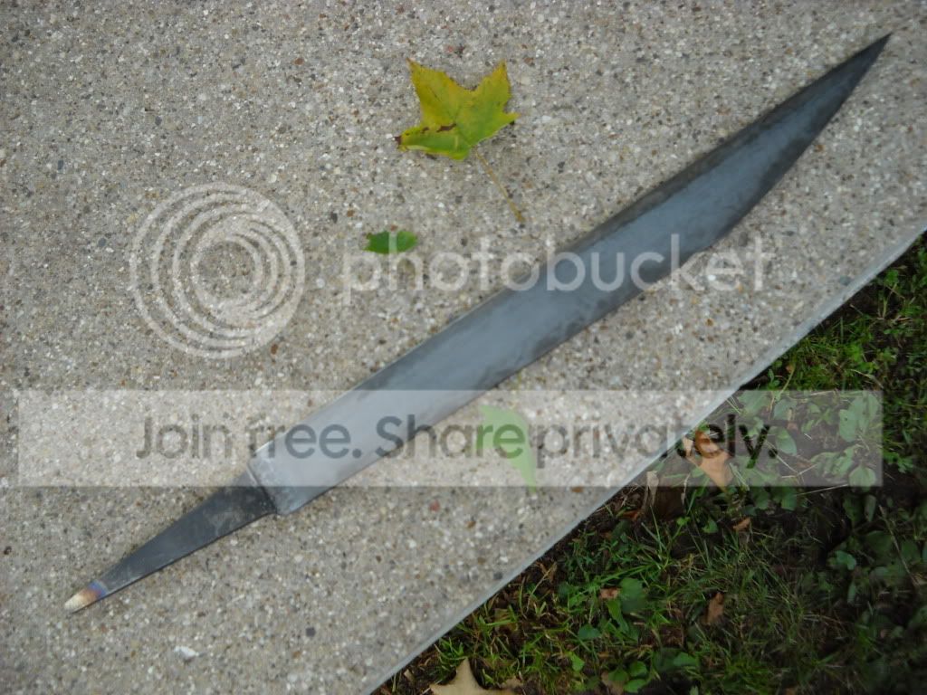

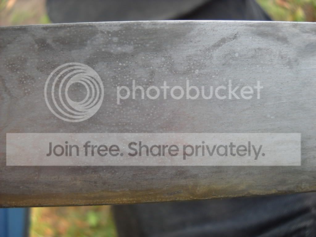

I made it back today for the heat treat to test portion of events.
Hopefully someone got some pics of yesterdays events.
Into the quench
Inspection

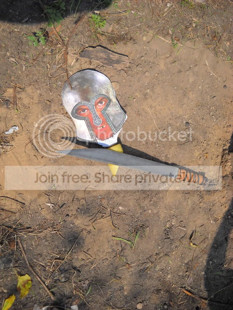

The Mighty Tool
Close up
Kevin wielding the mighty tool
Nasticles has fallen!
