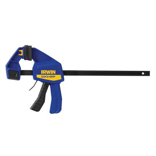

This doesn't apply on yours, but you can test "spring pressure issues" easily if you have a longer tool arm. My arm is 24" and extends out the back just touching the spring. If I have a fresh and very stiff belt on (that needs more spring), I take a cheap woodworking slide clamp, the one you have a squeeze handle on, and clamp it between the bottom edge of the tooling arm and the top of the tension arm where the spring attaches. I can gently squeeze the handle to apply more pressure and help straighten out a fresh coarse belt until it breaks in.
I use one of these:
I know it doesn't apply here, but something some others may be able to test in a pinch.
