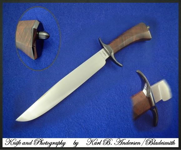

I got a really choice piece of Gidgee from Down Under and mated it with a forged 5160 Bowie Blade about 10 1/4" inches long.
Differential heat treatment on this blade.
The multi-faceted and hot-blued fittings are mild steel.
Handle, of course, faceted to mate the hardware pieces.
Take-down assembly completes this package.
15 1/2" overall.
(Look for this in Atlanta!)
Very nice piece Karl. The handle design and guard brings to mind Rob Hundson's exceedingly elegant bowies. Nice to see a full size bowie from you.

Lovely. I agree with the Robb Hudson visual lineage.
If I may, a few things that would make this piece even more attractive:
- Guard branches that don't curve back.
- Spacers between the ood and the hardware.
- Slightly smaller blade.

I would recommend that you take that knife apart, especially if it has steel to steel threaded parts! You don't want them rusting together! I use about a 50/50 mix of mild steel and sometimes stainless, but the tang is always non-stainless - in my knives - as it is the blade steel. It will rust if not maintained.
I put a small drop of gun oil into the pommel nut, and they are good to go.
I also use a lot of hot-bluing in my knives, so I like to have the option of re-bluing down the road if necessary.
I like having the option of backing off the tension on the knife and letting the handle material move if it wants to while in long term storage.
I find a great deal of advantages to the take-down assembly.
