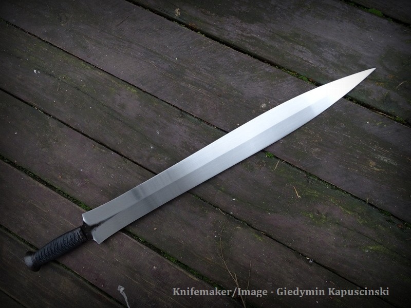

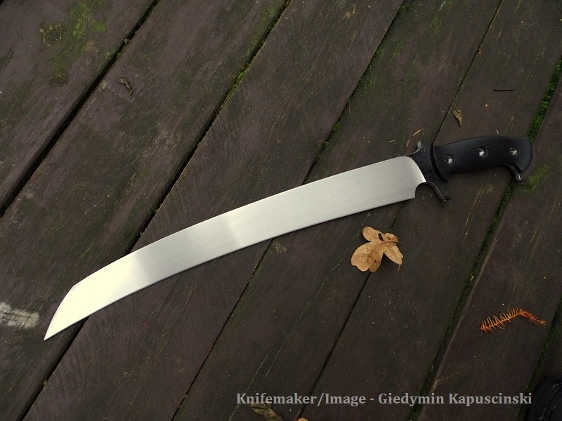

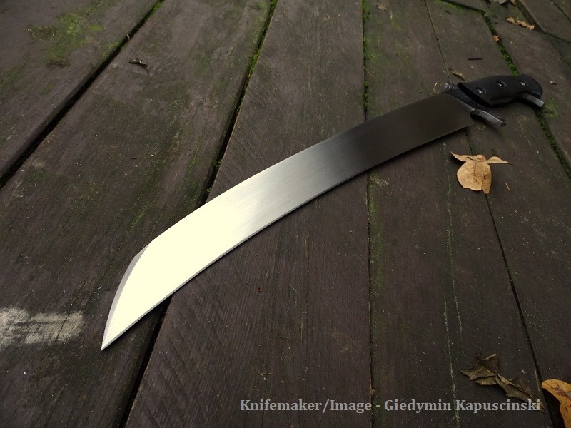

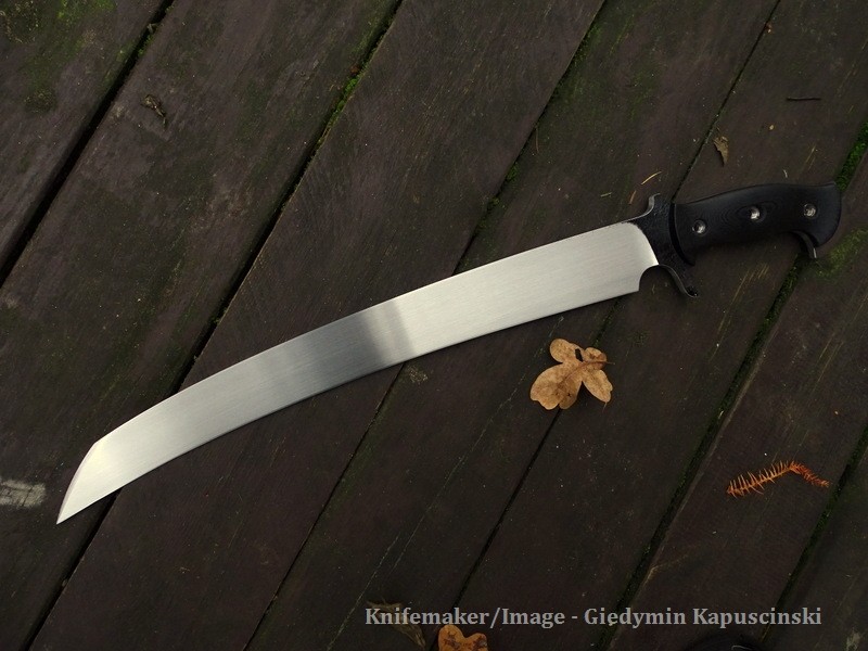

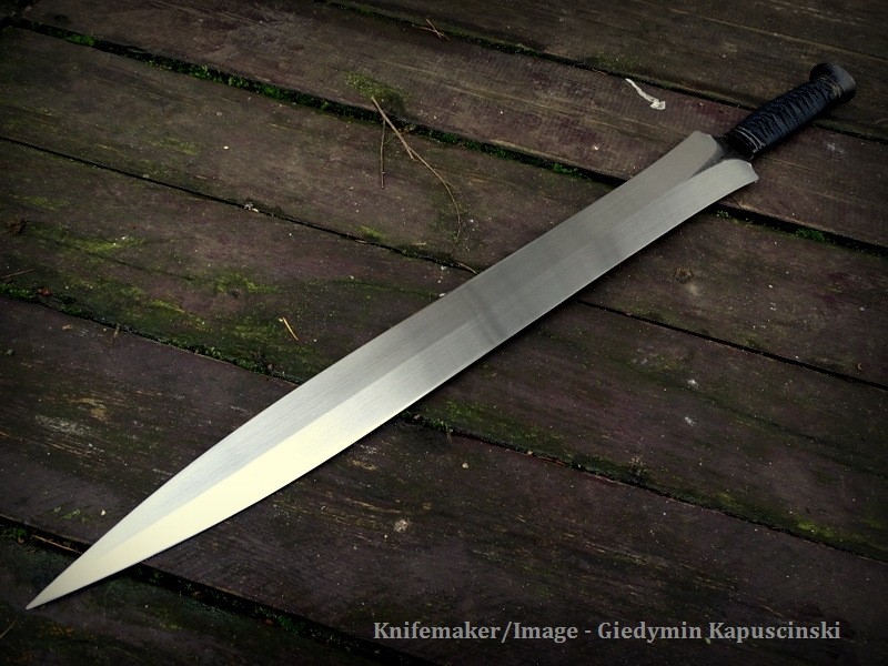

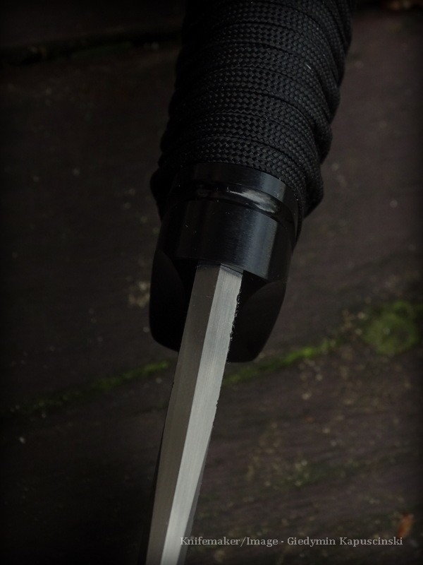

Steel/thickness: NZ3/7mm - ~S1/0.275"
Blade length/ Overall lengthi: 45/60cm - 18.000/24.000"
Handle materials: vulcanized fiber/Black G10
Blade finish/handle finish: Hand rubbed 600 satin finish/800 satin finish
Weight: 990g - 35.000oz

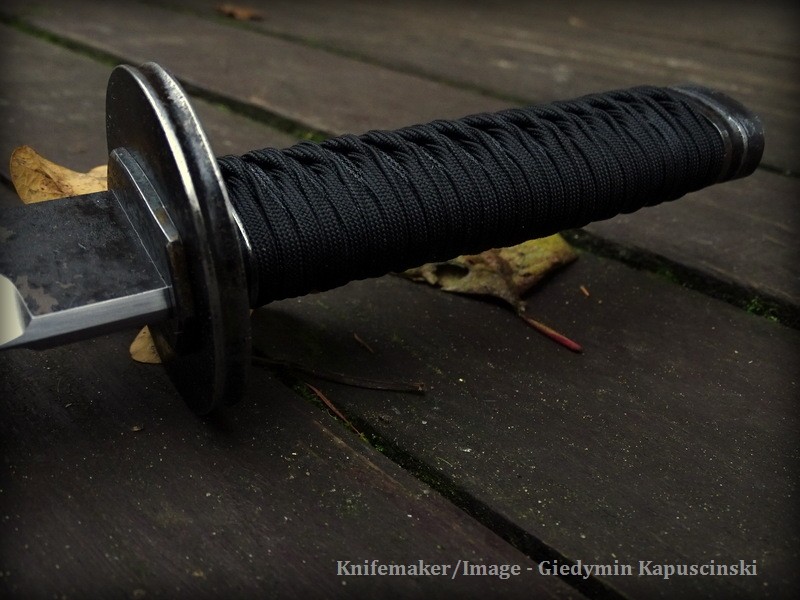

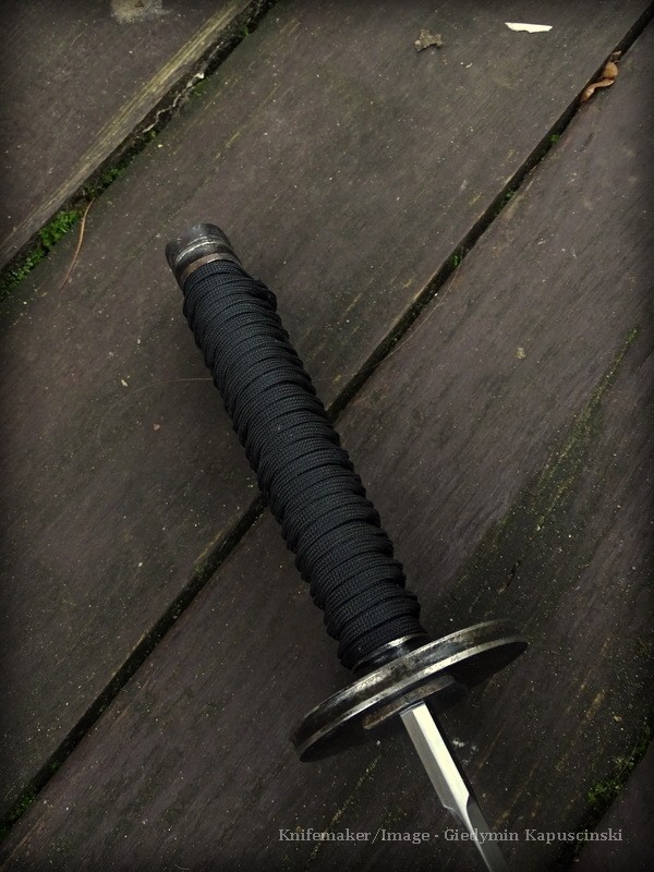

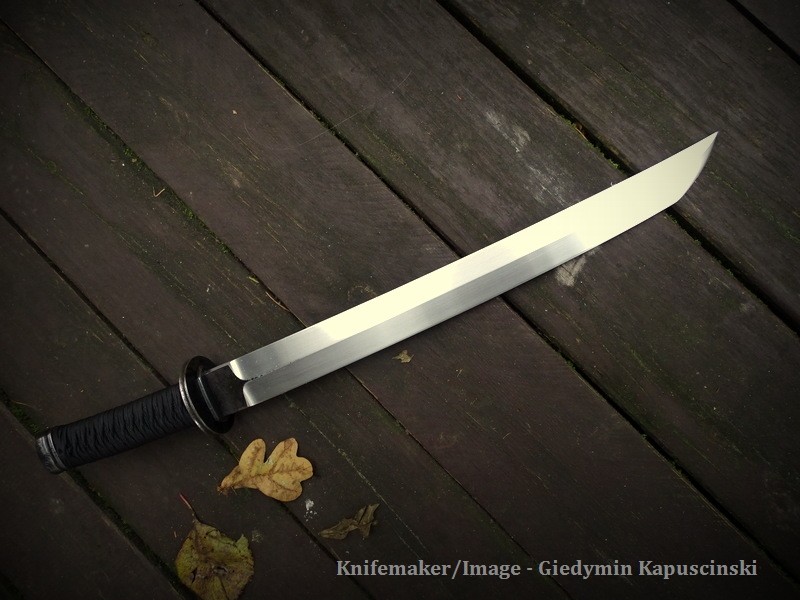

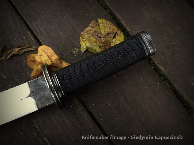

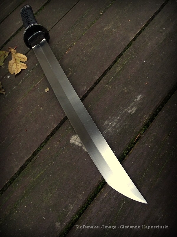

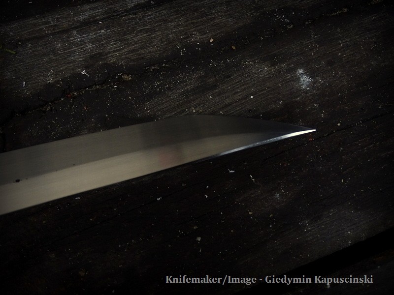

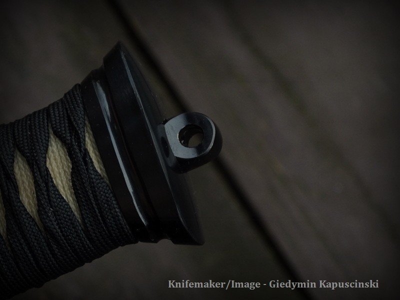

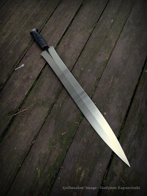

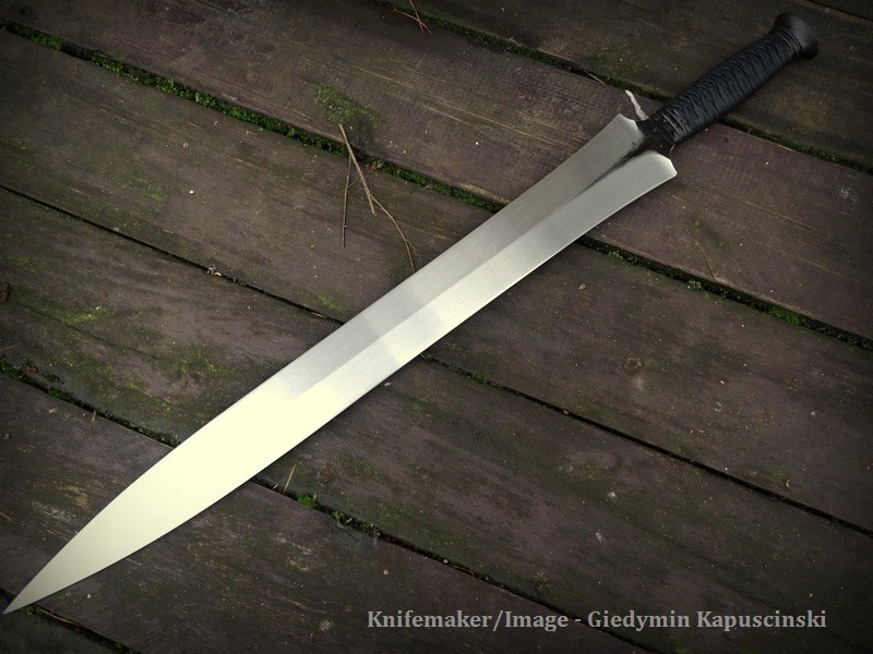

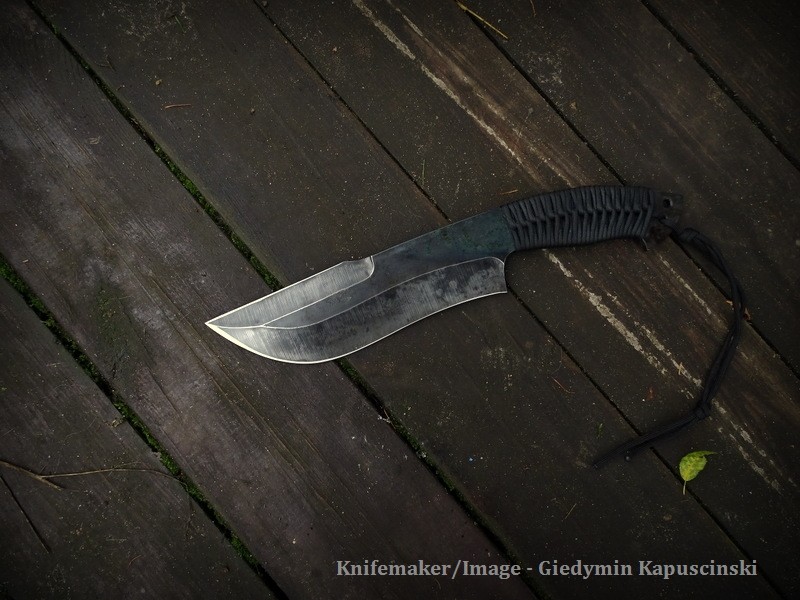

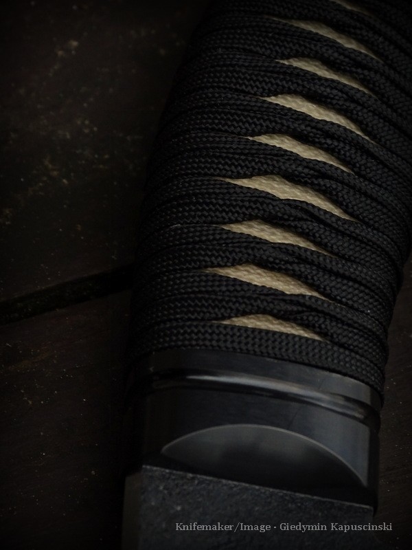

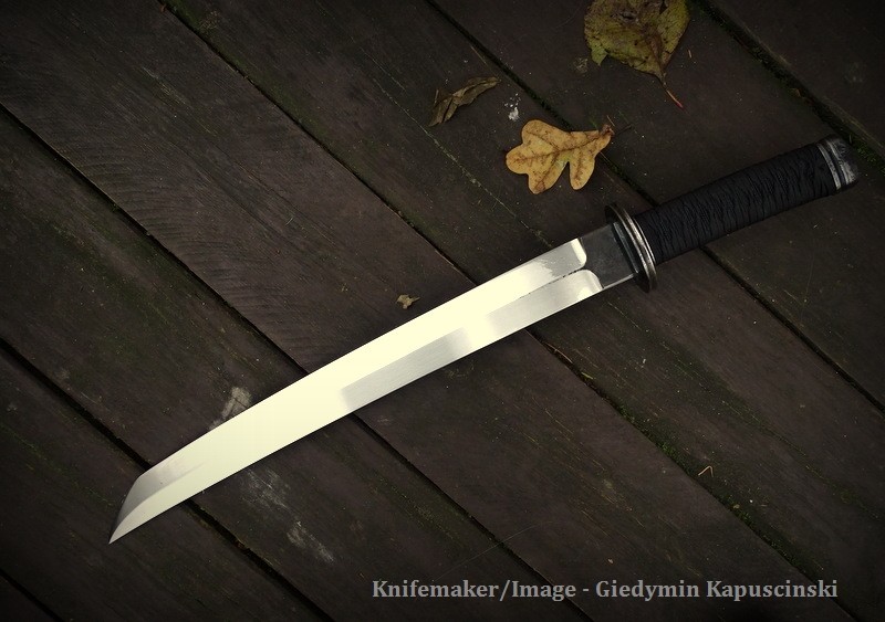

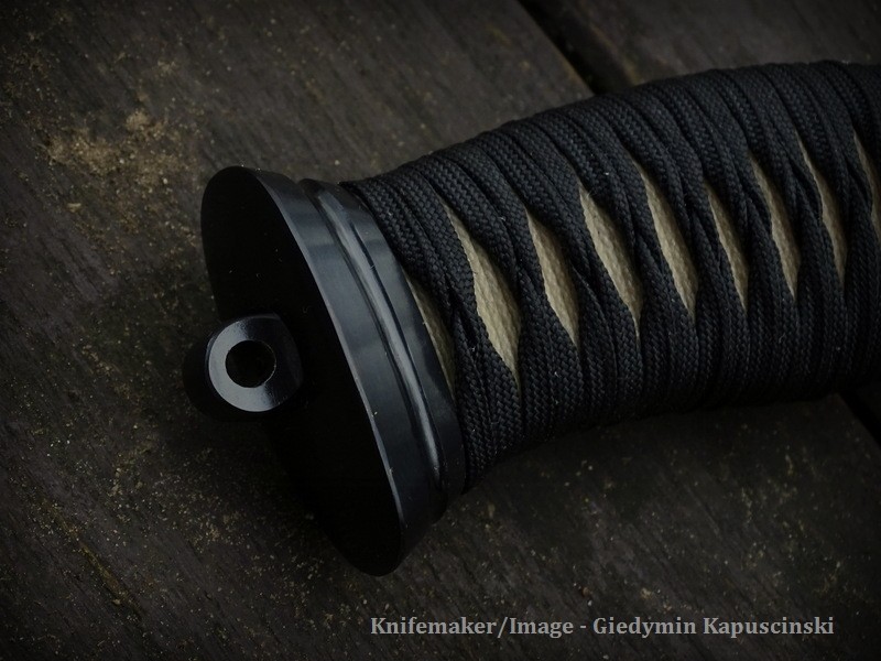

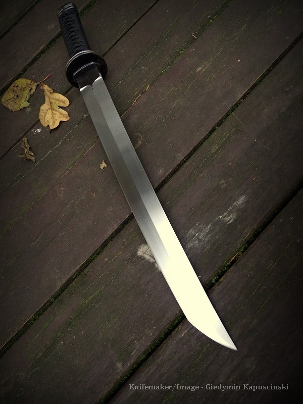

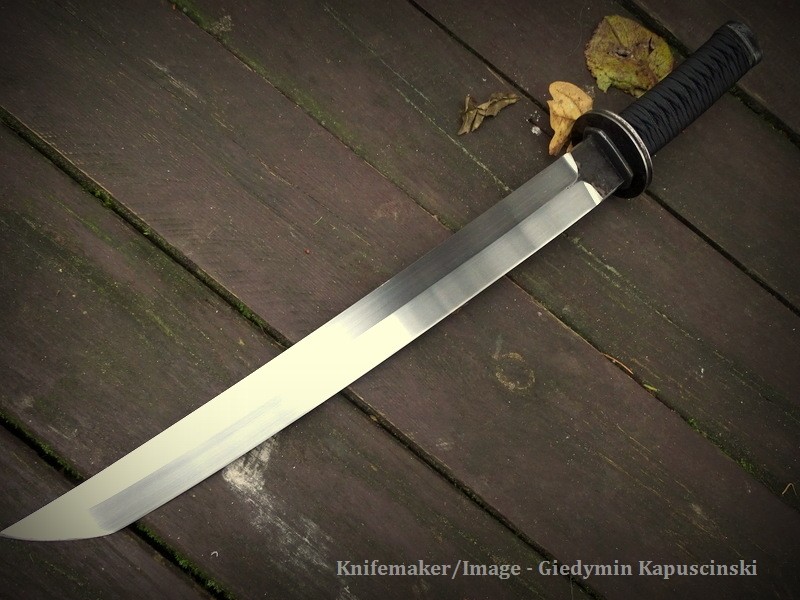

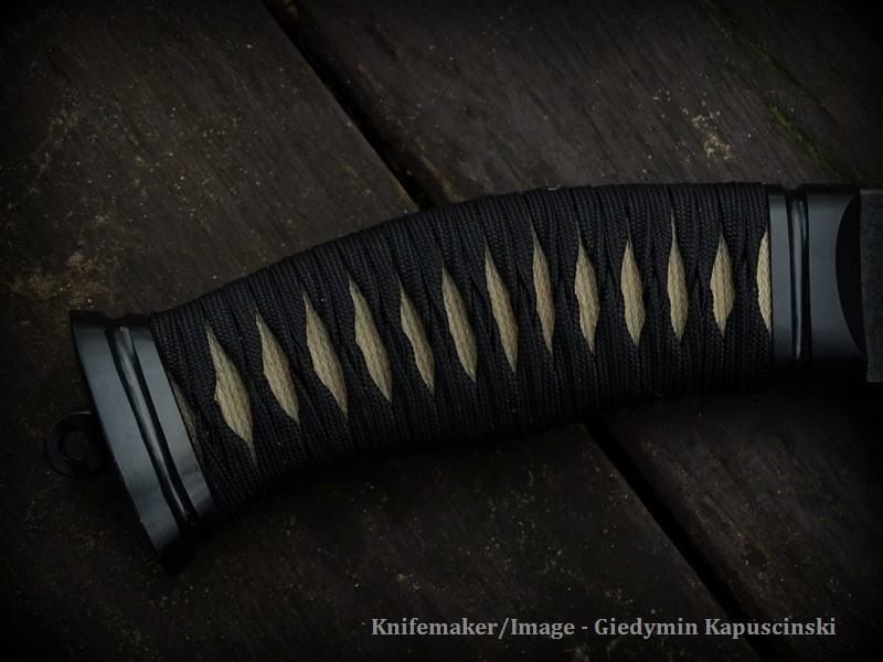

Name: Dark Samurai - Ronin Series Wakizashi
Steel/thickness: 50HF/6mm - ~6150/0.250"
Blade length/ Overall lengthi: 40/56cm - 16.000/22.200"
Handle materials: Mild steel/ash/Black Micro cord underwrap/Black Paracord primary wrap.
Blade finish/handle finish: Hand rubbed 1000 satin finish/aged
Weight: 780g - 28.000oz

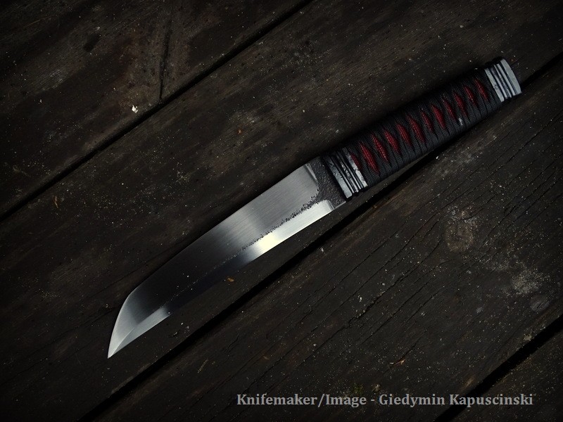

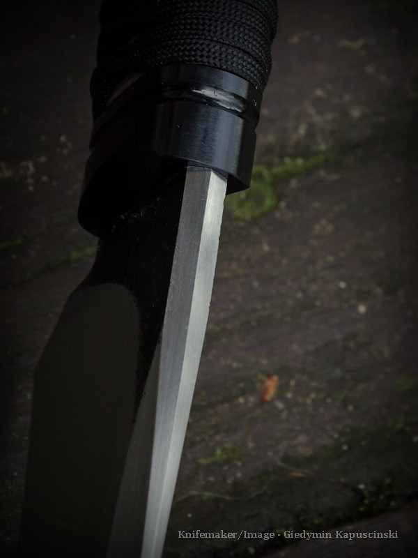

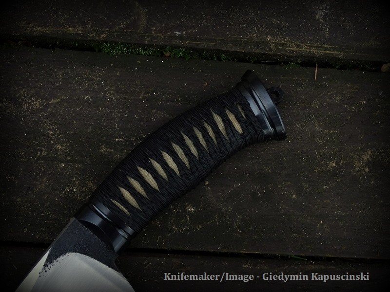

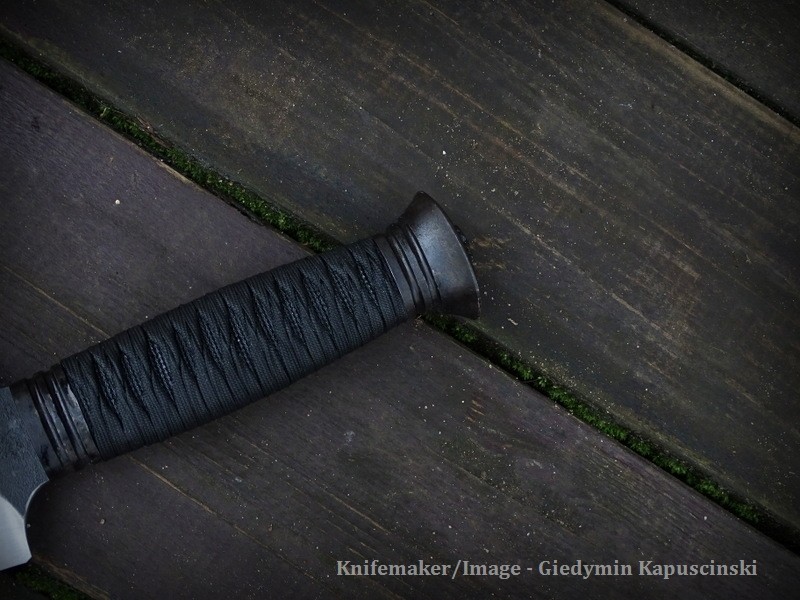

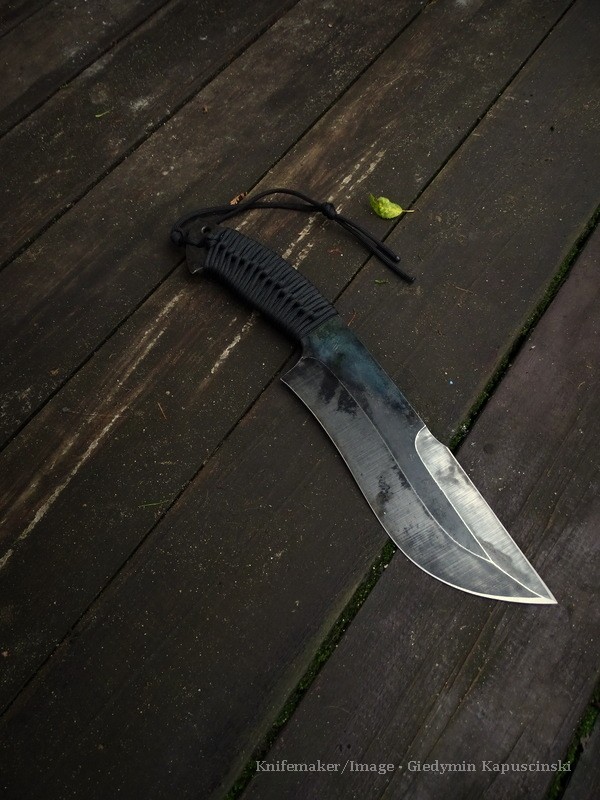

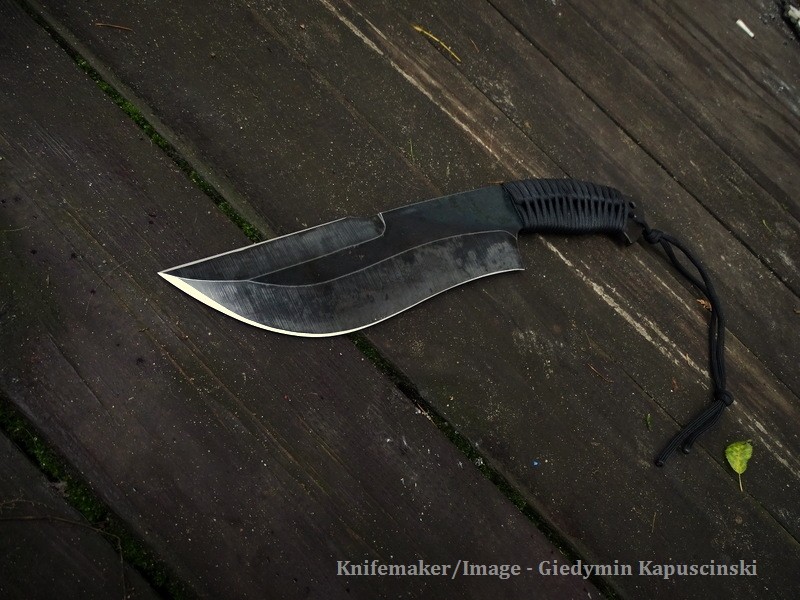

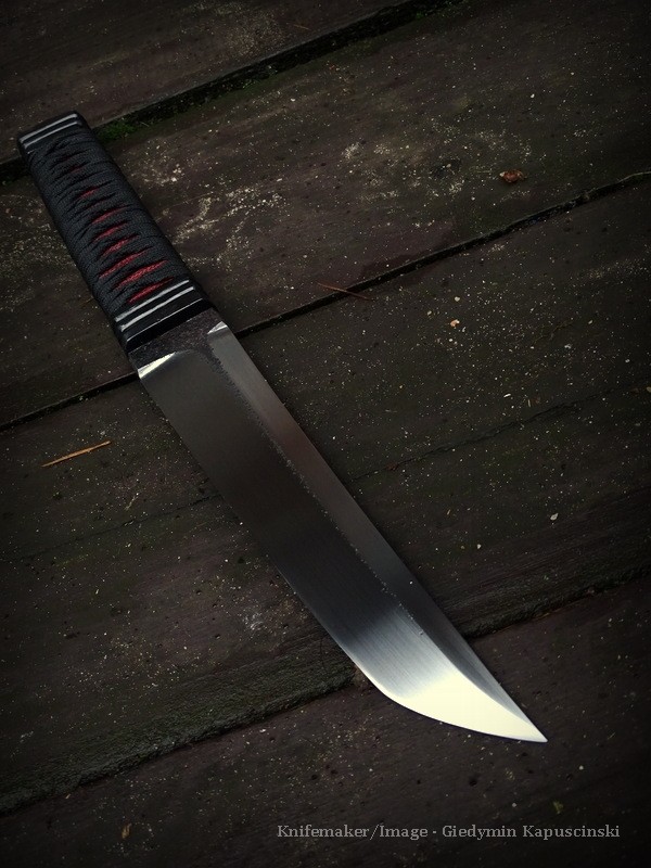

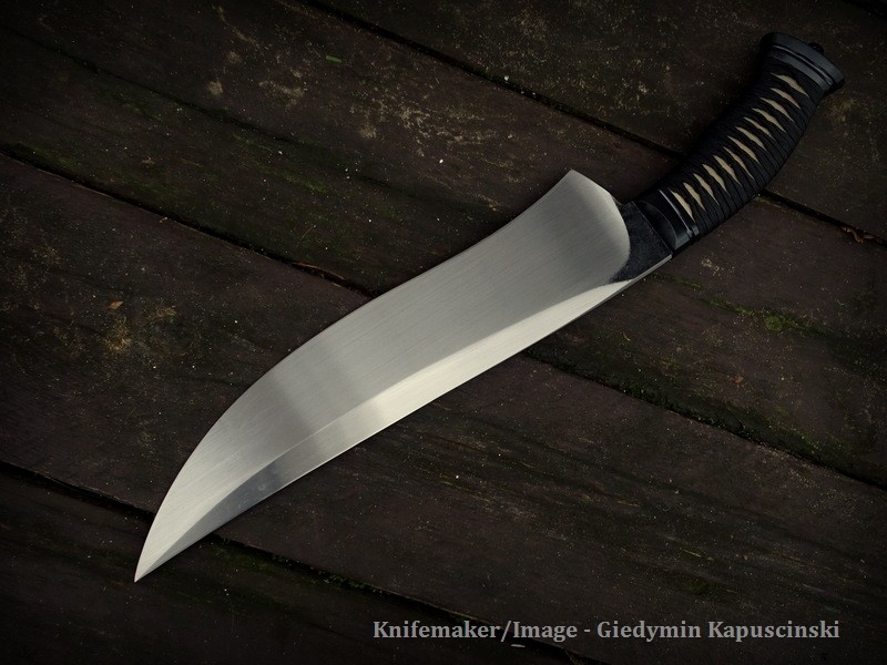

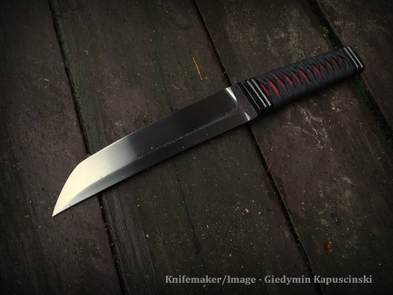

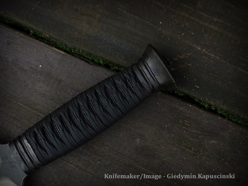

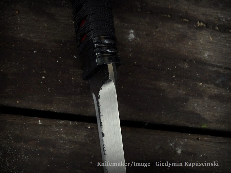

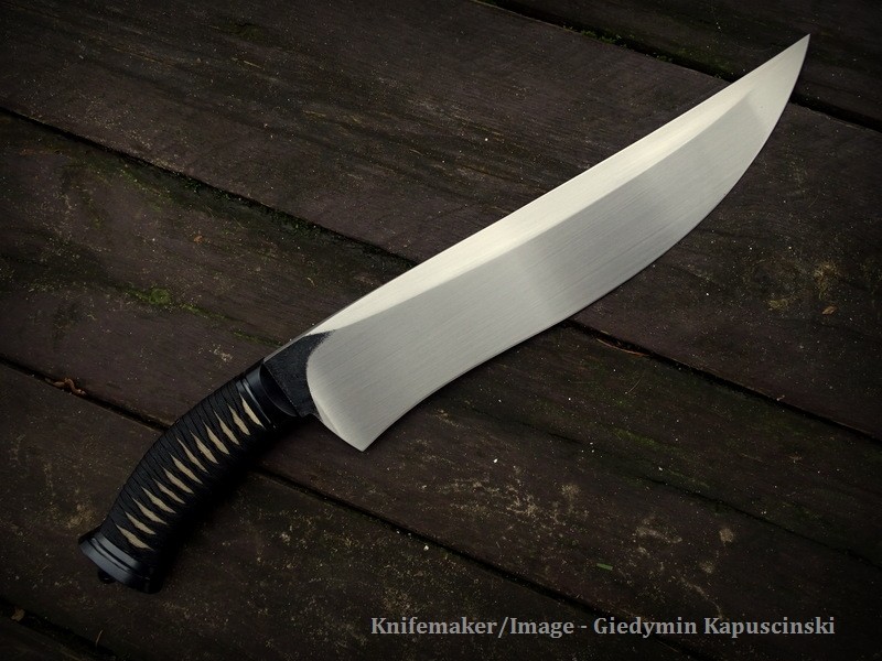

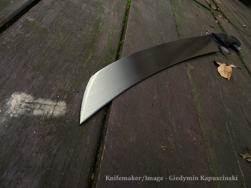

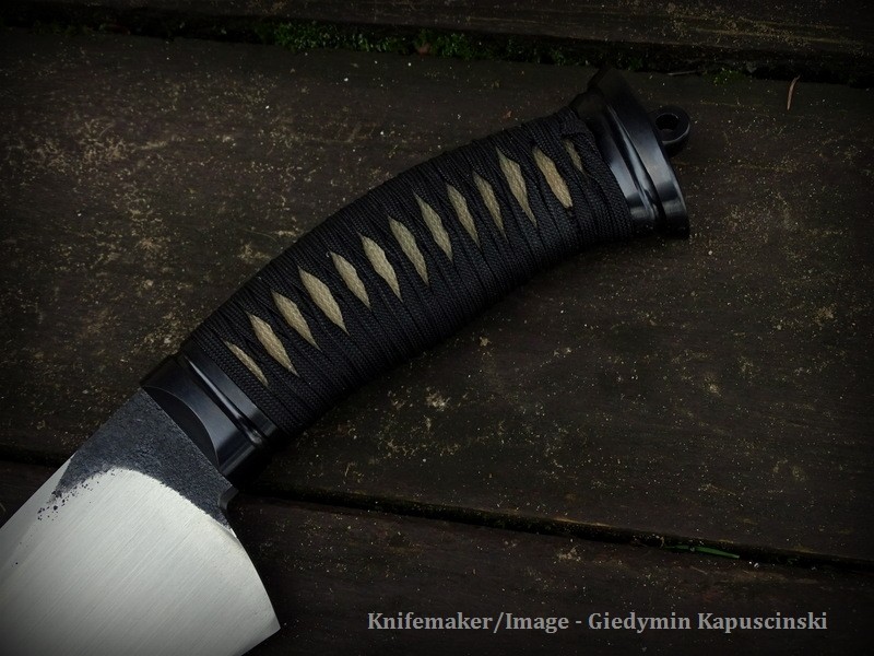

Name: Dark Viper - Ronin Series
Blade length/ Overall lengthi: 27,5/42,5cm - 11.000/17.000"
Handle materials: Mild steel - hot blued, ash wood, Cream Micro cord under wrap/ Black Paracord 550 primary wrap, stabilized with epoxy resin
Blade finish/handle finish: 600 satin finish/hot blued
Weight: 600g
Others: False edge sharp

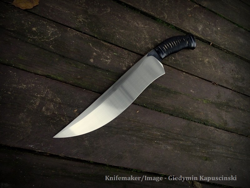

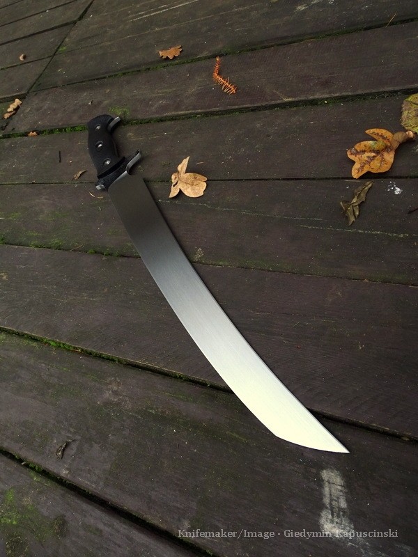

a few recent blades:
