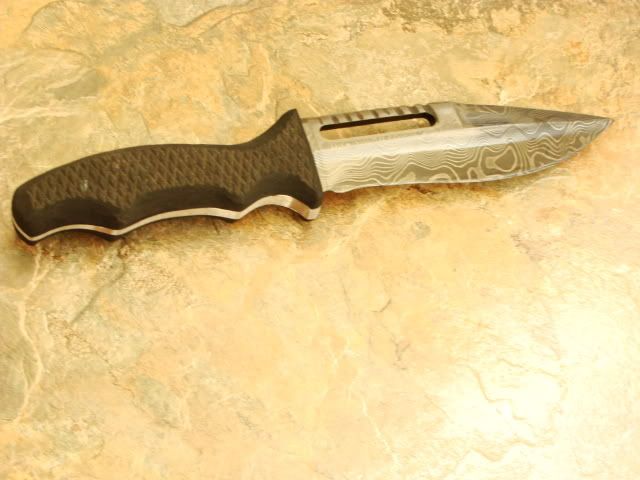

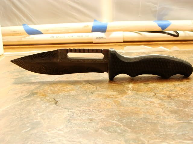

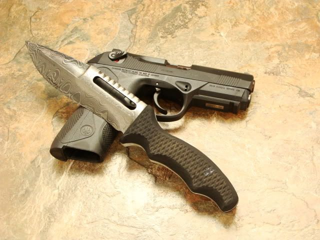

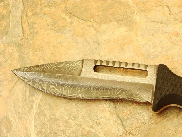

I have a friend who's a COP in Washington State "yes i do have friends" known this guy for 42 years went in the army together jumped out of helo's together
even had the same girlfriends at derf. points in life ok to much info.!!! HA HA HA LOL he wanted a knife that had a rubber handle no longer than 6 1/2 blade that he could use for when he's tracking bad guys in the woods of washington. and he wanted it in two weeks .so made some steel and forged this out for him . its about 80 layers of 1095 and L6 saw blade ,its hollow ground sweage is hollow ground blade is 6 1/2" long, over all is 11 1/2" ,handle is horse mat rubber ,got some glue on the side that you can't get off without messing up the grip dang it, he wont mined glad i wasnt trying to sell it .HA HA he has a sheath for it he says ,i also darkened the tang edge after i took the pic's.so off it goes to get bad guys .tell me what you think !!!!
