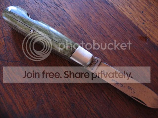

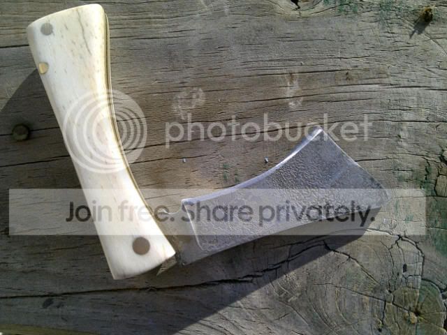

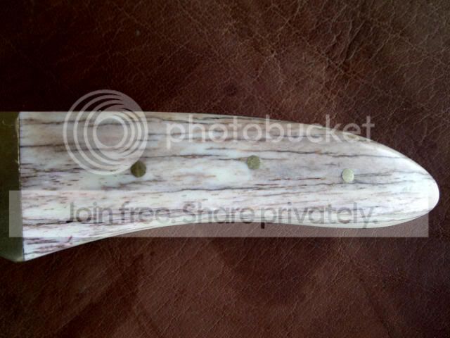

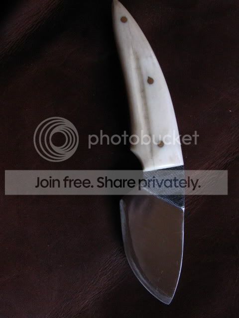

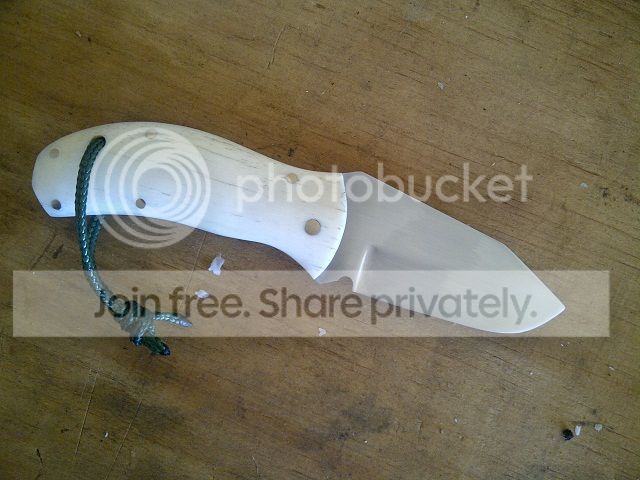

It is good stuff - I don't know if it is the hardest bone in the world but it is pretty tough - you can imagine the tensile strength needed to support a 2 metric ton body - a big bull will weigh up to 4500 pounds. You can do all sorts of things with the coloration - and get it to look pretty close to mammoth ivory too! It makes a very nice, very good handle - but it does take some preparation - you need to remove the fat and marrow from the bone before you can color and I like to stabilize it too. I have never tried carving it but shaping it on the sanders is not difficult at all. I think the reason for the expense is that the material itself is relatively expensive and you have quite a bit of waste when working it.
Here's a few different effects:
