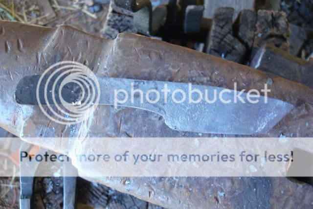

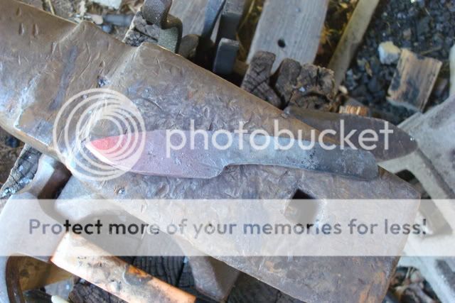

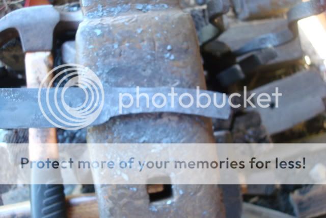

4'x1"x1/8" bar of 1080 (it's so purty!)
Hot works best
getting a handle

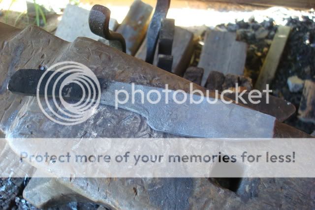

Marked!

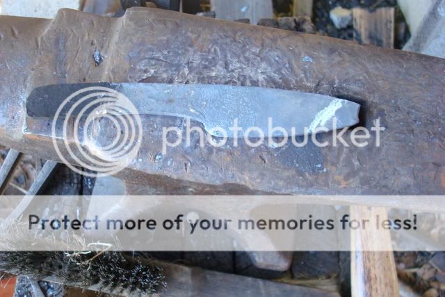

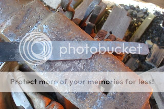

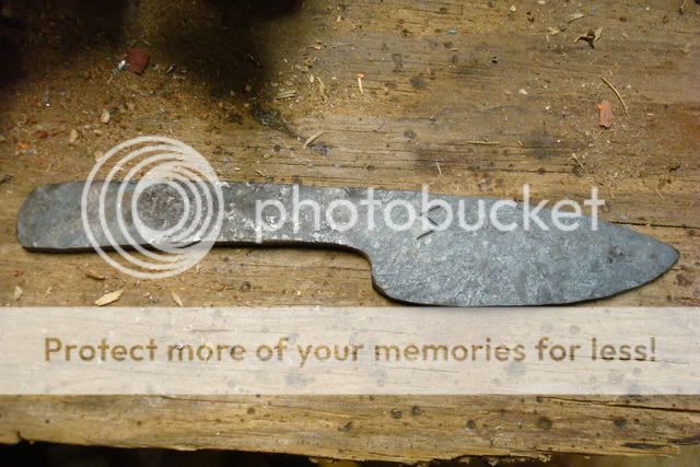

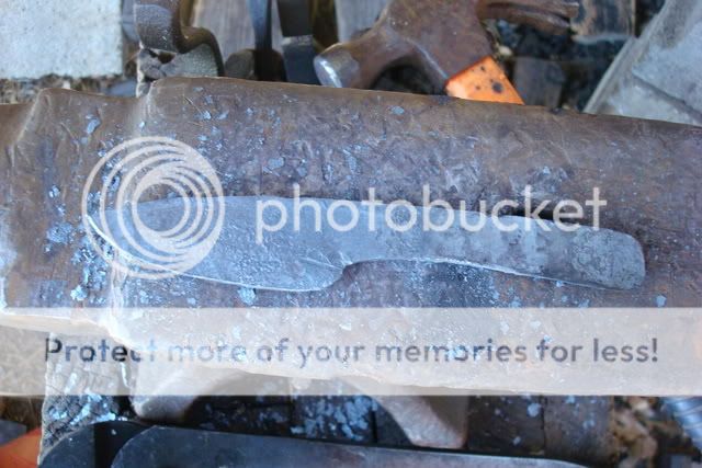

It's shorter
get the point?

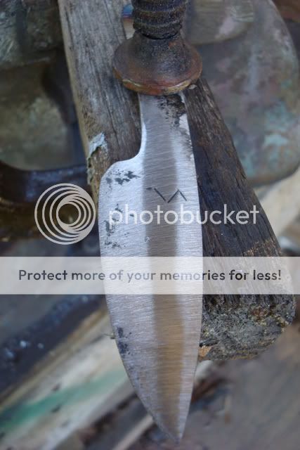

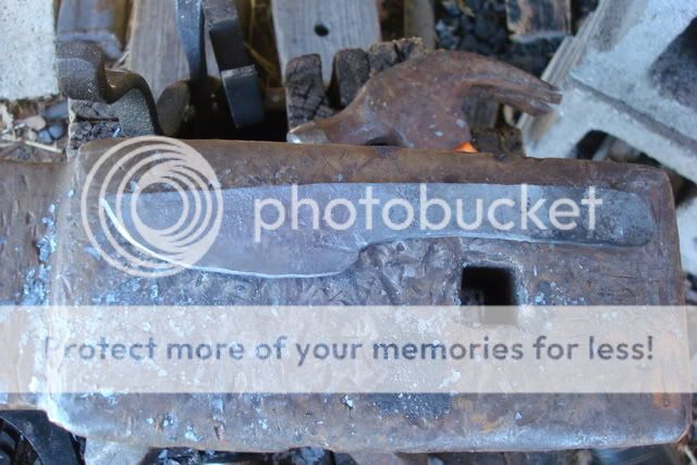

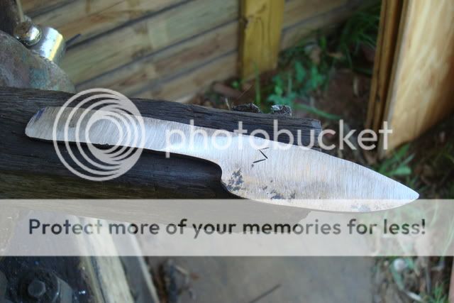

After forgin the bevels, personally I like this shape, but sissy said no.
So we give a spearpoint.

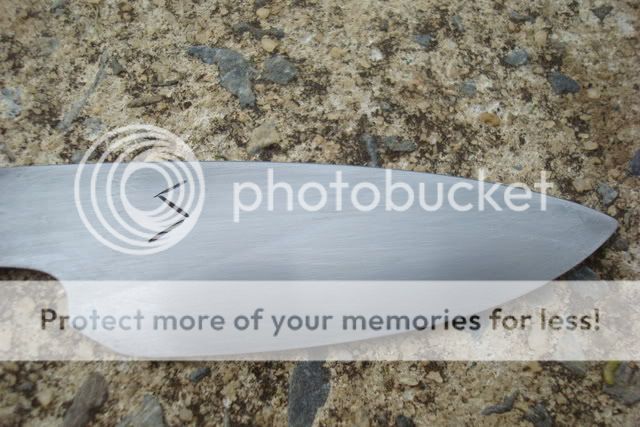

(little chisel for cutting in my makers mark)
This is to show that the 1080 has been tested and approved by the new shop assistant, Boots.

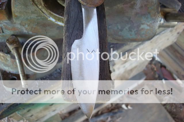

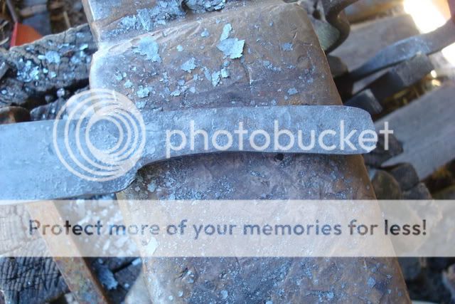

If you look at the area on the handle right before the blade, I don't like that transition, not very good looking. So, let's clean it up with the bench grinder.
That's better

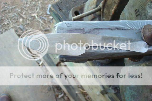

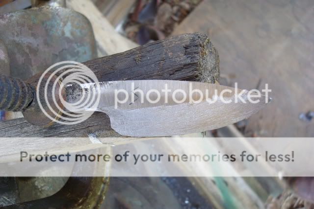

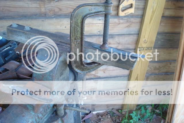

Clamped in the super special custom made clamping rig that I made :D
Go ahead and start cleaning it up with a 36 grit flapwheel in an angle grinder
Hit the blade (we'll hit the bevel better later). Flip it over and hit the other side (no pics)
Clean up the spine and edge, and handle.
That's better

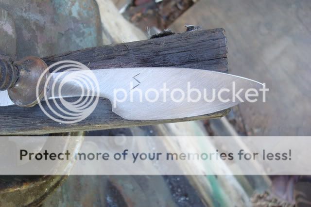

Now to bevel
That's a bevel. Other side too (no pics)

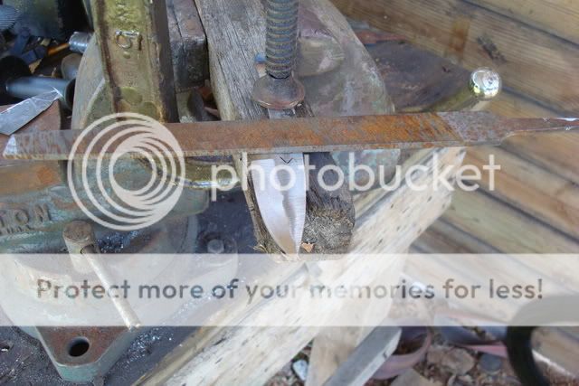

Filing time!

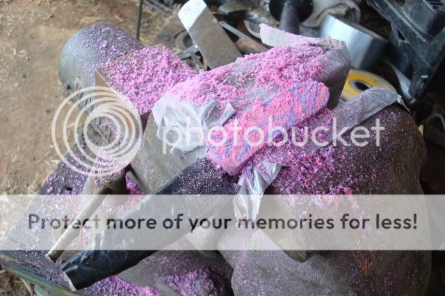

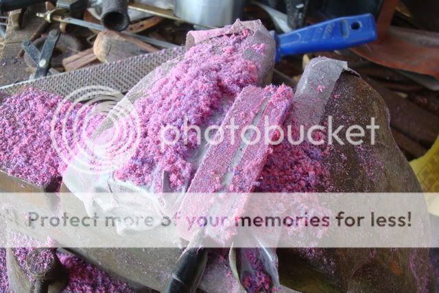

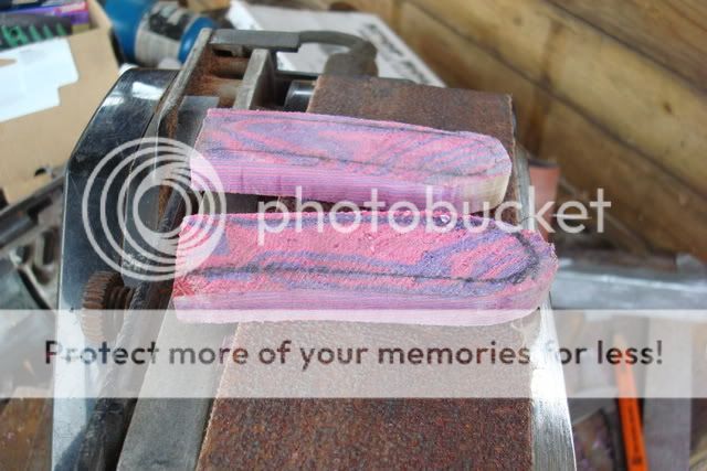

beginning prep work on the micarta
As you can see I cut out all the places that weren't solid cloth.
Gotta get it all kind of flat
Cutting it. As you can see I clamped it hanging off of my clamping jig. in that position I was able to cut the marked section with a jigsaw.

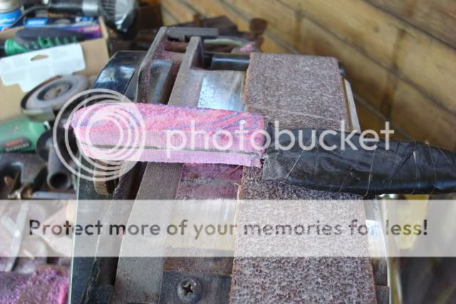

The cut out blanks, you can see I cut extra around where I marked the lines. The sander is set up to flatten them better. (the good thing about this sander is that the wide belt and large platen are good for flatting things like this).

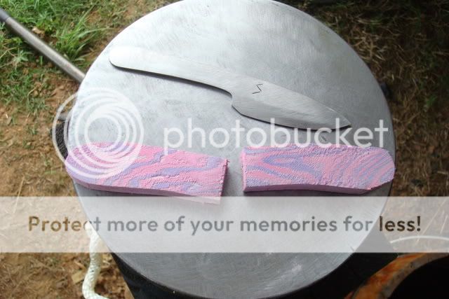

Flattened scales with the knife.

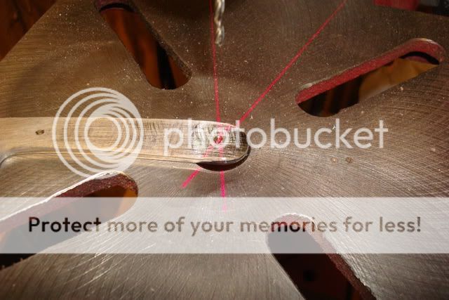

Drilling (use a cutting oil for longer bit life)
It's a holy knife! Ok... I'm not funny, I'll quit the jokes.

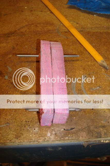

The scales drilled (holes do correspond with the ones in the knife) and held together

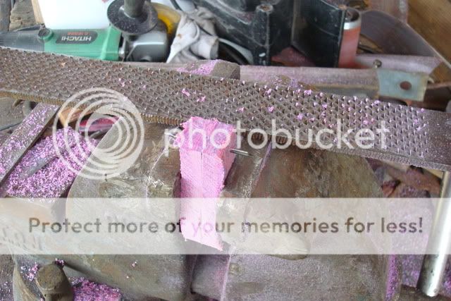

with some 3/32" rod. Ready to start shaping the front.
That rasp I'm using is actually a horse hoof rasp. It hogs off wood or micara like nothing.

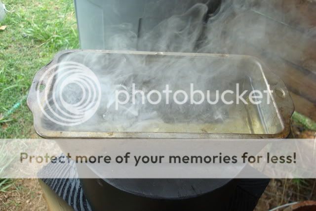

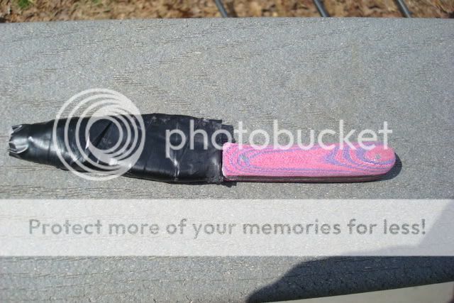

While shaping; the knife was cooling from normalization heats

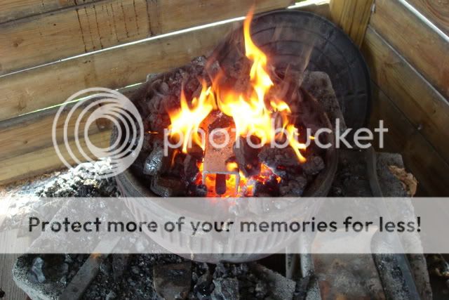

Heating for next normaalization. My method of heating is to stick that square tube in the fire, turn on the blast and heat the whole thing. Then turn it off and stick the knife in. That let's it soak up the heat slowly. And it creates very little scale.
Preheating oil
hot oil
Quenched

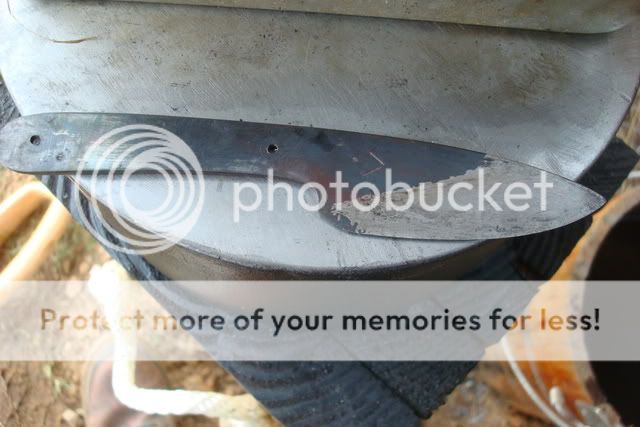

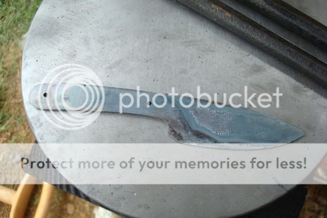

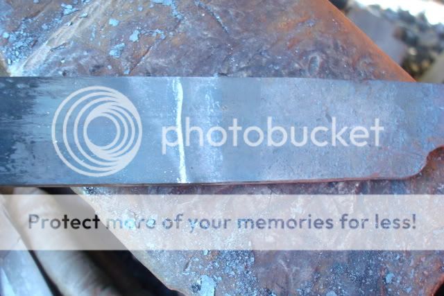

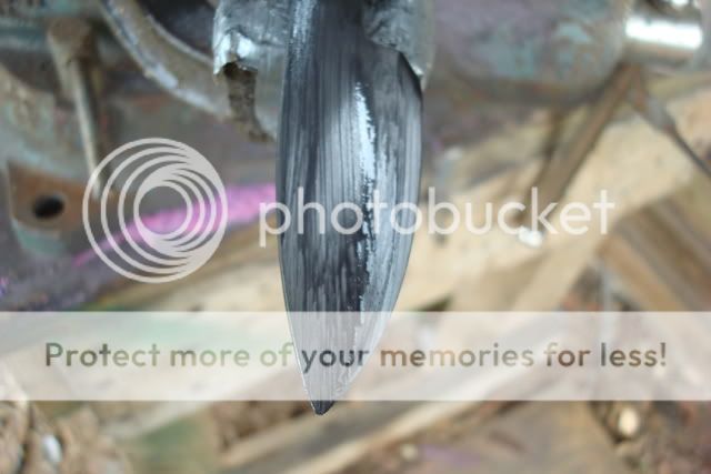

Test etch!
I went ahead and sanded it to 220 grit, and then decided I wanted to see the quench line. It's only a rudimentery etch, I hope to make it pop better after being done better.
This is my school desk, also, it's my finishing area. For doing things like this, etching and such. (yeah, it's messy too)
The knife sanded to 220
My old diluted ferric. I think I'll refresh it soon. That day long etch for the wrought chunk seems to have weakened it or something.
After etch, pre oxide removal
The photos are after removing oxides with a thumb and paste polish I picked up from auto zone this morning.

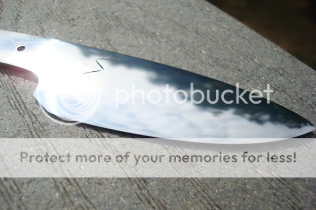

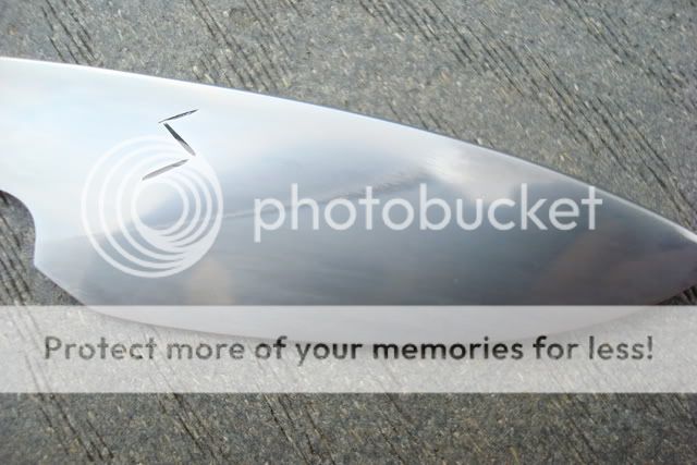

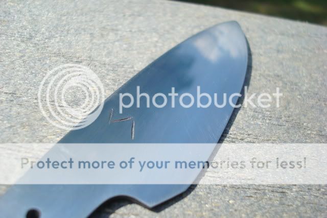

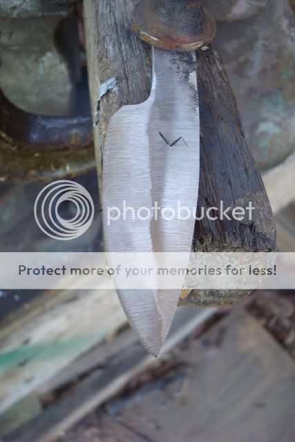

Getting my Hamon on!

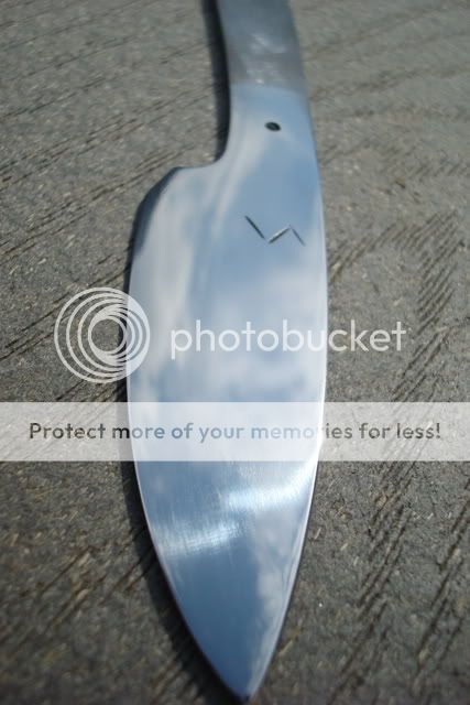

First, I polished it up to 1000 grit. Going through 120, 220, 320, 400, 600, 800, 1000.
At 320 I started using oil while polishing.
Coated with a nice slurry
At 1000 grit (it took wee bit longer than I just made it look like)
After buffing to mirror with my dremel and some green buffing compound

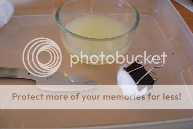

My etching set-up. Plastic tray, hot lemon juice, knife, and cotton ball in a little clip. (knife has been washed, wiped with acetone, and then wiped with acetone again).
After rubbing with hot lemon juice for 15 minutes, oxides not removed.
Oxides removed, first etch.
Second etch, oxides removed.

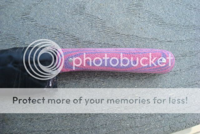

getting a handle on things
Prepping tand and scales -
Divots drilled in the tang and scales

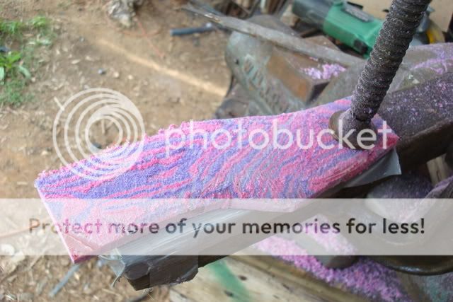

Clamps, epoxy, knife, scales, and q-tip for acetone
clamped

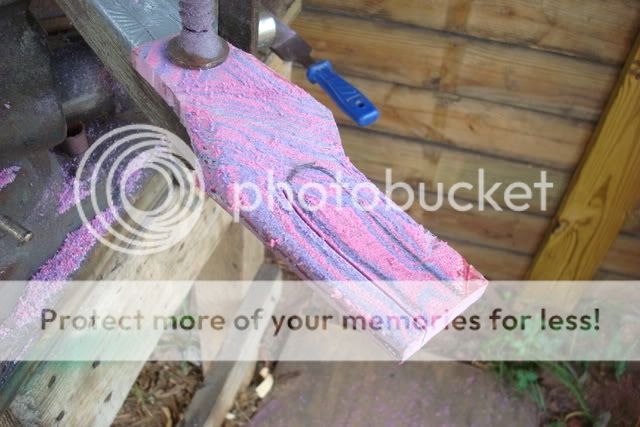

pre-shaping
Shaping
Handle shaped but not finished. Still need to finish sand, and then do the superglue coat.
